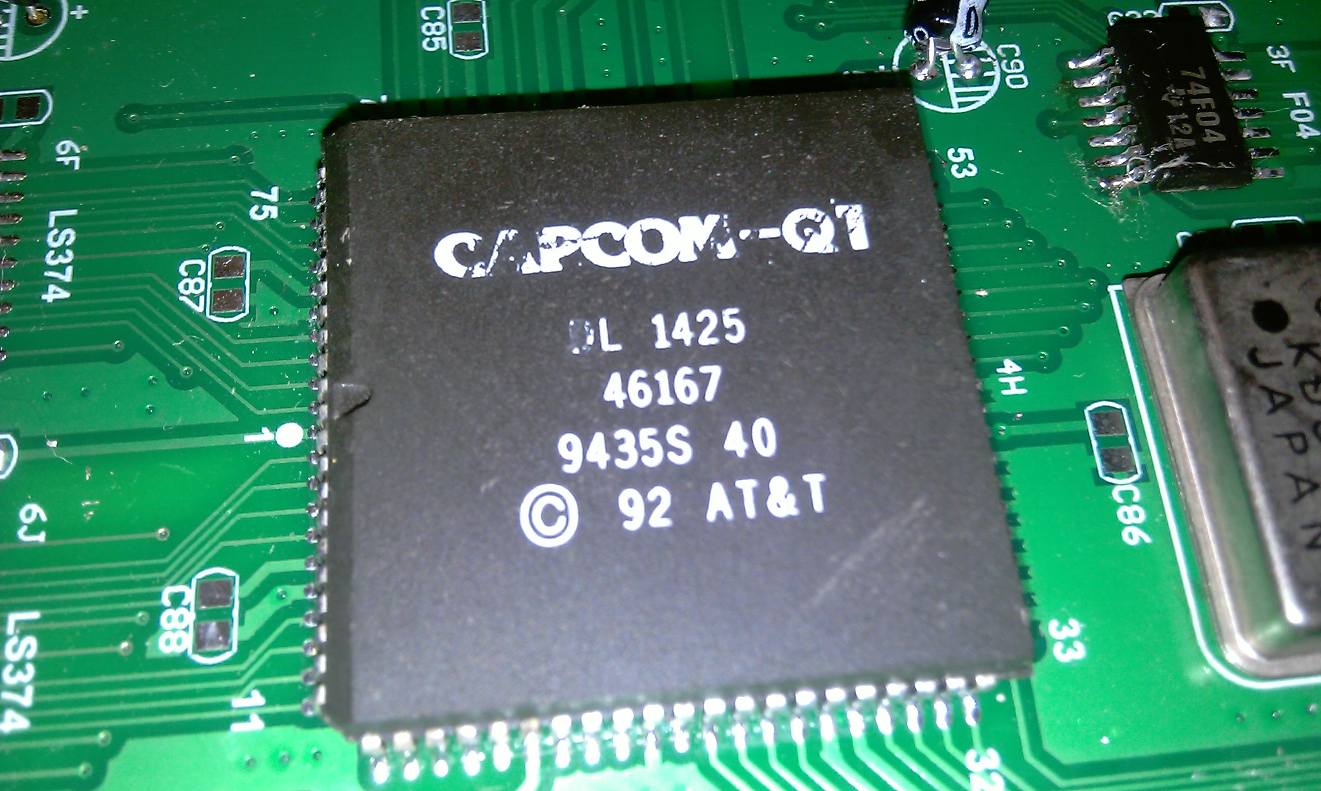

Worse than that though, he's literally destroyed Q boards to strip the parts (also CPS2 A boards I'm guessing which also makes me angry) to create that monstrosity
I believe that q sound part is a bootleg also. Either that or it's gone through the usual 'china' process from a scrap board (see fake eproms thread)
The chip has been sanded and remarked or repainted. Or is a full clone It looks fishy as fuck.
Yes the Q sound chip is reprinted on top at least, the text scratched off with fingernail!!
The chip is not painted you can see the screwdriver scratch test underneath.

I'm surprised the Qsound board itself was bootlegged, that's a new one.
