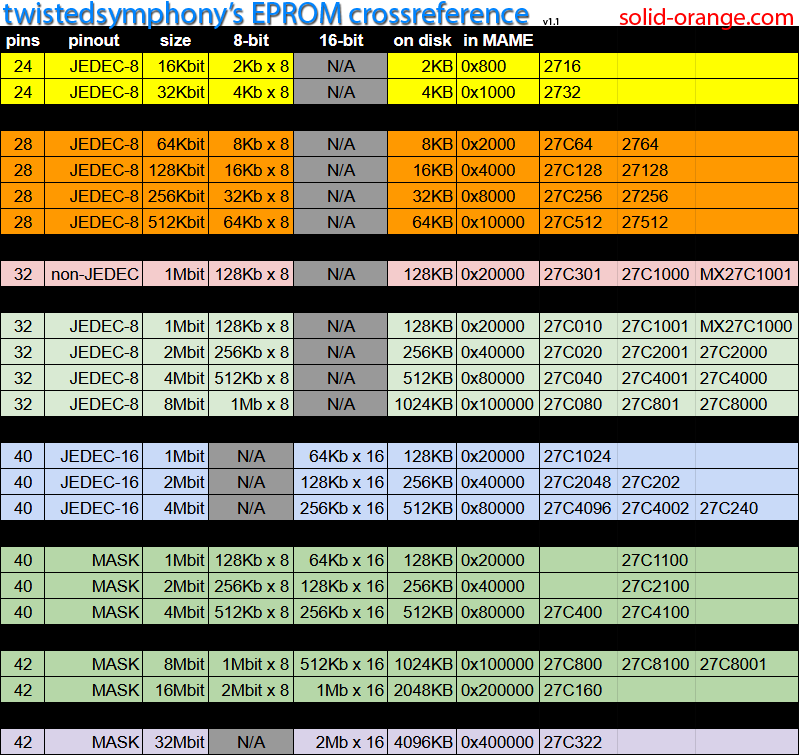

Just watching these now. In the first video around the 8:50 mark you're talking about hex ROM size. I have a handy cross-reference chart I made for myself. Literally I have this printed out and taped up next to my monitor makes it easy to determine file size vs size in mame vs what EPROM it likely uses.
I think I posted the original v1.0 of this chart before this is a v1.1 that made a few few adjustments and made the colors a little more printer friendly.
