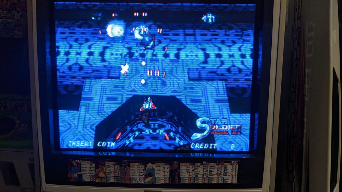

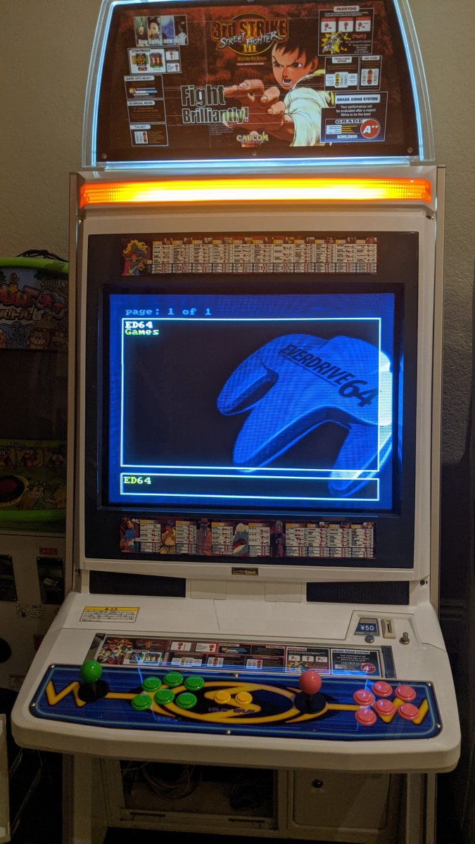

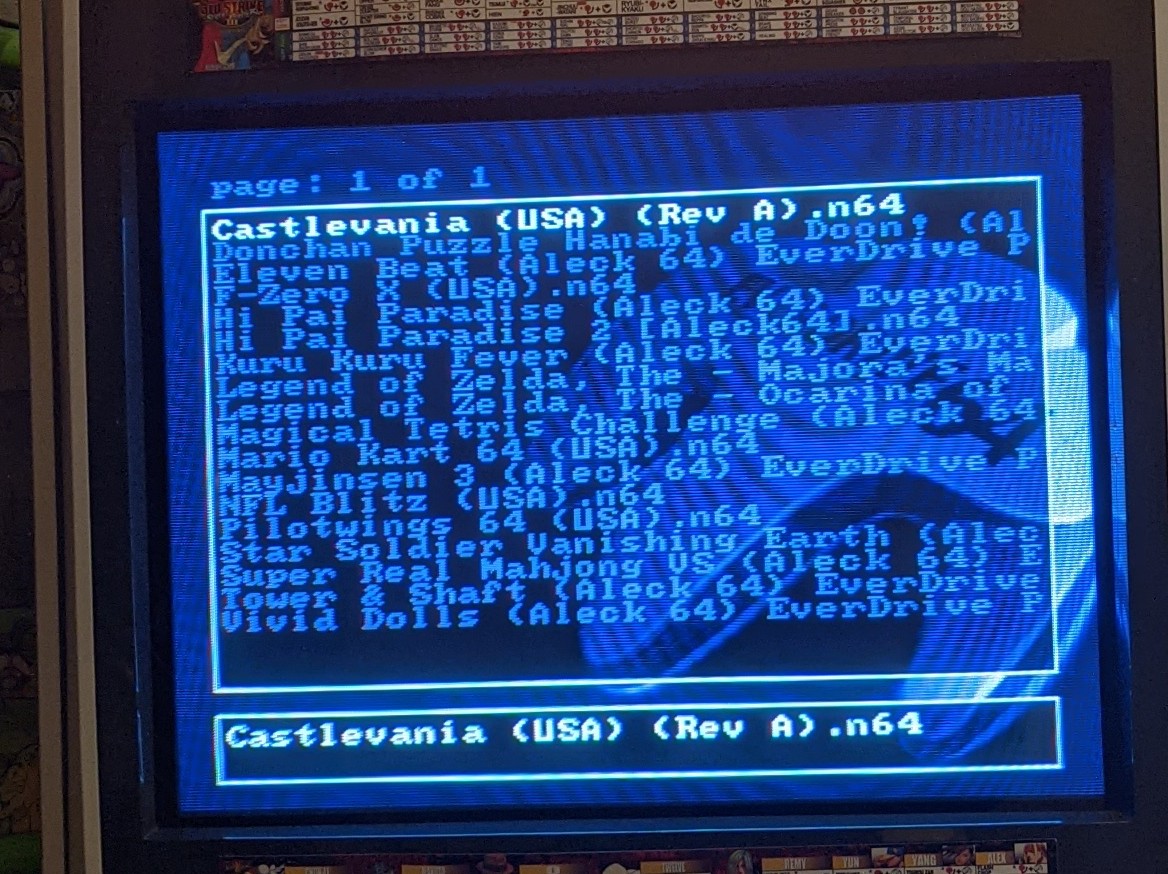

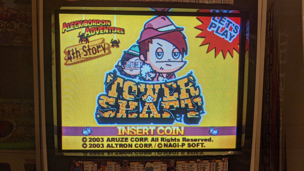

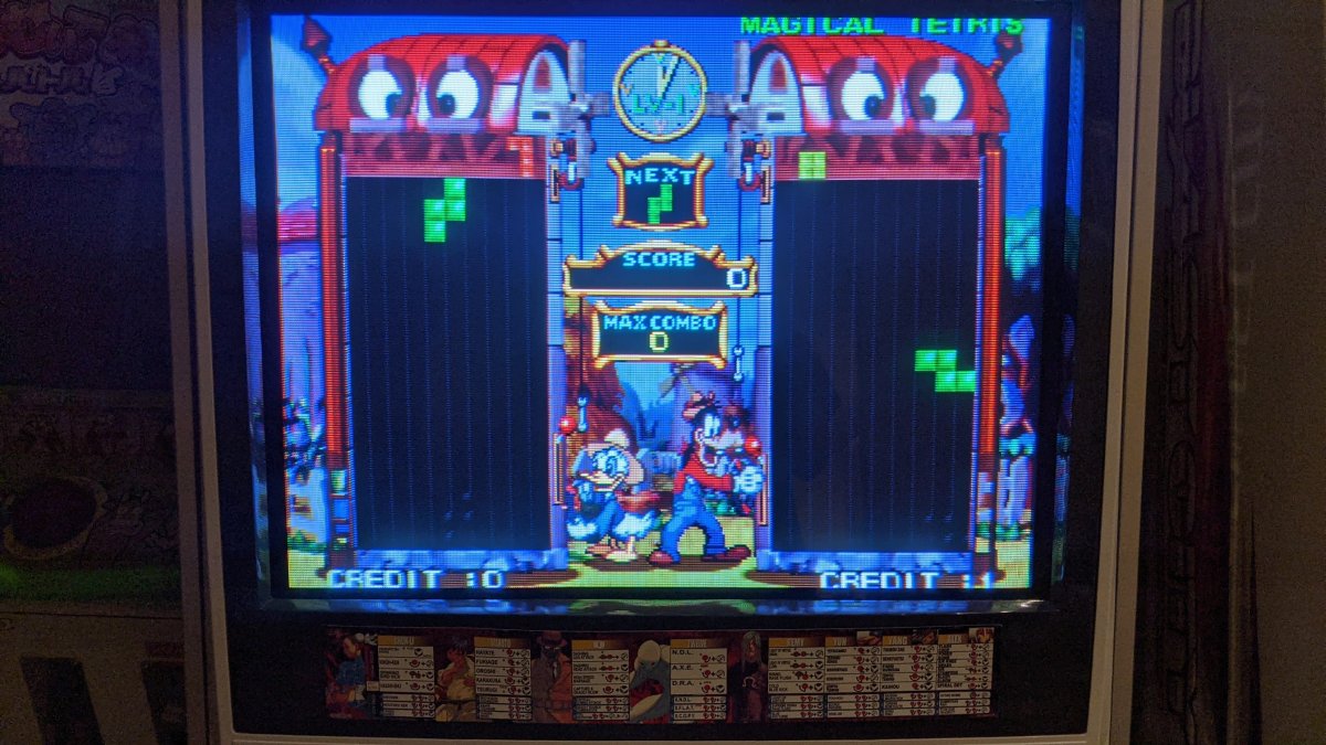

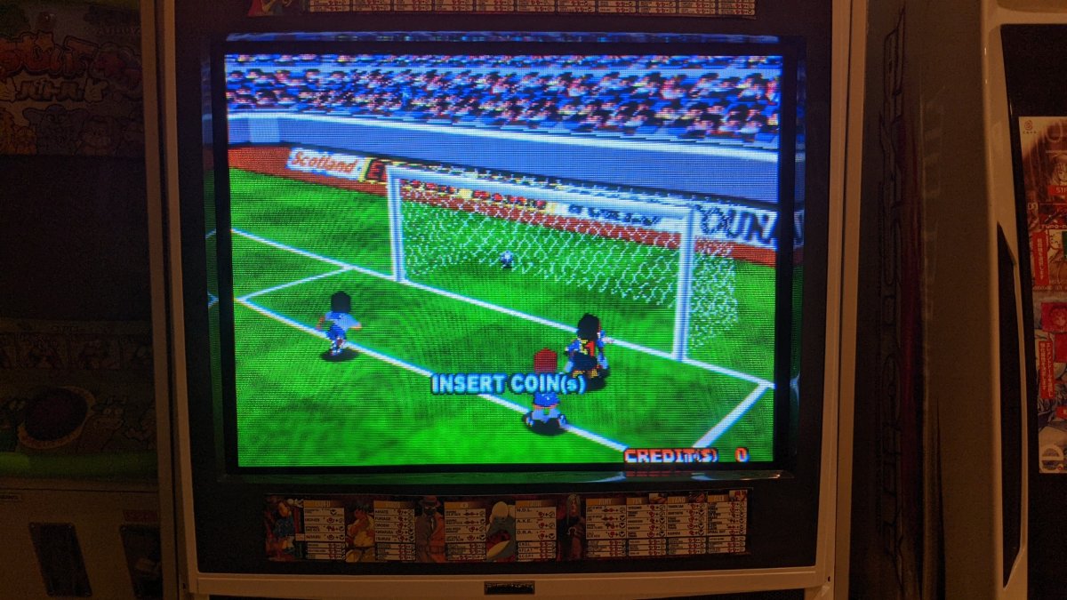

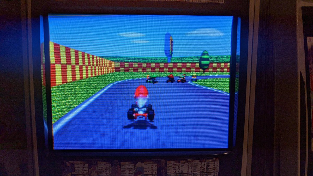

Hi All,
I set up my NNC cab with Aleck 64 panel and motherboard and tried both original cartridges and EverDrive for 64 X7. Thank you @brizzo for making this N64 adapter.
For original cartridge, most of time I couldn't get it to boot up but the control panel worked well. I just needed to switch between 3D Analog or Digital joystick for some games to work properly.
For EverDrive, have no problem booting it up. I only had 1st time not booting up. I did have problem with the control panel when I connected for 2 players. The controls won't work so I can't select any games. But no problem when I only connected 1 player. For buttons, not all games allow you to remap buttons, it would be better if I can remap buttons for all games.
I noticed the picture quality of Aleck 64 games are better compared to N64 games. But some N64 games have nice picture quality as well.
Here are some pictures of the cab loading with Aleck 64 & N64 games using EverDrive:

Everdrive 64 X5 probably will work but I bought x7 because it's out of stock at krikzz.com. I've never used Everdrive 64 before, I have to learn more about it. I'm not sure why it has problem with Aleck 64 panel if I connect 2 players.
