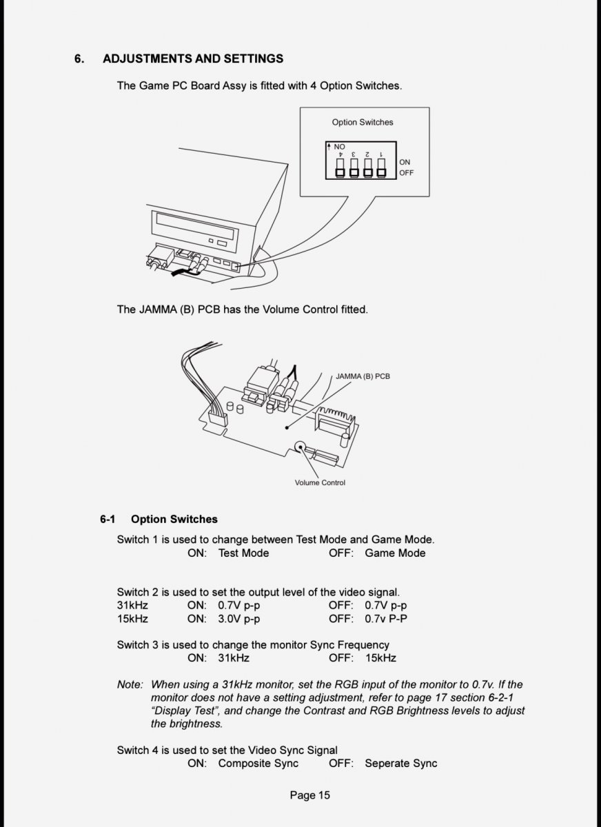

doesnt one of the DIP switches adjust the brightness (or more likely voltage)? I seem to remember having a note for one of mine where I said if the display was dim to flip a DIP switch.

I think it’s dip switch #2 that does that. It’s for RGB voltage out put level for 15khz or 31khz. Same thing for the 256.

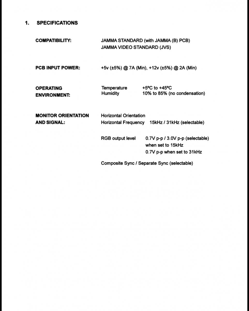

Yes, switch 2. The default is 0.7v P-P and turning the switch on bumps it up to 7.0v P-P. It does nothing on 31khz (according to the manual). But the manual also has warnings about setting it to 3.0V on 31khz, so there may be some misinformation there.
Will do some reading as to what that means... not sure what effect, good or bad, that toggle will do. And thanks @Franco23444 re: the flickering LED. I'm trying to use this in a multi-cabinet running on a MVS power supply. Will check the 5v, was good last time I poked at it. Worse case, I use the Naomi power supply.
I don’t think the RGB out put voltage really matters unless your monitor is really sensitive. All it seems to to is change the brightness levels and the settings change in the test menu for the contrast and brightness. The Naomi power supply will work perfectly.

Looks like my 5v is at 4.97... Hard to adjust it perfectly on these old power supplies (rebuilt and recapped, but still an old design). And it shifts a little depending on what board I've switched to (think the circuit differences pulls the voltage down a little). Not sure I can realistically get it better than it is. Will try the Naomi harness later today (pity as I like the idea of using the Namco IO board).

Using the Naomi JVS to Capcom board, and yes it seems to be working (not tested it much). Powering the Namco via 12v pico ATX to JVS to Namco series of adapters... Case in point on my earlier comment re: 5v adjustment. When powering the Naomi IO board I see 5.1v, so the Namco board was dropping the voltage by ~0.13v.

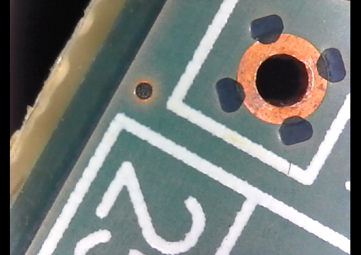

OK... so looks like I do at least have pads for the jumper.

Any idea where they trace to?

I’m not sure where they go. You may need to scrape off the protective layer on that pad and see if any copper gets exposed. Sony likes to cover them up and from working on other Sony related products, those pads should have copper on them.

Yeah, they don't currently want to take solder. Have some fiberglass pens around here someplace I can try to expose the copper with.

So soldered some leads and shorted it, but still boots into 256 mode (2x speed). Didn't really expect it to work as it is setup to run in 256 mode without a jumper, so no way to take it off 256 mode. Guessing that somewhere there is a short that would need to be broken to get the pads to operate, assuming they are even connected to anything. Also can't be 100% sure I'm making proper contact. Would need to figure out where the pads should lead to (get mild continuity from all pads to each other and ground). Will poke around and see if there's a schematic, but this may be a dead end.

That’s the issue, the super system 256 has a different bios compared to a normal 256. So that means that the bios won’t respond to the jumper, I guess.
