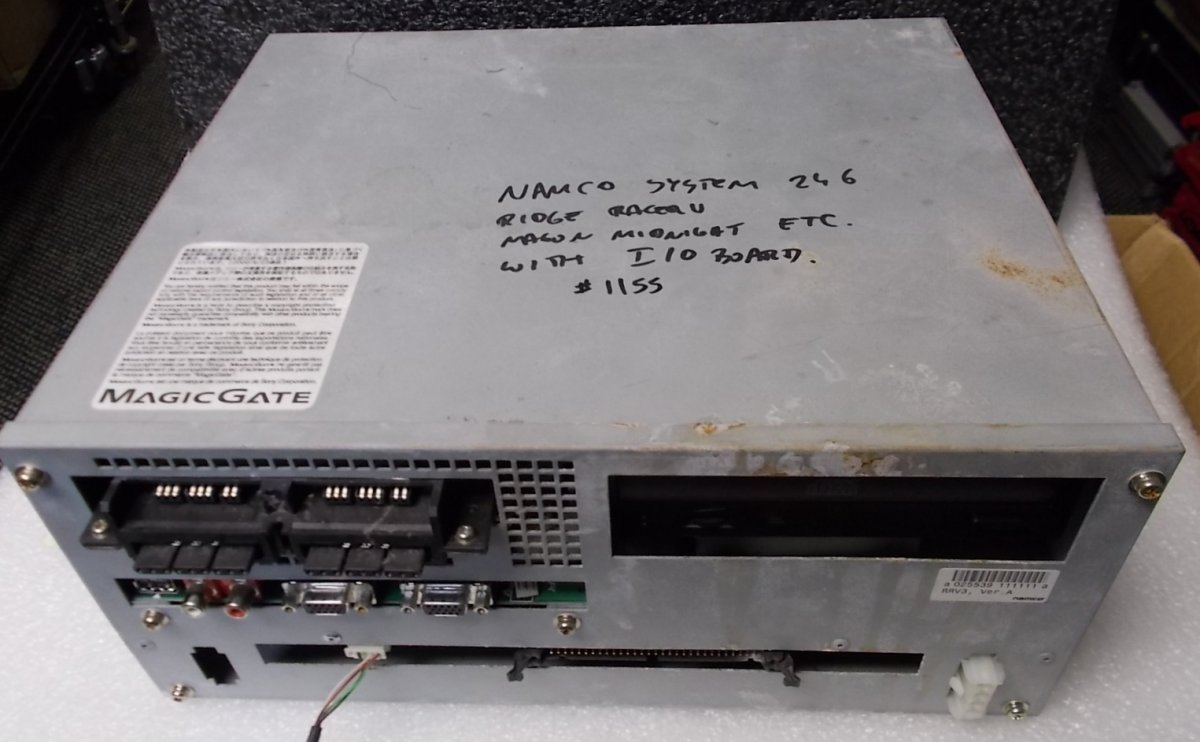

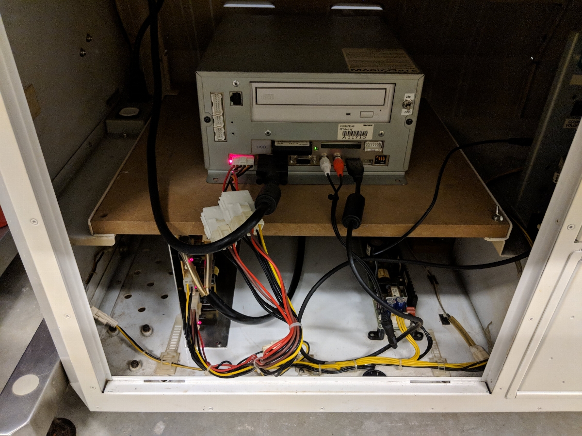

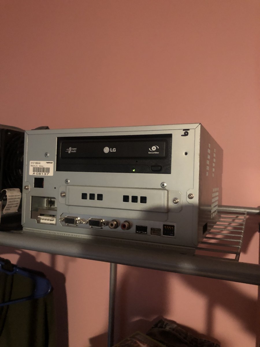

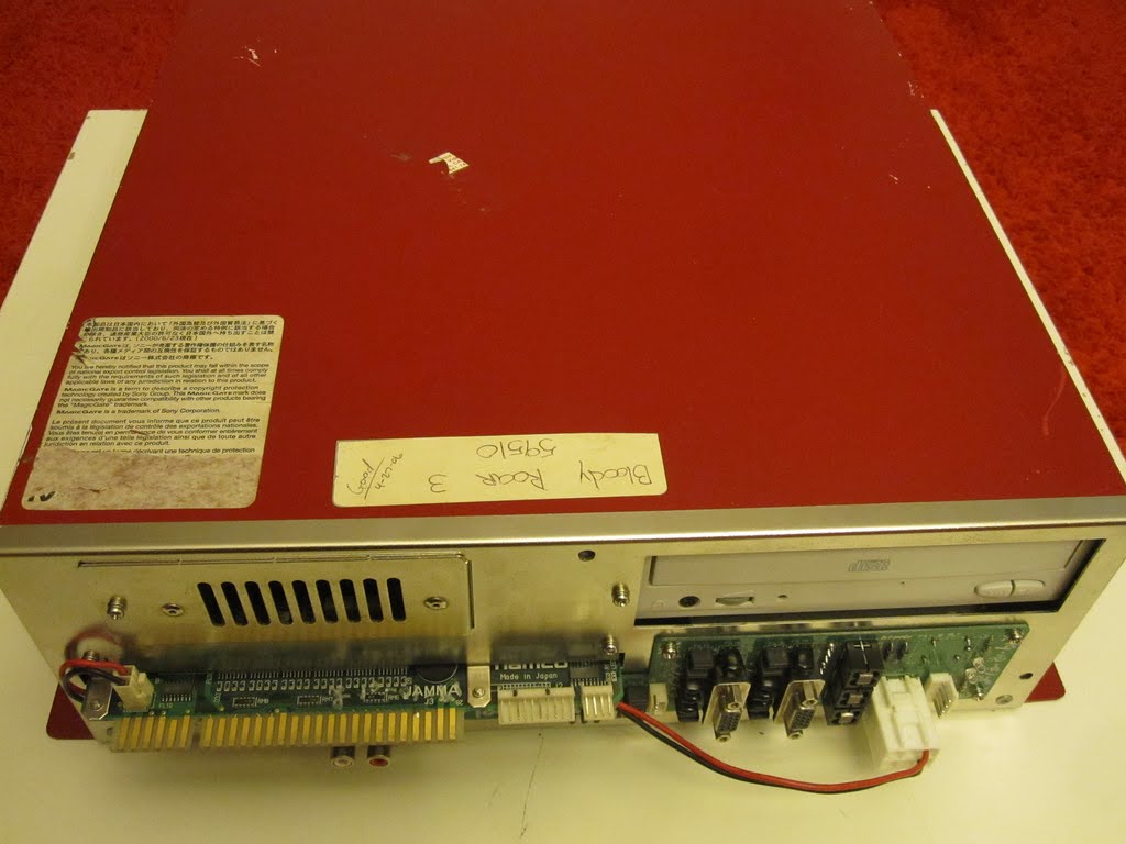

There is no such thing as a 256 (B). It’s either a regular 256 or what you have, which is a super 256. As for the Namco system 246, there’s the 246 (A/Driving) which is the first revision and its huge, the 246 (B), which is the most common and the most universal one, and 246 C which is the last revision of the 246, it’s looks like a 256, and it’s the most durable.
I provided some photos of the Namco system 246 revisions:
The first two are the Namco system 246 driving pcb.
The second is a Namco system 246 (A) board.
The third is the Namco system 246 (B) board.
And the last is a Namco system 246 (C) board.
