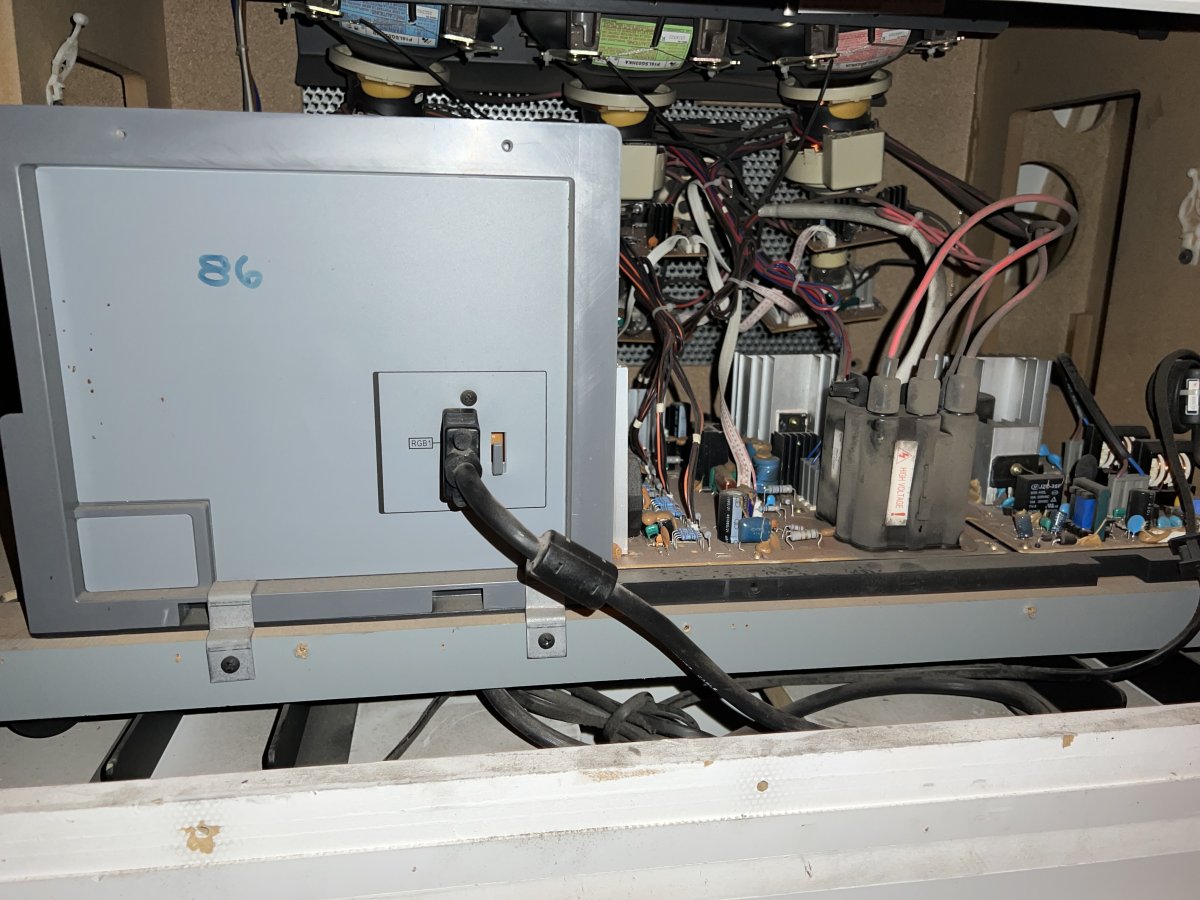

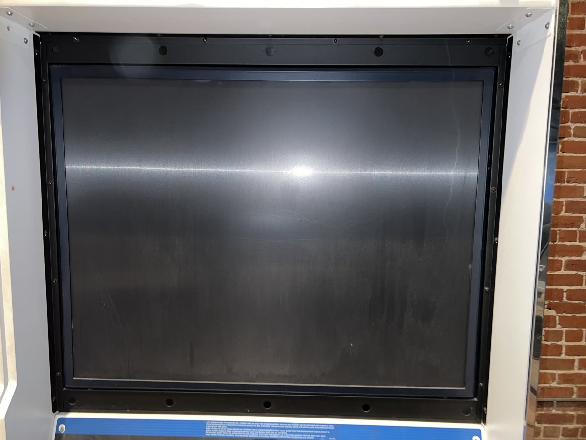

I have a quick question I haven’t been able to find an answer to so I was hoping you might be able to help me. I have a Time Crisis 4 deluxe and I want to replace the projectors with an LCD screen but when I plug in the VGA from the game to an LCD no picture pops up. I was wondering if you know why that is and what I can do to fix it? Your help is much appreciated thank you.

What dip switch settings are you using? Just because it's outputting via a HD15 connector doesn't mean it's "VGA". It may be running CGA. Also, which projector/LCD? Different models will have different limitations as to what sort of video input they can support.

Would the dip switch make the difference? They’re all set to off right now and there are 4 dip switches. Also, there are sensors surrounding the screen so I believe I can switch out the screen for an lcd tv. I’ve seen other TC4 deluxe like that. I’ve tried both a computer monitor and lcd tv with vga connections but no image pops up. The projector does say RGB and not VGA but I always assumed it was the same thing? I’m guessing now that might not be the case. I’ve attached some pictures. Thanks for your help.
@Bluechalk little hard to see, but it looks like switch 3 is in the off position in the first picture. This would set it to 15khz CGA. Setting it to ON will change the output to VGA 31khz. 2 & 4 should also be on, to adjust the output voltage and sync type.
  • 1 off=Game mode, on=test mode
  • 2 off=3v video output, on=0.7v video output
  • 3 off=15khz video, on=31khz video
  • 4 off=composite sync, on=h/v sync
For use with a VGA (31k) monitor, use off,on,on,on
And you're right, if you can get the video to output to a supported video mode you can swap in a LCD since you have the gun sensors etc (assuming you have the controller board, which I think you do as I see the cable for it).

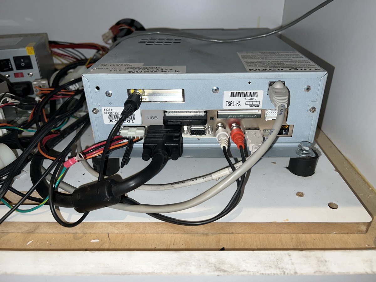

I’ve attached a picture of the controller with all the various inputs. I’m not sure what I need to run it on.

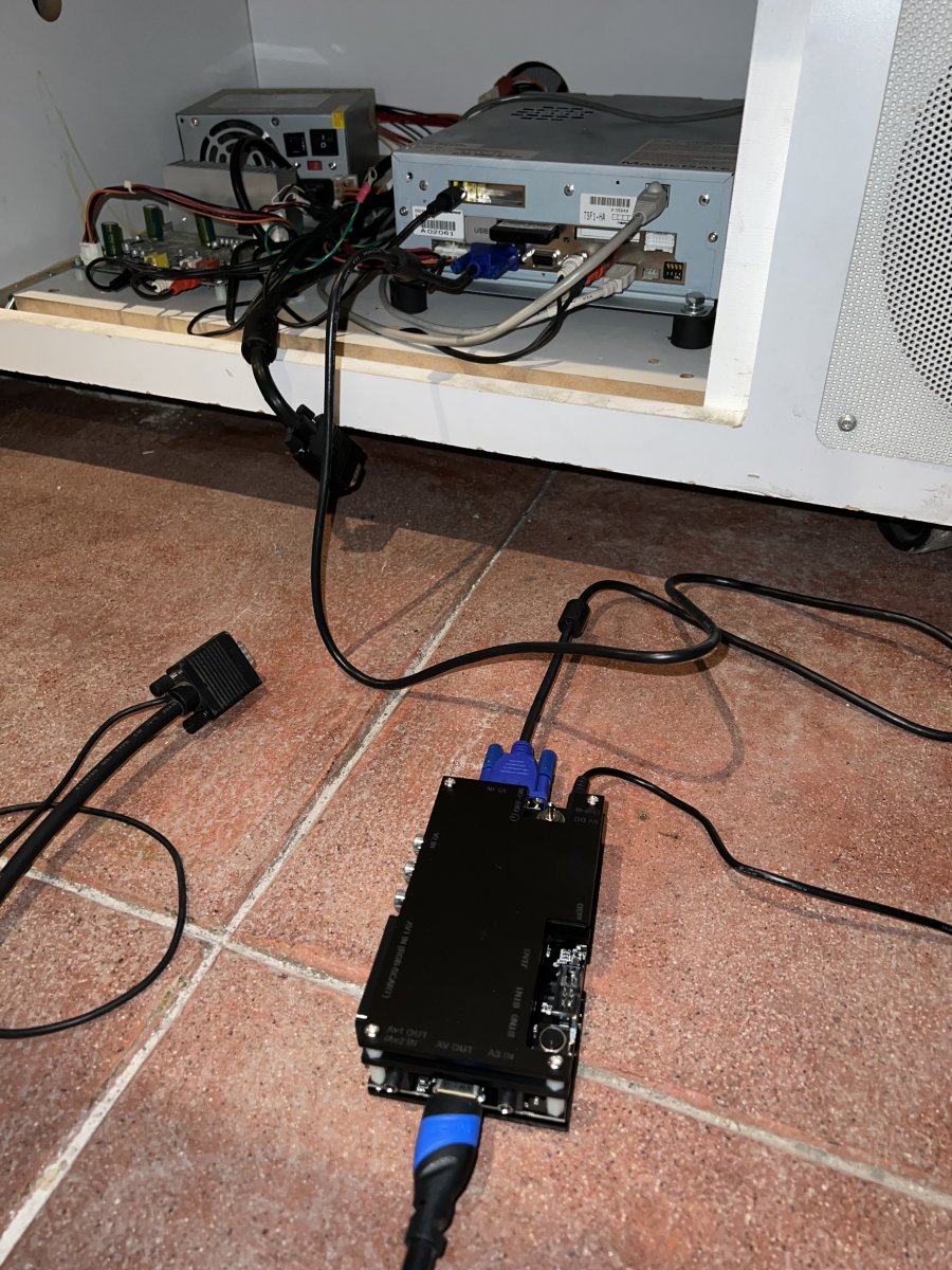

This is also how I have it connected. I believe it’s AV3 but no picture is showing up. Can it be the lcd tv I’m using?

The OSSC is very finicky when trying to use the AV3 vga port. It mostly tries to look for a 240p signal but the game runs in 480i. What I do is press the RGB button multiple times until the OSSC screen flickers between 240p to 525i. Then press line multi mode then press #1 and video should appear. It’s extremely finicky, I know this will sound annoying but I would recommend you get the cheap ega to vga (or blue HDMI variant) converter boards for convenience. You can still use the OSSC if you would like to capture your gameplays in high resolution so it’s not a total waste of money. Just one huge thing to note, unless your display is VA panel or a tv, the OSSC doesn’t play nice with IPS or TFT monitors, in other words, it causes screen burn. Something the cheap boards don’t do.

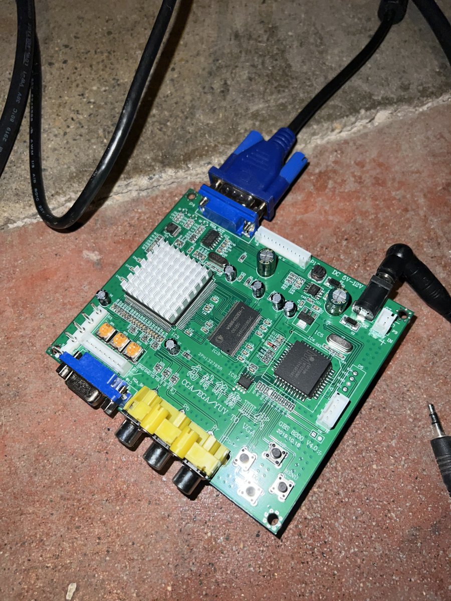

Okay, I tried pressing the rgb button multiple times but the screen never flickered to 480i I’m a bit confused as to what to do still. I also have tried a ega to vga board but the only picture that shows up is discolored and in a 4:3 aspects ratio. However, I have seen videos of people playing TC4 in widescreen so I’m not sure why I can’t reproduce that. Do I have to mod the ega to vga board as stated in the comments above?

You have to press the RGB button multiple times but it can be quite frustrating. To use the EGA to VGA converter board properly (without modifications), you need to change around the clamp settings, I forgot the exact values they need to be put in but I’ll update you when I find them. For the widescreen look, your display has to be set to 16:9 mode, in your displays menu, there should be something labeled “aspect ratio” or something similar to that, originally the arcade version of the game was made for 4:3 displays but the PlayStation 3 version is in 16:9.

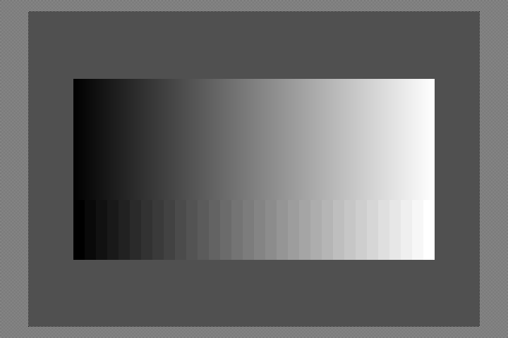

When you say no picture, are you getting the OSSC test bars? Should look like this...
If you're not getting that, then there is an issue with the signal to the LCD (what LCD screen are you using?).
Then on the remote, to select the RGBs input it's button 3 (1 is the SCART input and 2 is the YpBpr).
If you get the grey test bars, you can press the menu key to check the current input and output configuration. Mine has worked fairly reliably, but I did have to twiddle with the settings a bit. Now I switch it out between inputs for my superguns, consoles, etc to run on my Vewlix.
That is indeed the aforementioned GBS-8200. It will work out of the box (not well, but OK). There is an open source project that makes it MUCH better if you're up for some light soldering and programming an arduino.

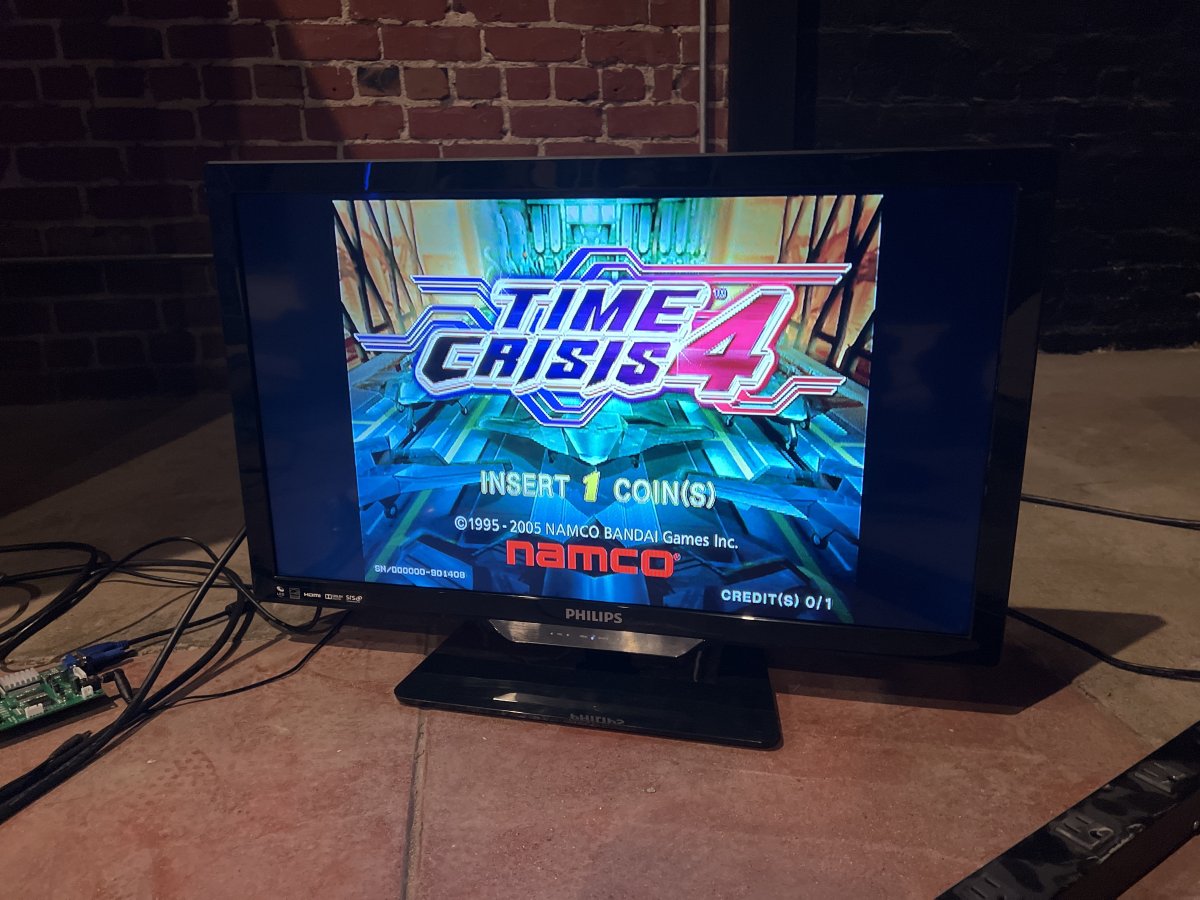

Thanks for your help! I finally got it to work with the ossc. Would you happen to know if there’s a way to make the image widescreen?
