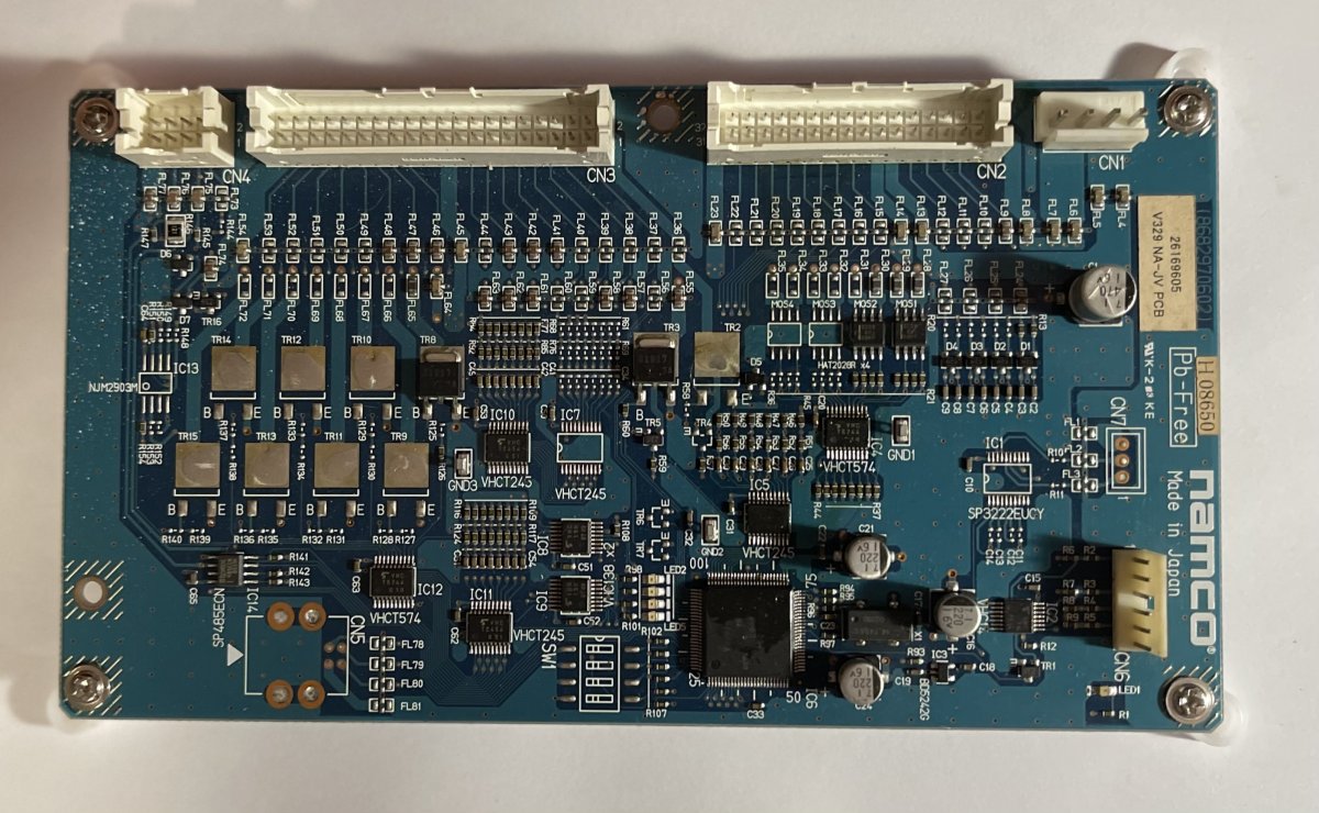

Namco V329 NA-JV I/O “Multipurpose” pcb (Time Crisis 4 variant)
This is the Time Crisis 4 (Namco System Super 256) variant of the NA-JV multipurpose I/O pcb.
Other variants exist that has the missing transistors soldered on. This PCB, just like the FCA PCB was used for Fighting,Driving,Touch screen, and IR sensor gun games.

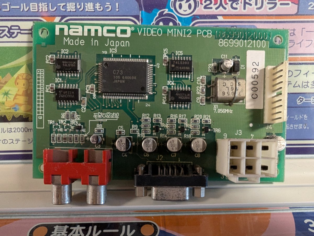

Interesting and sounds very plausible - for various stages of the assembly process perhaps. The cable from that V Mini output is still in my Cyberlead and I had it plugged incorrectly into the JVS Jamma adaptor kick harness output. I’m considering cutting the cable in half and terminating the cut ends with CPS 1/2 kick harnesses connectors - but didn’t want to if it could be important one day.

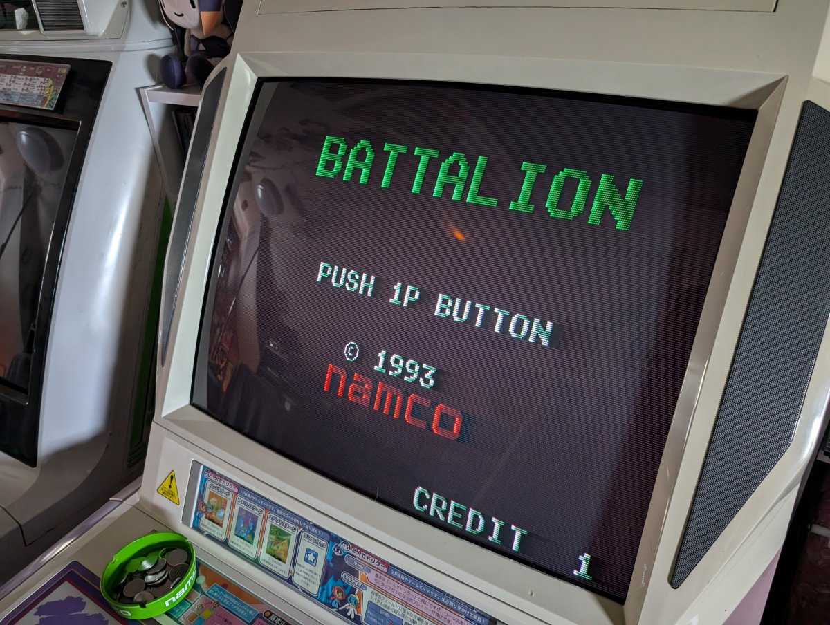

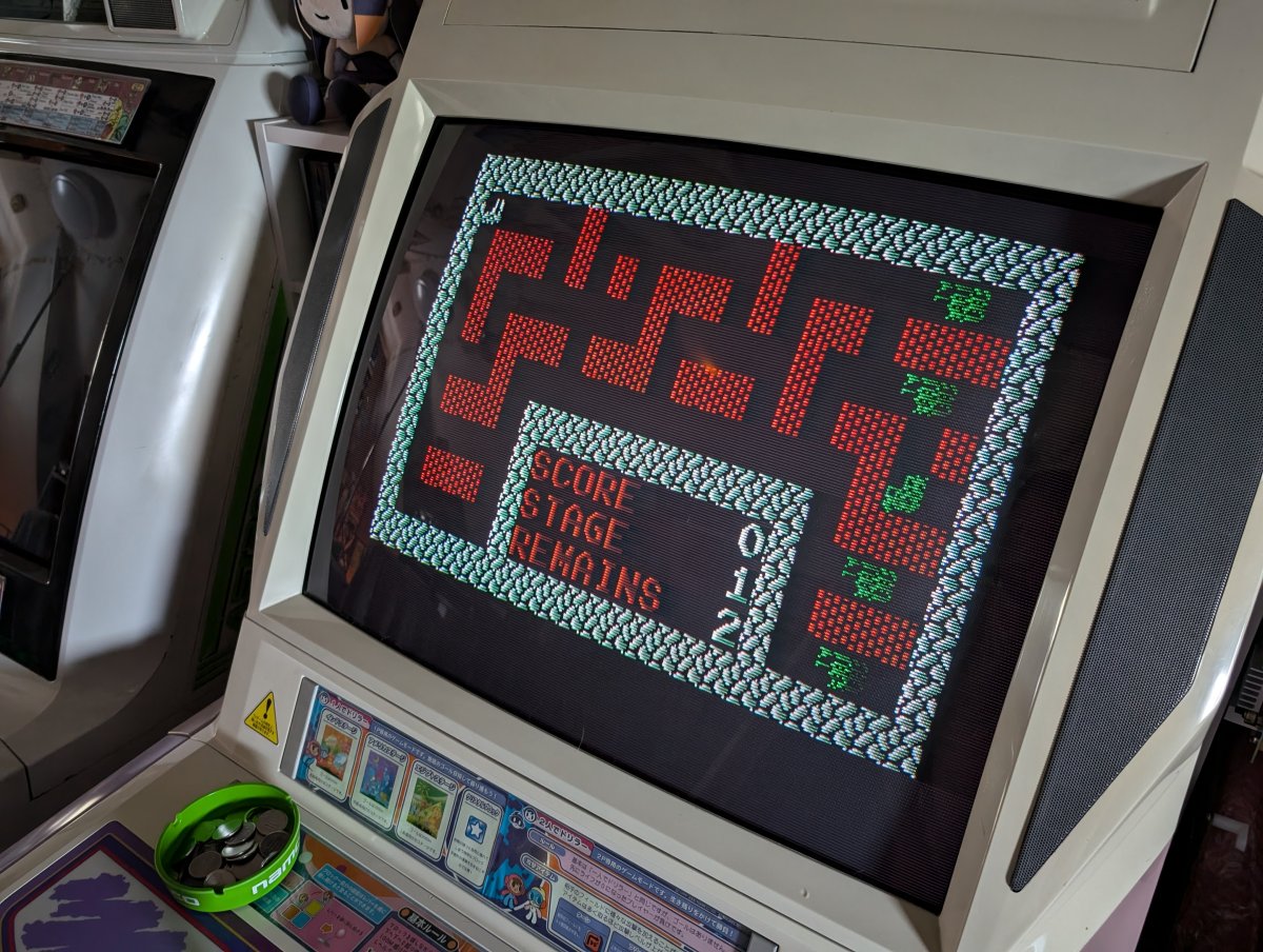

I found one of these and it is indeed a game, Battalion. It's a basic maze game but it does take credits, has a test menu, and should have music and sound.
The harness coming off the IO is for controls as it doesn't have a JVS port. I'm not sure if it's digital or serial, but I'm pretty sure it's just digital controls. It does nothing with the LED marquee.
Unfortunately audio doesn't work on mine. It looks like it's missing components. The caps could also be bad.
PXL_20240713_164550257.jpg PXL_20240713_164557802.jpg PXL_20240713_165034378.jpg PXL_20240713_165038616.jpg

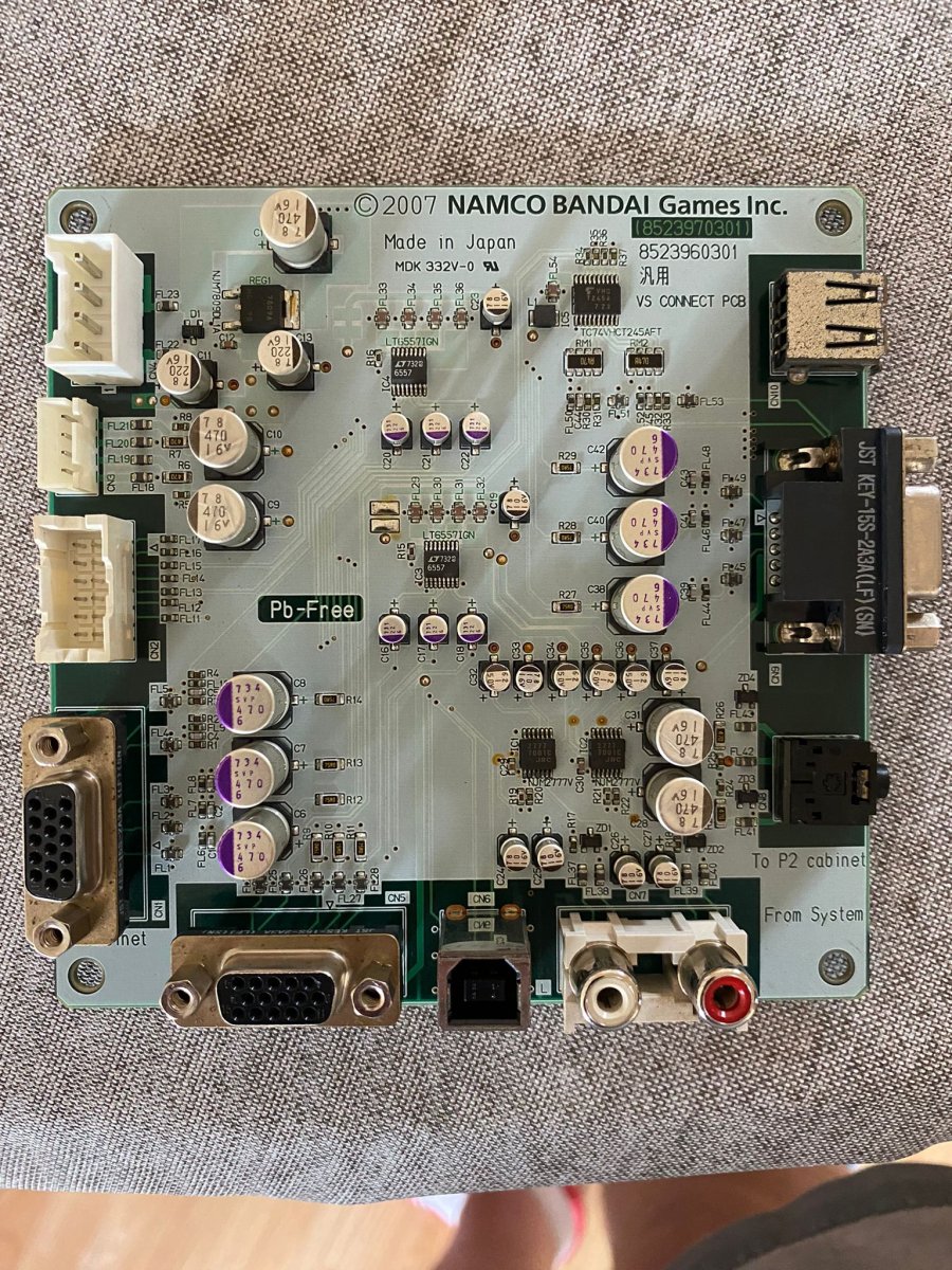

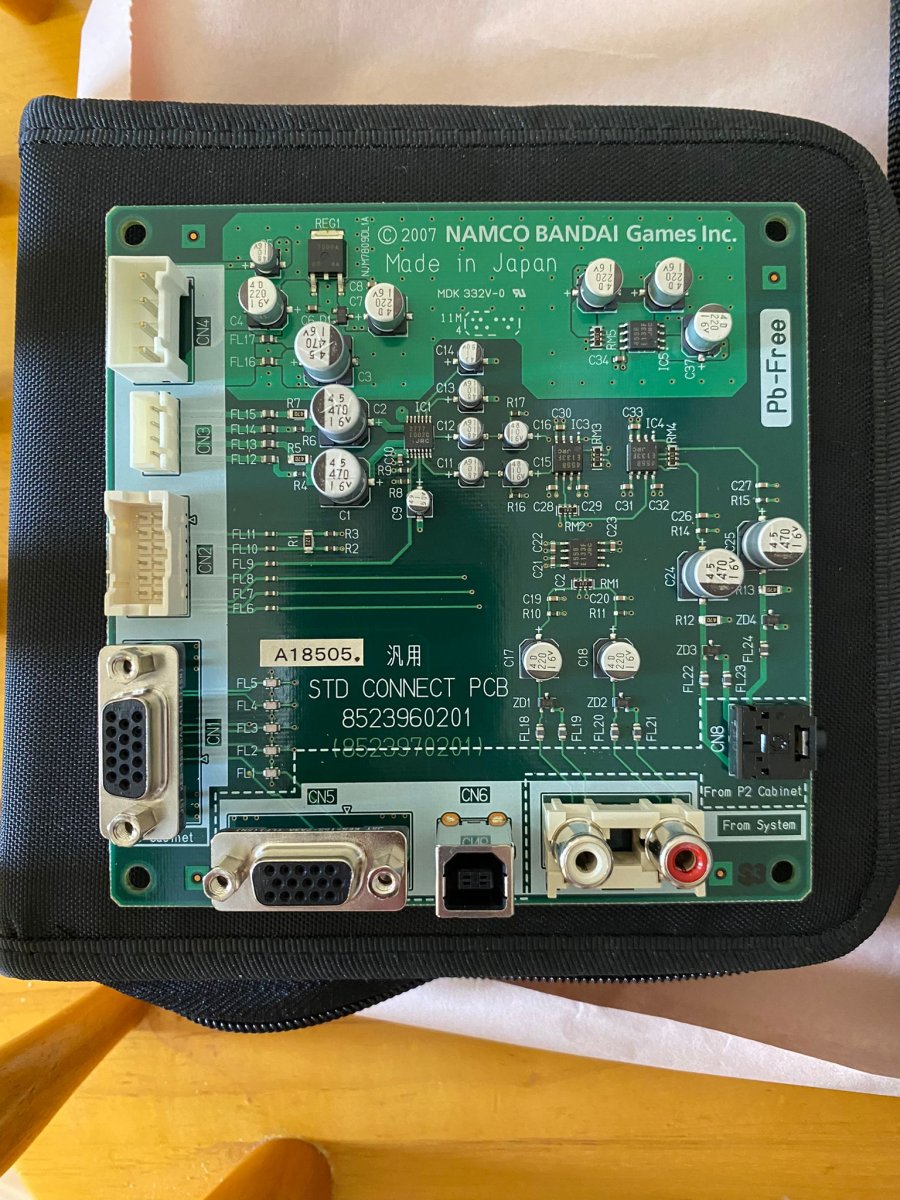

What are these for? I have couple of this in mint condition

Provided you have the normal najv2 io from the back and all the necessary cables that passes through, it's just a jvs pass through io at the end of the day.
If it's jvs, then yes, it should work
Actually I wont play with that, I need to get rid of this, any ideas what price I can ask for this?
They work for the older Tekken games that support JVS, I actually have the VS link pcb set up
the white one is used to pair two JVS boards together for separate VS setups (or pair play mode for Tag 1/2) and the other green version is the standard single player version.
Every noir cabinet has one or the other already. It would only have any value to someone with two or more cabinets that happens to have one missing or damaged. ~$40.

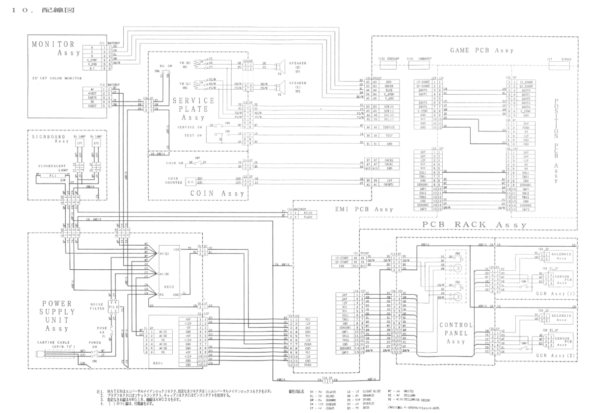

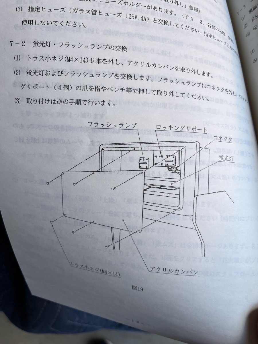

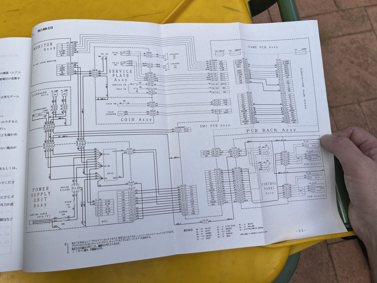

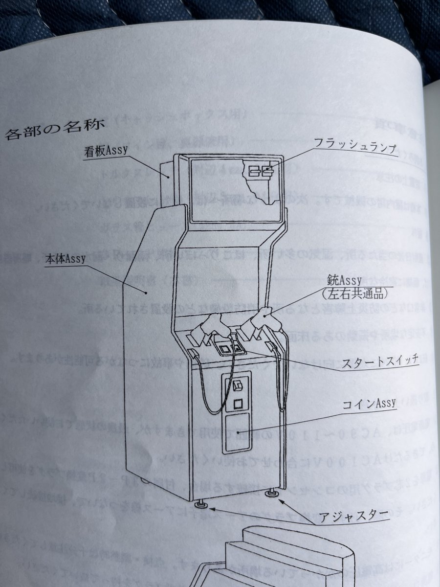

Taken from the Japanese Gun Bullet manual
Thanks, @DRAGONKZ! That scan is super helpful. The manual says that those two boards in the marquee area are florescent "flash lamps". They connect to pin 1 of J104, but I can't make out the description of that pin in the schematic. Pin 2 of J104 connects to the hot AC line. Presumably some action causes RL1 to engage, activating the flash lamps. Nothing I see in the manual shots above describe what causes them to activate.
I’ll read through the rest of the manual with a translator app and see if any page mentions their function.
My cabinet is missing this whole “Xe lamp” assembly, but I believe it’s like what you said, some in game action causes it to light up.

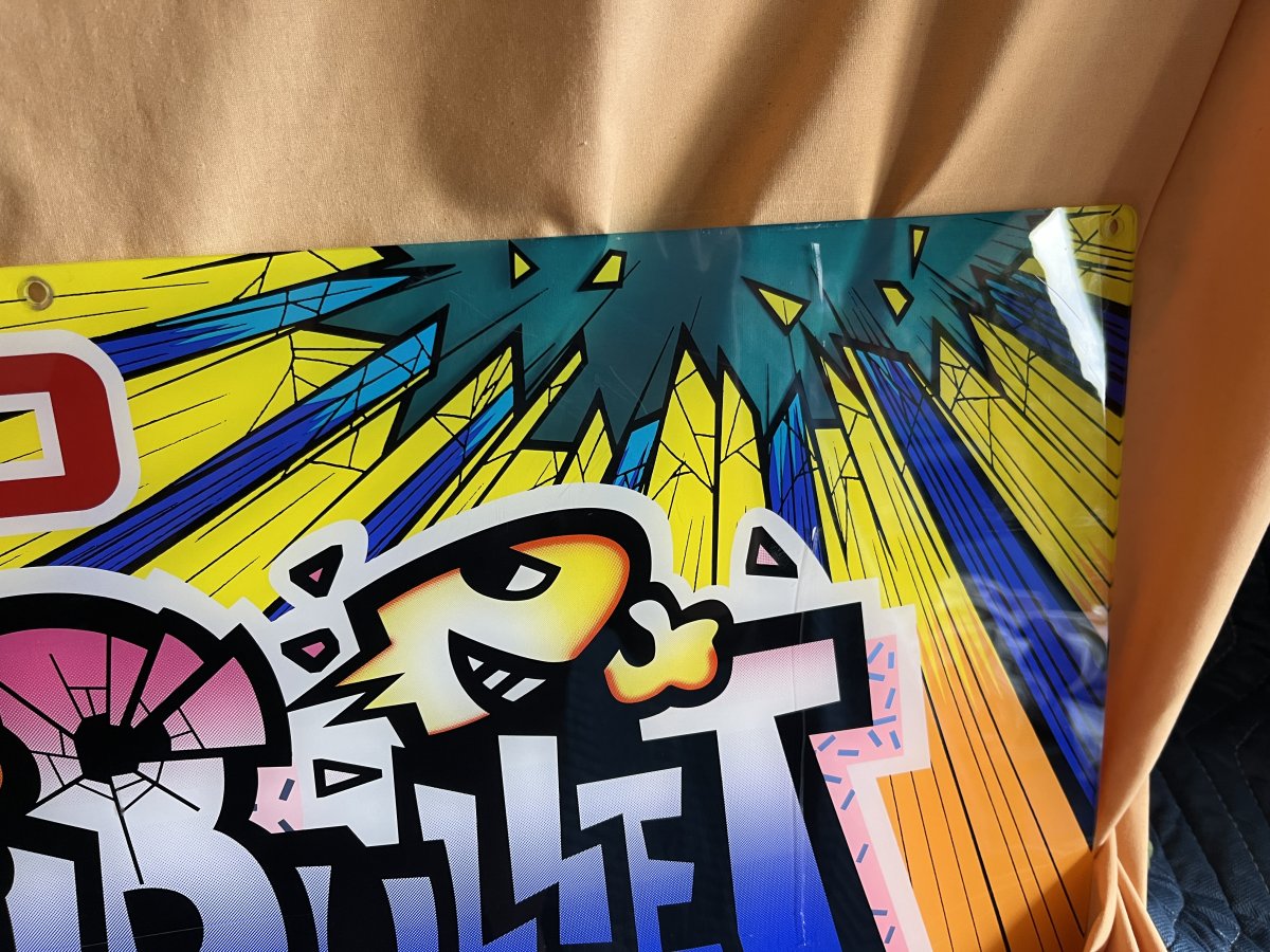

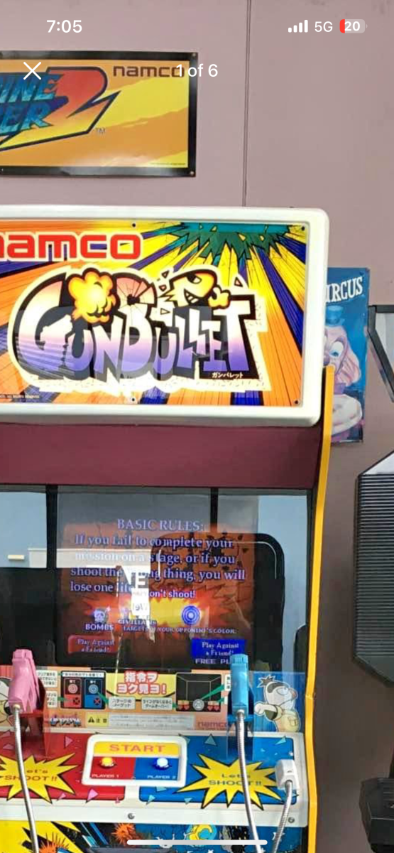

The Japanese “Gun Bullet” marquees are more transparent in the blue area where these lights would go, so the lights probably give a “breaking through the marquee” vibe
You can actually see through to inside the marquee area when the normal marquee light is off, as seen below
