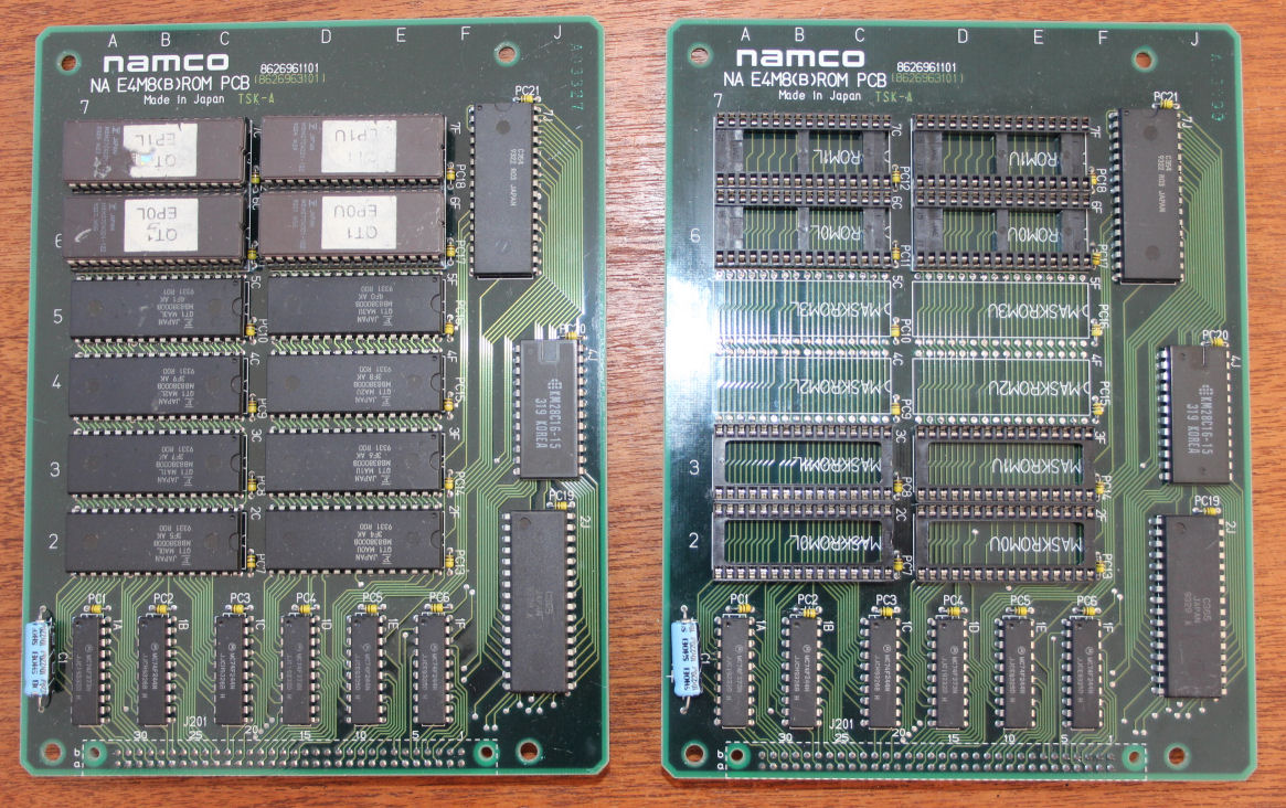

I tried to convert Nettou! Gekitou! Quiztou (NA-2 with NA E4M8(B)ROM PCB long board with C365 Keycus) to Fighter and attacker but it doesn't work... The game is stuck on the self test (ram, palette...). I tried with cosmo gang and i'v got the same issue...
Do you think your hacked sets work on this rom board? (i tried 2 differents working Nettou! Gekitou! Quiztou rom boards with the same result)
Thanks! ^^
I don't have that keycus to test with, (i also don't have the tinkle pit original keycus to test either)
Cosmo gang should run with no keycus installed, make sure you have checked all your rom traces for damage.
Here are my 2 Nettou! Gekitou! Quiztou rom boards. Both are working fine with original Nettou! Gekitou! Quiztou rom set installed. Both are stuck in self test if i try your hacked rom sets (whatever the game i try, even cosmo gang).
If you want, i can send you a rom board if you want to study this keycus...
If you can desolder the keycus without damaging try without that.
I can swap for another board or swap keycus' if you like, my guess is this keycus has an extra trick like point blank / tinkle pit do.
@twistedsymphony reported issues with a quiz board before, is it the same keycus? He got something running in the end, not sure what!
I don't remember exactly but believe I was using Netto Geku to try to make an Emereldia and running into problems. I think I solved it by swapping out the KeyCus from another donor PCB.
You're right Hammy! I just desoldered the key-cus and now cosmo gang play fine! I can also start F/A , add credits but it resets when start button is pushed (i guess it's because of the missing key-cus).
Excellent! If you want to swap the keycus with me for another one that works with the patches, send a PM :)
