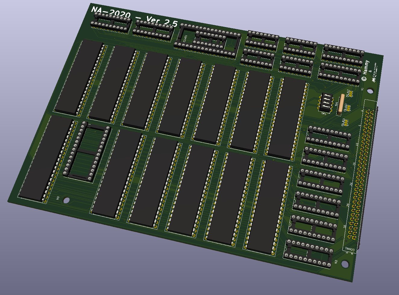

Ladies and gents. V1.3 is finished :)
Take orders soon for V2.5 (yes it's that more advanced)
Tweeted on my twitter :whistling:
yes I have one of the protos also, Hammy's been doing a lot of work adjusting the design.
So anyone that has a v1.3 will need to be cutting traces and installing patch wires. Not to mention it's a DIY assembly.
So yeah, v1.3 is only for someone patient who isn't afraid of doing PCB modifications themselves.
everyone else should wait for V2.5 I know I'm looking forward to that version myself :D
it's not a cheap connector
This is a board where cheap parts will just cause problems.
TTLS must be F' series, original/good 27c322's are getting hard to find...
Any loose connection will cause days of misery trying to track down.
I did think of a ribbon cable originally but it's not worth the glitches to save a couple of pence.

2.5 Is ready for the test run!
Improvements over 1.3:
Compact design only slightly bigger than original numan athletics rom board.
No errors (!)
4th unneeded jumper removed
Lower chip count
@caius system has been full throttle for more 1 week optimizing the track via's on this :)
I will order a small QTY of the new design for a final test, if it's thumbs up first time then we are good for the 'final run'
