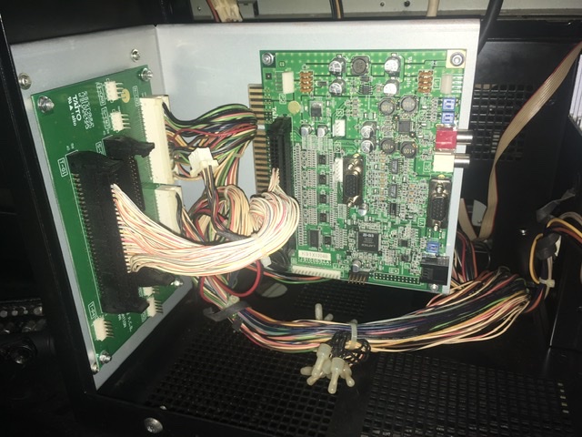

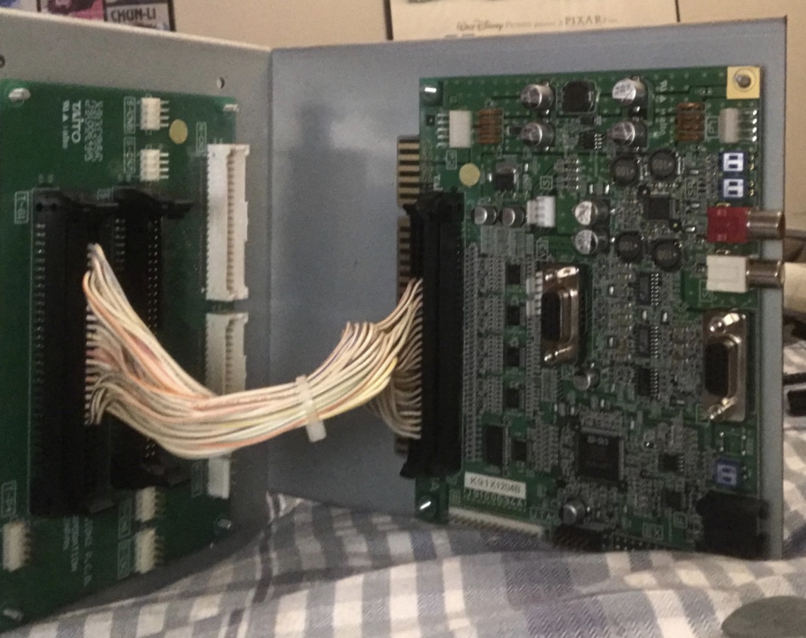

Well I like to keep you all on your toes so come across a new problem maybe someone can help me with, I’ve bought the original fast I/o pcb’s for the noir but not sure how it installs, I’ve fixed it in place and put the wires in place but the najv2 has an 8 pin plug at the top and I don’t have anywhere to plug it on the k91x1204b, also I can’t find a power cable to power the board so not sure what to do there? As usual any help much appreciated, cheers.

Nobody have any ideas or is everyone on holiday , main thing I need to know is how to get another power cable to the I/o board that I don’t seem to have, should be an orange and black 4 pin as in photo.

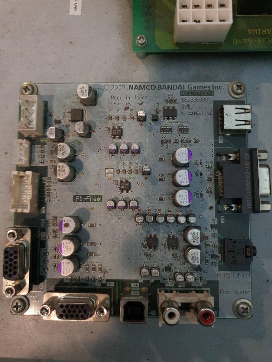

Regarding cn4, I believe that's what the usb pass through is.. It should go to the pcb at the bottom front to allow the linking.
You have have a normal one without the vga, 3.5mm and usb out
So I wonder if it’s not needed on the fast I/o which is why I can’t find anywhere to plug it in :huh:

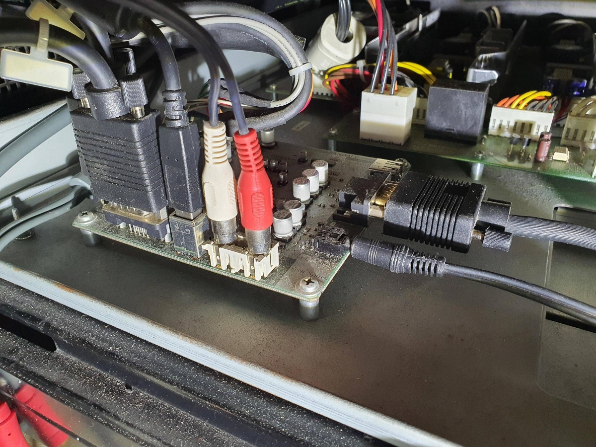

If you have the linking board that looks like this, it will make things much easier
It connects the NAVJ2 to it, the audio and the video
You then output to the second cab a USB cable, a 3.5mm stereo cable and a vga cable.
