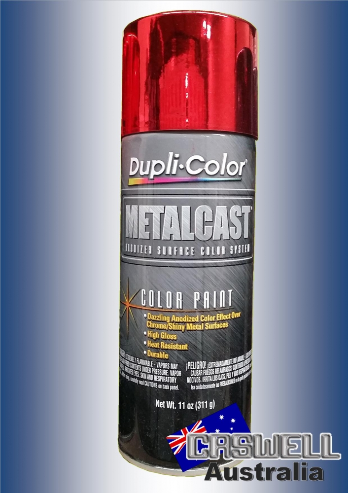

what is the type of metallic red color on the hubcaps, Candy metal , or Lucifer red Metal
Looks like it's Anodized Red or chrome gloss red vinyl wrap

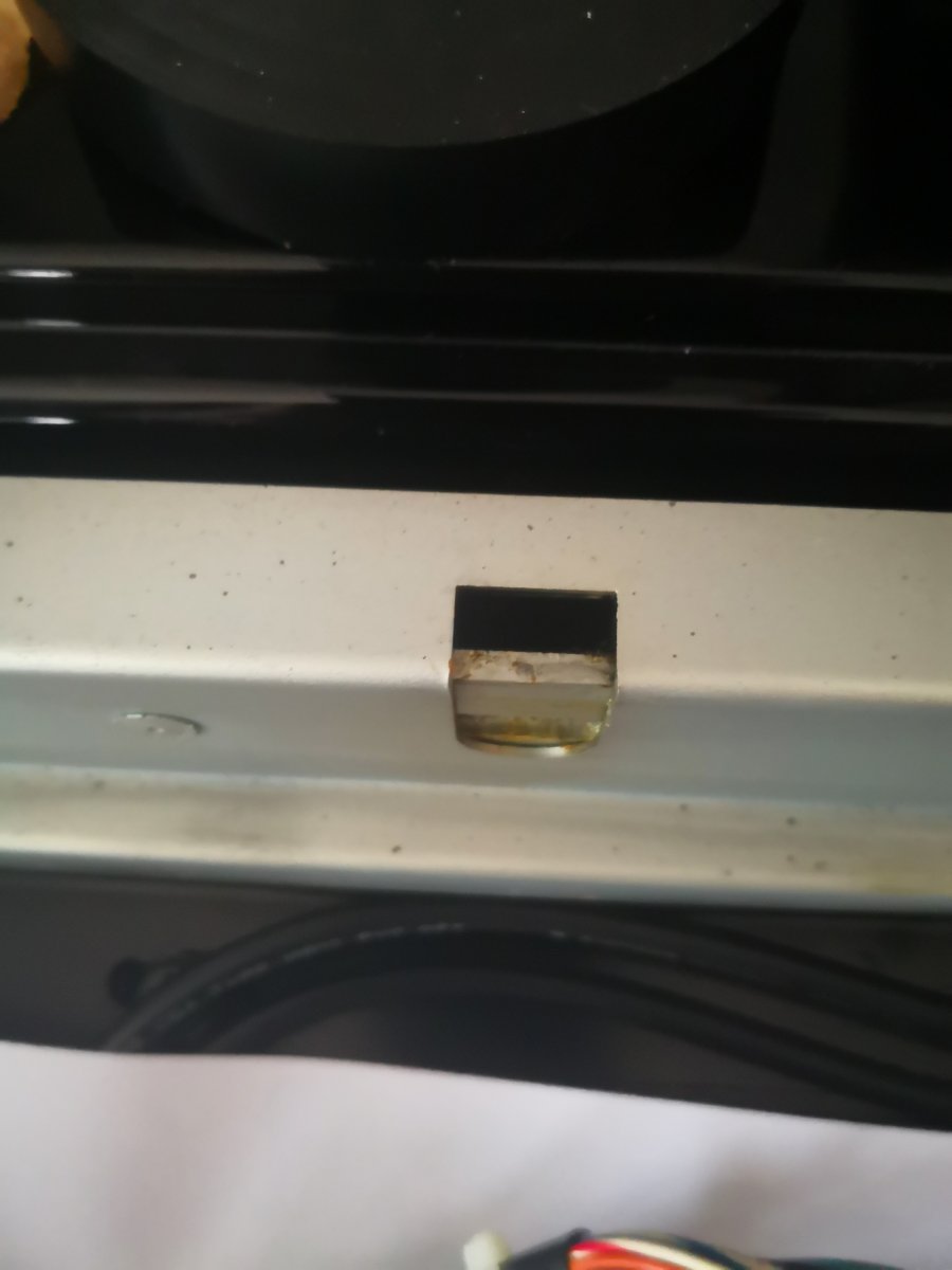

A question for anyone that uses Brook boards (or similar) in their noir, where is the best place to route the usb cable from the control panel, to the game board tray area?
When you lift up the control panel there is a gap near where the sliding innerlock moves, I routed my cables there and mounted my 2 x Brooks converters under the control panel.
Do you mean where the interlock actually latches (like in the photo)? I can't get the end of the cable to fit through and does the cable not get snagged when the mechanism moves? I've tried removing the shield by removing the 4 screws on the front but it wouldn't budge. I don't know if if fixed somewhere else or what else I'd need to remove to free it.

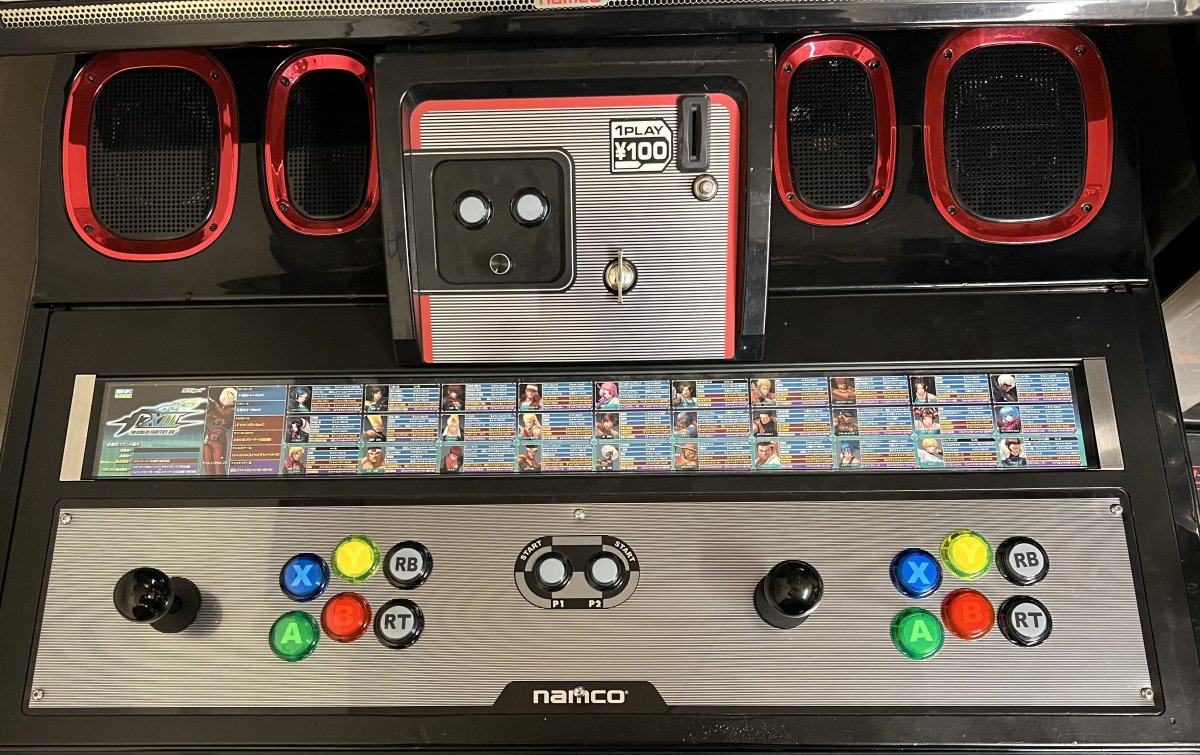

I made my control panel kid friendly, as my 7 and 4 year old would constantly ask me which button is which. The panel itself is an Alberto proto reject, looks and functions beautifully except for the screw holes that were not supposed to be cut out on the overlay. I removed the banapassport and gorrila taped a black painted piece of acrylic and mounted 2x24mm buttons for select/coin/back as well as relocated the volume knob for easy adjustment.

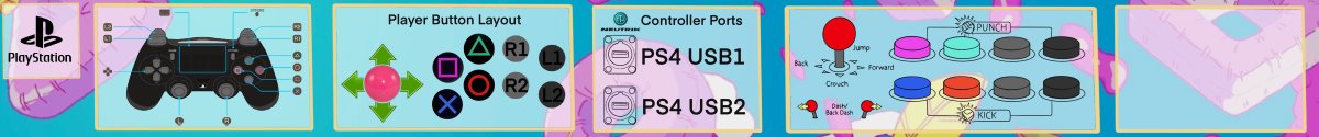

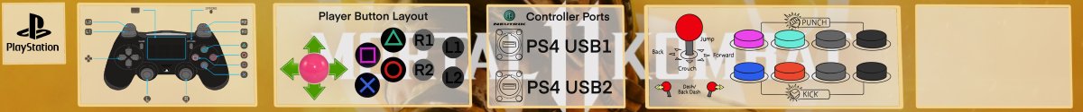

So I was board tonight when I got home. tried to come up with Instructions for people who are clueless, but at the same time having them be universal. Also decided to try my hand at a marquee. I used a stock background so wasn’t that tough and added a few things. The instruction sheet is nowhere near done. I’ll figure out a place to upload some of this once I get better. I’d like to recreate the artwork on the cab itself and will be doing some measurements soon. I’ve owned a lot of cabinets but these are absolute tanks.
