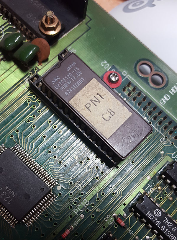

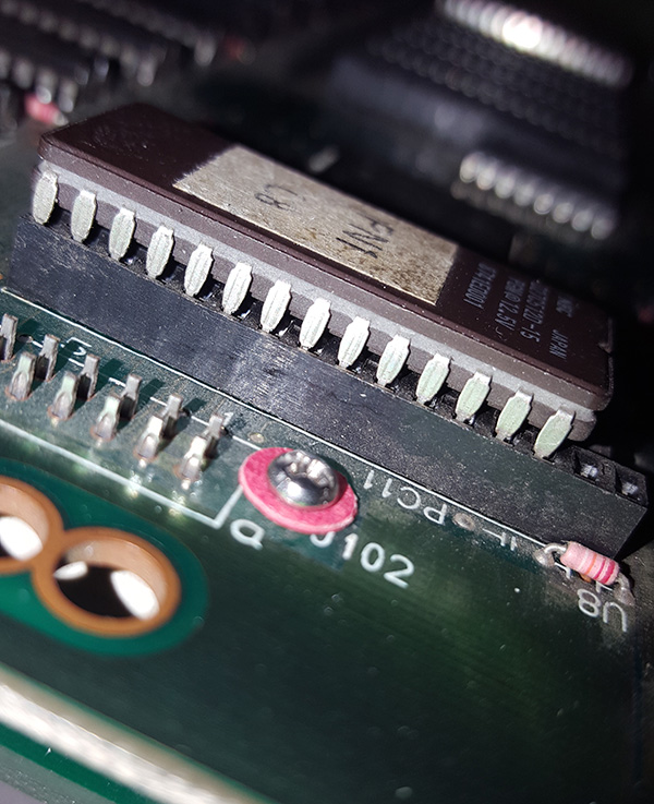

OK here's what I used - my PCB is a vanilla Pac-Mania, modded only to change region and add high-score saving using the excellent RomPatcher utility:
- 6x M2.5 x25mm pan-head machine screws -here
- 6x M2.5 full nuts -here
- 6x M3 fibre flat sealing washers (to protect the pcb) -here
In all honest I likely have spares in my stash and could send you just the amount you need cheaper than you requiring to buy multiple bags of these things.
And the old sh***ty bolts which were a mix of random anything really:
Thanks a lot Flinnster!! I'll buy them myself but thanks for the offer. There is a bunch of PCBs that have daughter's boards with these type of screws!, My Robocop also needs them and probably a few more boards as well. I rather have extra just in case.
but man you saved my OCD life ^^^^.. I want to get some that are longer than one inch so I can also connect the multi board to the other boards.
You'll find typically PCB bolts are either M2.5 or M3 to fit the PCB holes in whatever lengths that were required to separate the PCBs. I often using bearing spacers of various lengths around the bolts so I can choose how far PCBs sit apart from eachother - especially when replacing horrible weak plastic pcb standoffs.
While tidying up boardsets I've artificially spaced out some with longer bolts and bearing spacers (for instance where there are weak fin packages or components running hot on a lower PCB) or compressed bulky boardsets down with shorter ones. My Bubble Bobble is now a nifty half height one ^^
