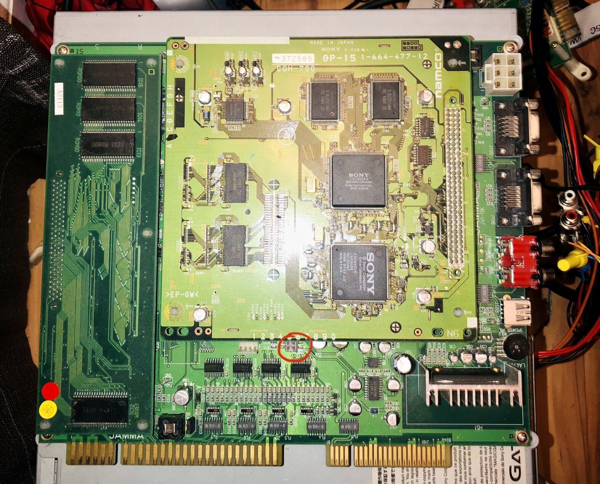

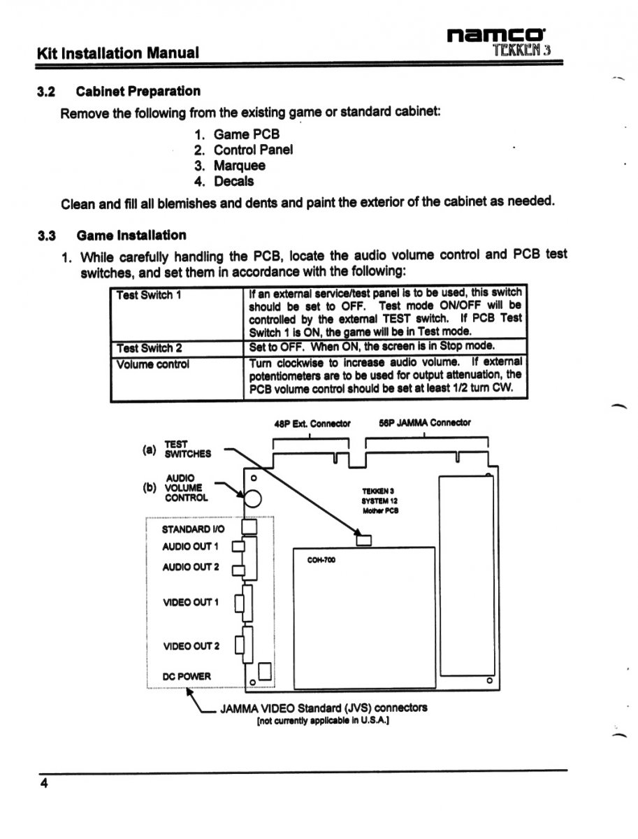

The dips are labeled 1 and 2, only flip #1 on the “on” position and you’re good to go, dip switch #2 doesn’t do nothing, it just freezes the game sort of like a pause button. Don’t turn #2 on. Hope this helps.PascalP - Thank you i didn't see the location on the Tekken Tag Tournament manual.
Franco23444 - Thank you for your picture, so i need to switch the both switch? or only the bottom one or top one?
The switch need to be done before switch on the PCB or in the game?
