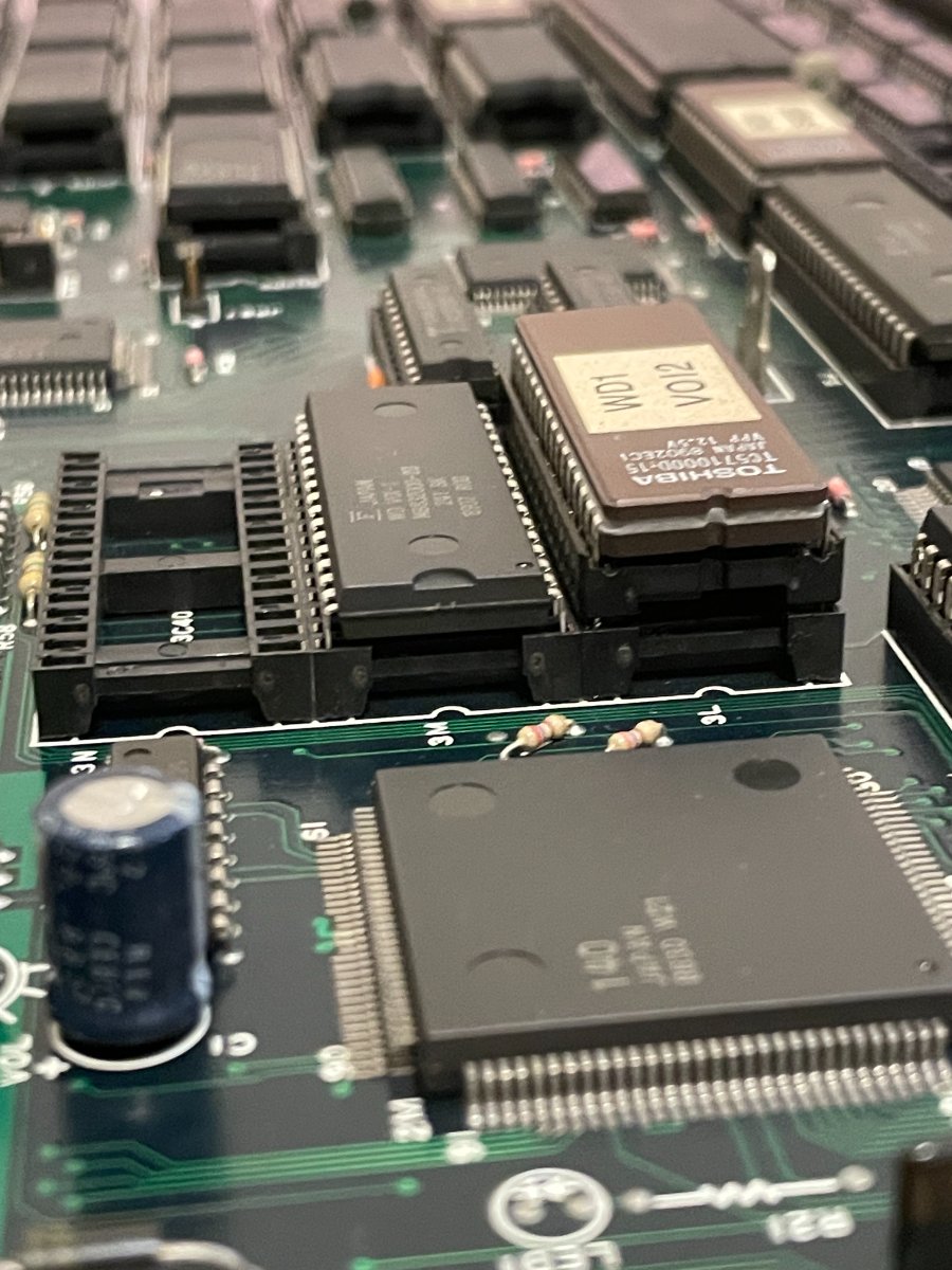

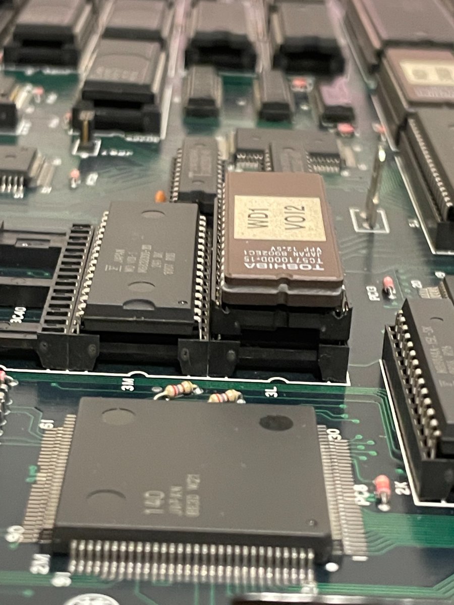

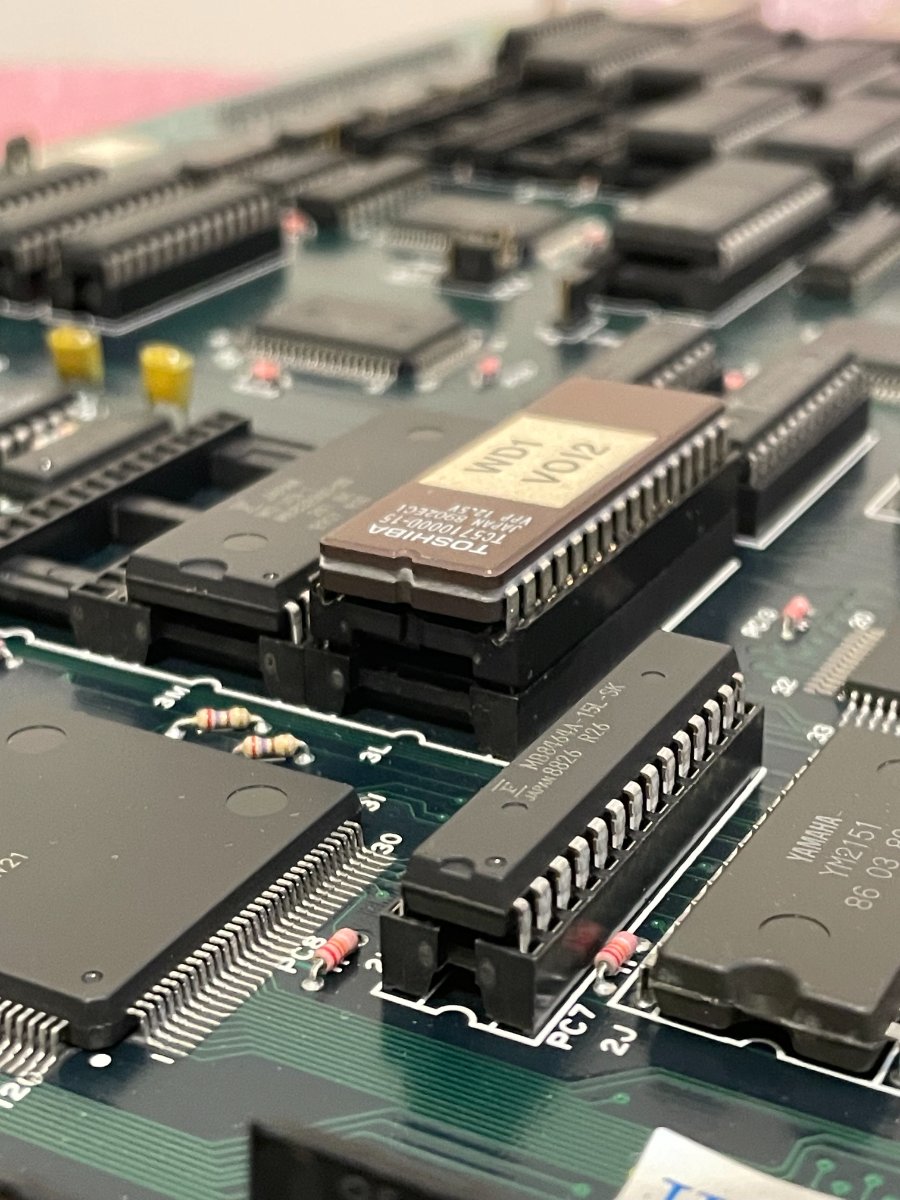

My friend picked up an original Valkyrie PCB that's considered the "Old Version" but with a interesting fix. They mentioned the seller had attached something onto the original VOI2 socket to allow full audio playback as intended like the "New Version". I didn't know what they meant until I saw the PCB. I've attached some images to show what was added onto the VOI2 socket and thought it was interesting to share.
Conceptually, I'd imagine it's something like this: https://www.dentsubo.net/~nosuke/diary/diary.php?y=2011&m=12&d=7&n=0&x=5&a=1&mode=comment but in the form of a conversion socket to keep the original VOI2 EPROM. Anyone know what the seller used here? It's a very clean fix.
I thought the old version of Legend of Valkyrie was just the sound ROM being written to the incorrect chip type ?
You're correct. The game is exactly the same regardless of version (MAME and Arcade Archives are both using New Ver iirc). Same enemy placement and various glitches can be done (i.e. several skips and invincibility at the last boss). It's just the sound overall that's broken between both versions. https://www.nicovideo.jp/watch/sm20003845
