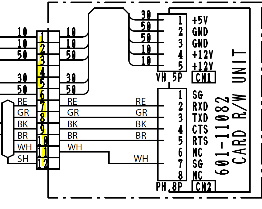

Edit: I checked the wiring diagram and am not sure what to make of the inner connector documented there. It appears to be a 12-pin one:
For the record: I don't have a stock ID3 setup, am and not sure what is considered stock wiring on the reader units. I'm also not sure if there are variations. I simply ordered what was supposed to be an ID3 reader and figured out the wiring with the diagrams and testing.

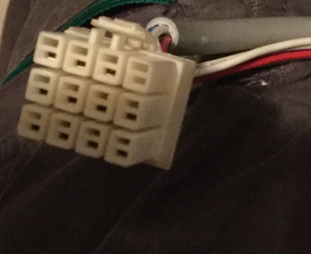

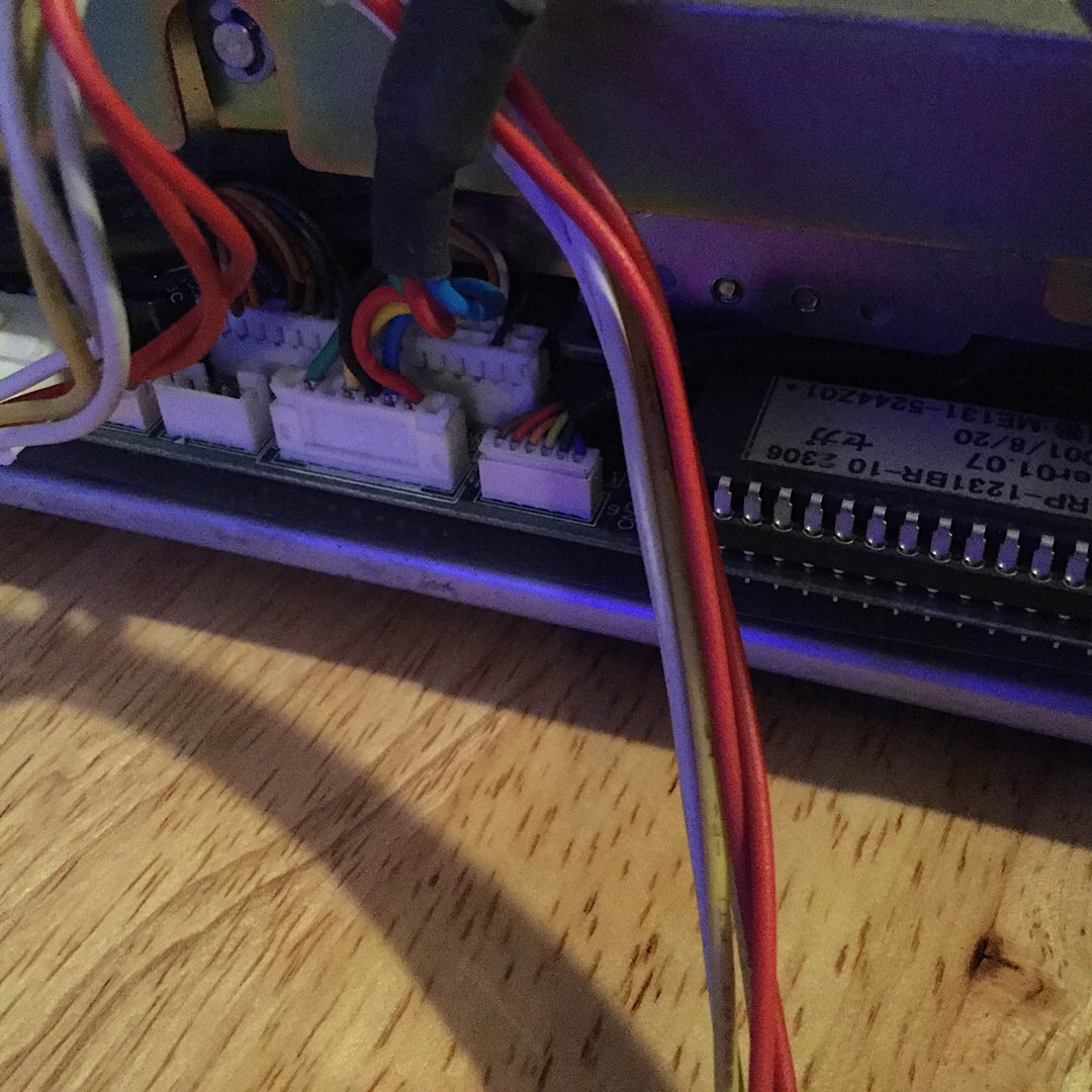

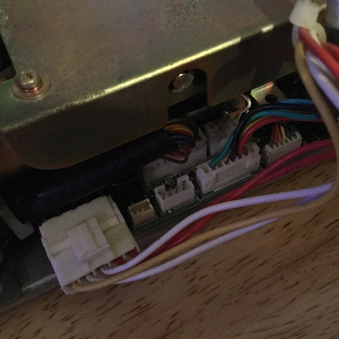

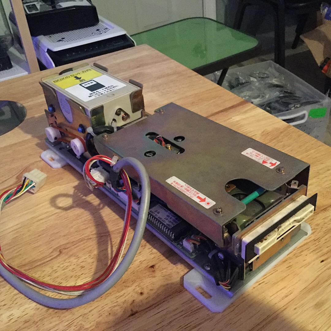

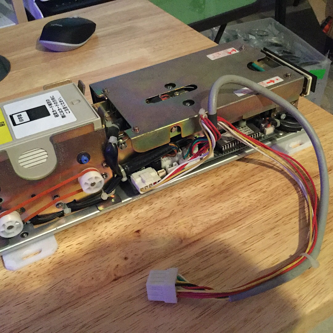

Alrighty. Here is the reader I have, bought as “working”. I have two and they are the same. Both have just this 12 pin harness.
It looks like the same kind of harness that's on mine, so you're probably good to go once you create a mating adapter. I double checked and mine is a 15 pin and a different series connector.
It might be worth sharing the details of the included rom chip. I think I photographed and shared mine much earlier in the thread.

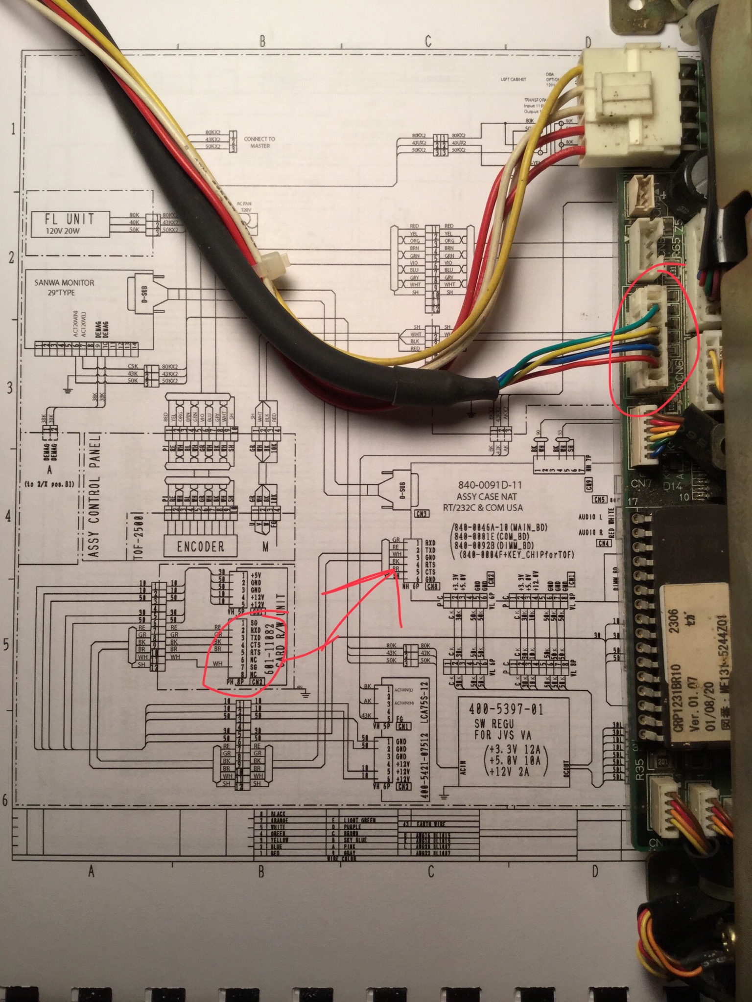

Got some time to look at this more. It looks like the connector on my units is just upside down compared to the one in initial d3. I’m looking at the schematic in the id3 manual here. Got my connectors and pins. Now I just need to wire it up. I don’t have a steering wheel yet though, I hope to get that going soon.
I think you're good to go. Notice the numbering on the 8-pin connector. It just has the pins numbered the opposite way as the other connectors near it. It's still correct and should match up pin for pin to the wiring diagram you printed. You've just got some different wire colors you'll need to keep track of.
The other good news is that you've got the same firmware that's on my unit, so I think you won't have any problems running it on ID3.
