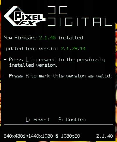

Install fw 2.1.45 (currently marked unstable/testing), then the pop-up shouldn't appear once you set up Wi-Fi once:
The firmware can't be completed. It's giving me this screen to push R. I can't push R. I'm on Naomi. I even plugged in a DC controller to the filter board. It works with the game but R doesn't work.

You should be able to use a compatible TV remote as some have discussed, but I don’t see further mention of it in their install guides… did I miss it?
Did you use the web GUI to upload the file? The web GUI also has a virtual remote you can use to navigate the OSD.
