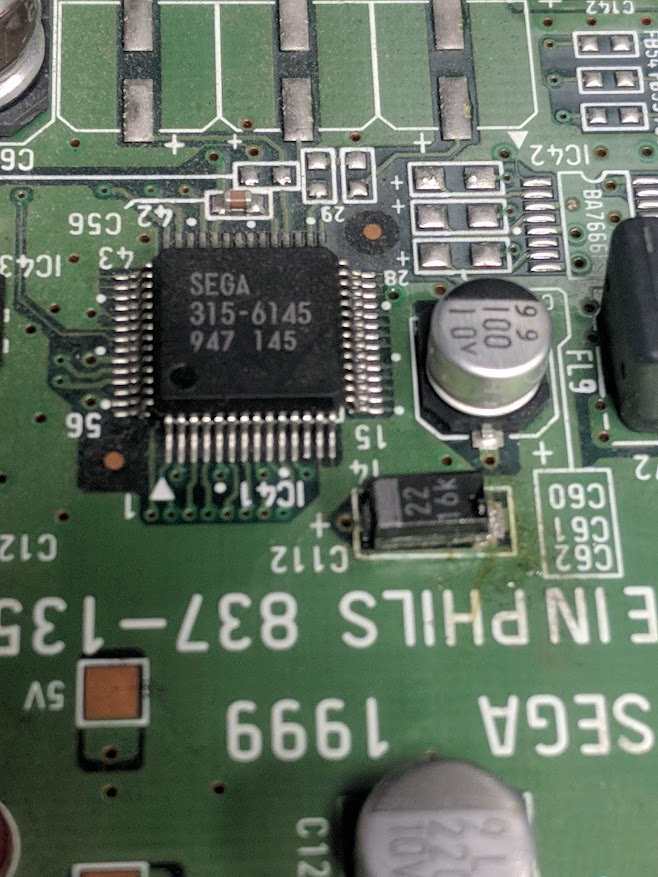

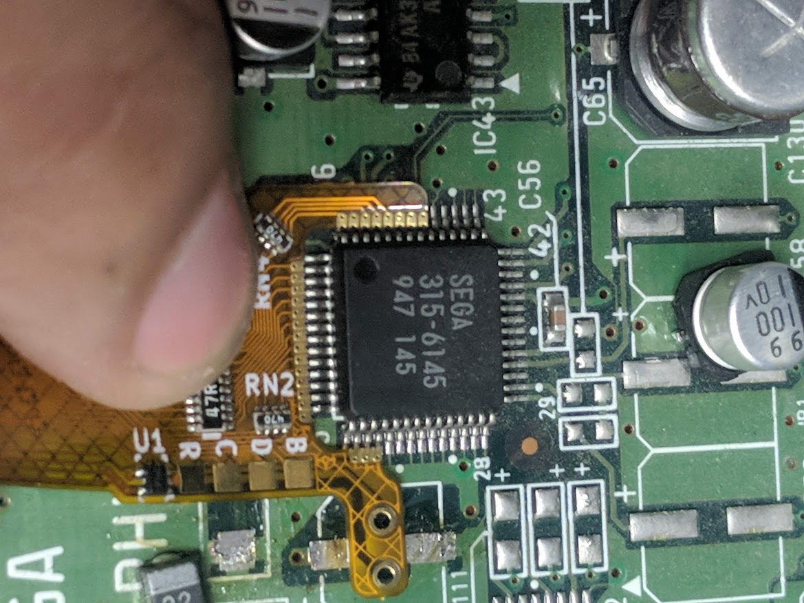

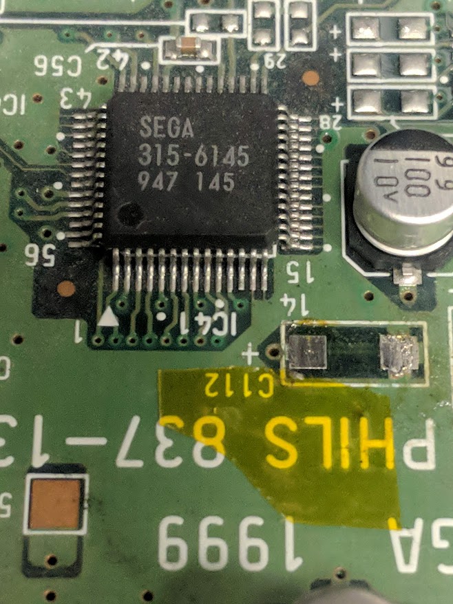

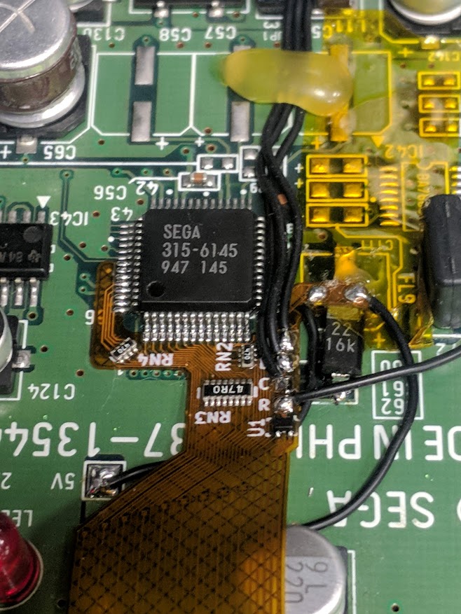

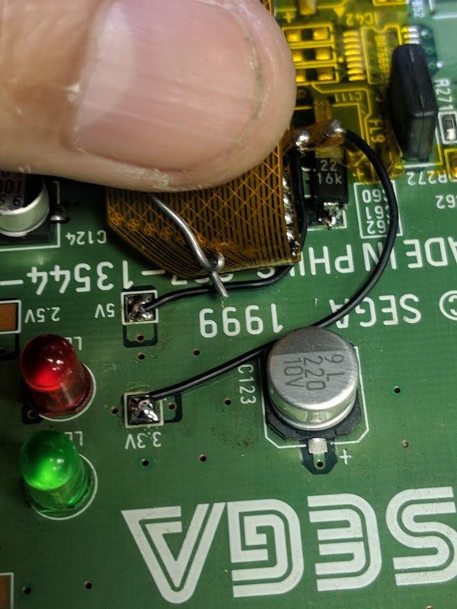

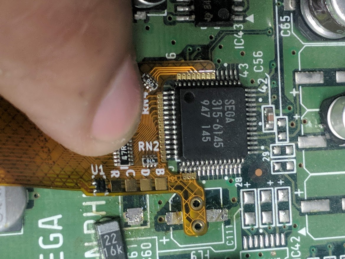

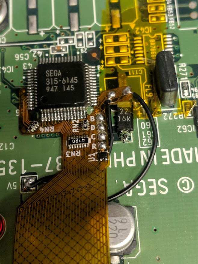

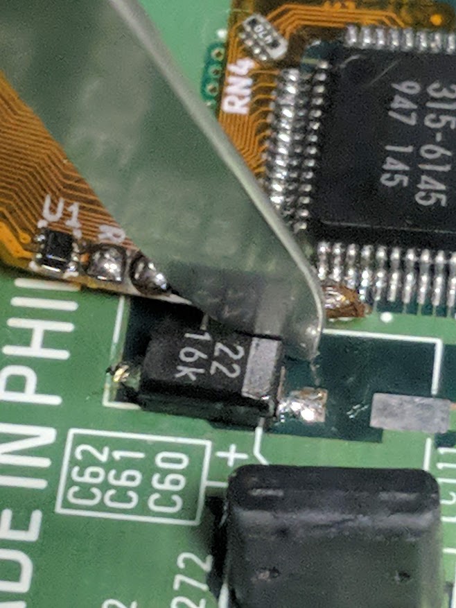

Hello Cruzlink2!
I noticed that you installed a DC Digital in a board that's identical to mine. It's different to he Naomi 1 that appears in official instructions! Please, just to be sure, let me know if what i need to do is:
  1. Remove C111 and C112 capacitors.
  2. Connect flex to 3.3V and 5V pads.
  3. Solder C112 capacitor (22 16k) to the negative pad of its original position and positive pad of C111 (SMD electrolytic) capacitor.
  4. The C111 capacitor is permanently removed.
  5. Protect pads with Kapton tape to avoid contact with flex
  6. Follow original instructions to connect B, D, C and R pads with hookup wire in board.
Thanks a lot!

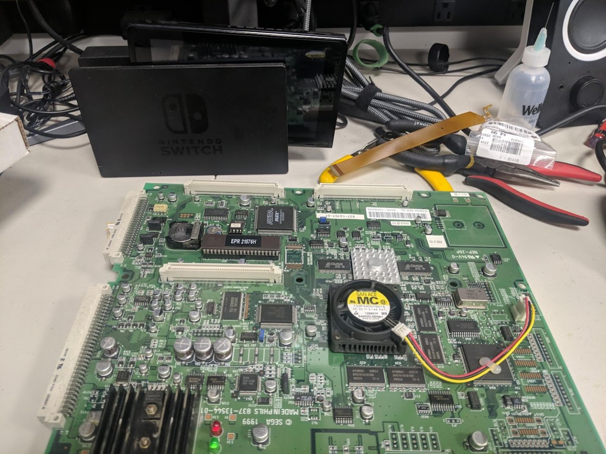

Gonna post some pictures and hopefully that will help ya.
