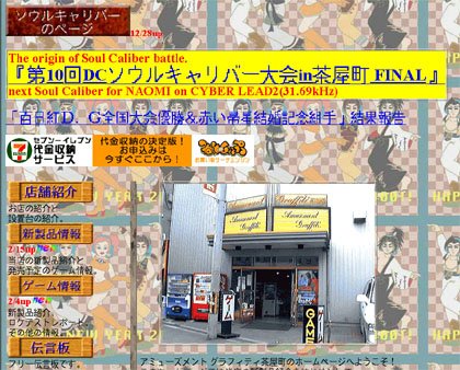

Sorry to drudge up an old thread again but I did have a question related to the BIN files. Is it possible to netboot Soul Calibur on a Naomi 1? I ask because it seems that not only is this one of the more popular games for the Dreamcast and Arcade but I saw some videos of people who have done this. Thanks and have a wonderful weekend!
Where did you see said video?
Someone here pointed out that this was a System 256 game, his point was there is indeed a Dreamcast port of Soul calibur: he was asking what sort of wizardry was performed in the video he claims to have seen.
As I understand the reason we can’t currently play Dreamcast games is linked to the uncracked bios CRC algo. I’m likely wrong.
So particularly you need to grok the difference between a Naomi Upright Cabinet, and a Naomi system (similar hardware to Dreamcast). The NUC cabinet itself has nothing to do with netbooting. You can put any hardware you want in it.

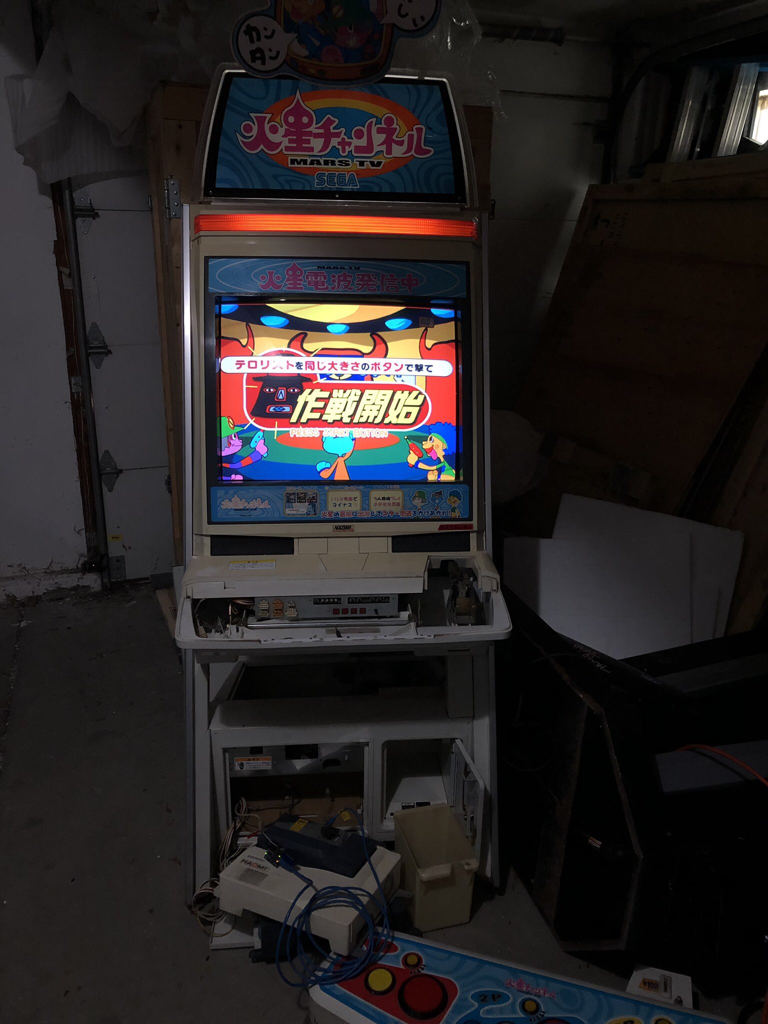

Are these two "protected" in the same way that MarsTV is? Because I am netbooting the M2 protected MarsTV just fine here...
Per our previous conversation here: All the officially released Flavors of the Net City/NAOMI Universal Cab
I noted the segam2crypt which we also already discussed All the officially released Flavors of the Net City/NAOMI Universal Cab
Seems this *problem* has been solved, but folks don't talk, or share openly, as we all know :/
@fsckewe I'll speak to the person that helped me with MarsTV, and see if there is a known / similar solution for Dynamic Baseball.

are you really sure it is "just fine" ?
as I see MarsTV for sure read some data using decryption, then compare them with other data, store comparison result, and use it later (in case of failed prot.check it calls some subroutine, not sure what exactly it does)
in general, it was Sega's recommended way of doing protection checks - do NOT instant hang the game if check was failed, but store result, run game as usual, and check it later in game, and make the game somehow un-playable in case of bad check result.
is this what the patcherv6 "fixes" ?
no, D.K. said patcherv6 only fixes "DMA-clash" issues, it doesn't patch the protection checks.
are you really sure it is "just fine" ?as I see MarsTV for sure read some data using decryption, then compare them with other data, store comparison result, and use it later (in case of failed prot.check it calls some subroutine, not sure what exactly it does)
All I know is the game seems to play as expected from start to finish, I can leave it running for hours on end with no issue.
I'm asking now if I am able to share further.
I did some disassembly, and in the case of failed check at each frame MarsTV does like:
various_game_variables_array[rand()] = rand();
i.e. trashing random bytes in memory.
perhaps you need to run it longer, so it will destroy enough bytes ? ;)

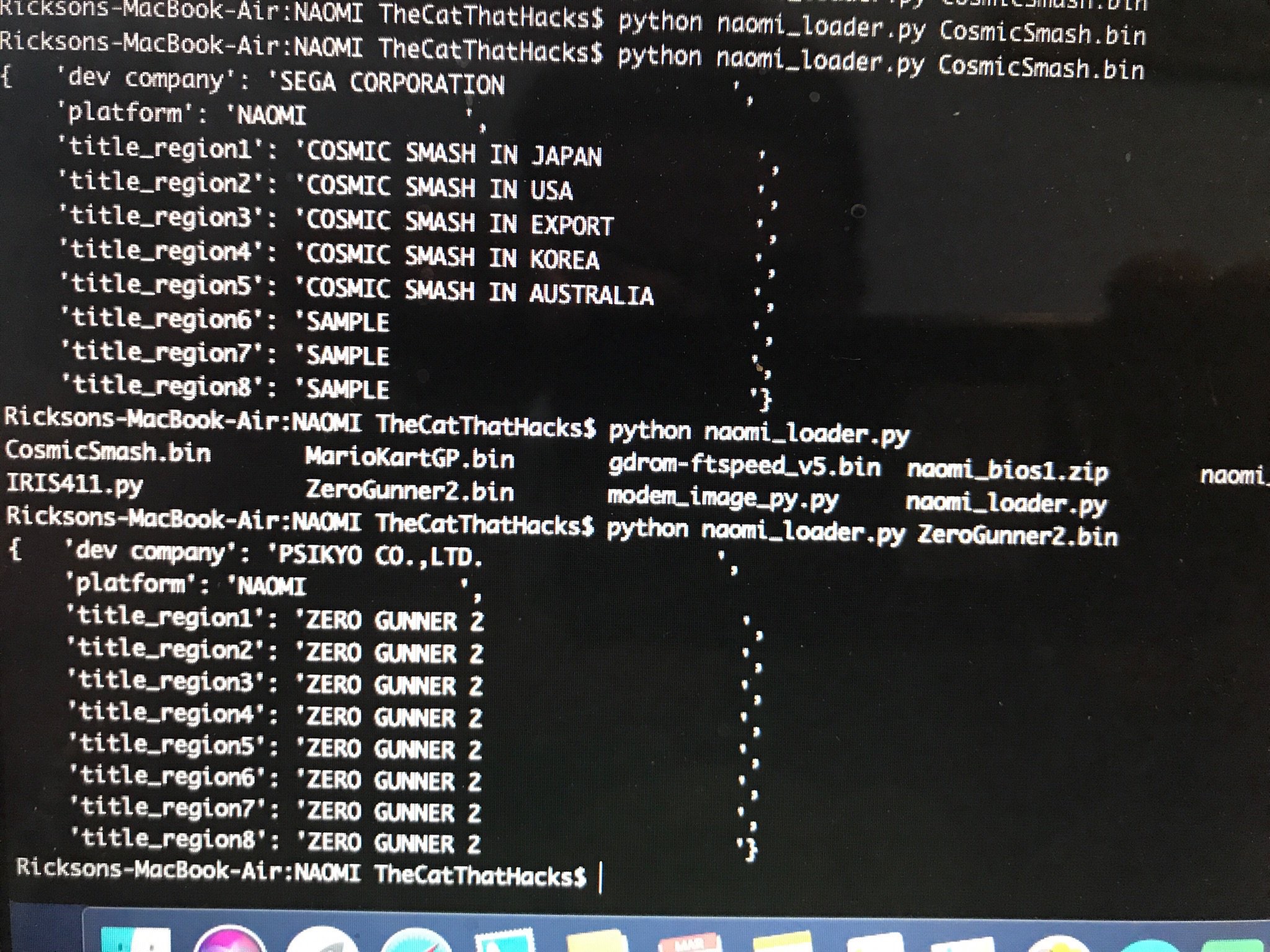

Sweet mother of baby jesus, yes I'll open my stuff soon please give me a few weeks to post everything.
I just moved to Seattle and everything was in boxes :P but I can post some stuff this weekend before I get dragged to Boston cause of work.
the GHidra is going to be a pain since I don't own the project but my IDA Pro Loader, and the binary ninja stuff and my notes on how everything is actually setup!
FTR @Finisterre has been nagging me for months to open it, #shrug .. sorry for being slow :] but it'll open up :D
