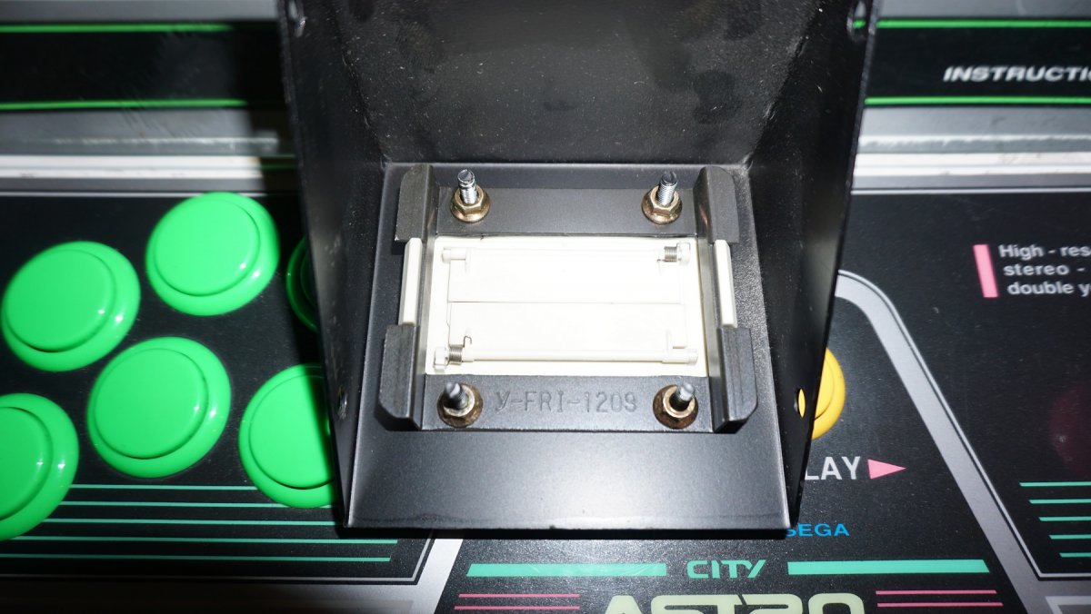

You could always do what this guy did and just cut a hole ;)
Yeah sure doin' a hole would do the trick bit still have to mount the connector somehow beneath.

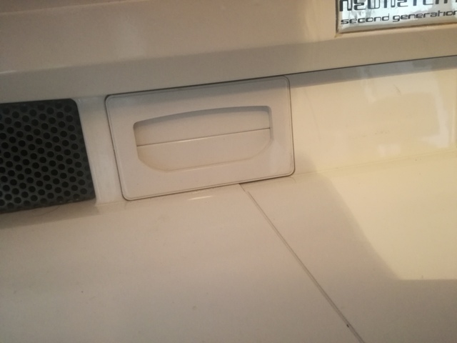

There were official VMU ports for the Net City , they were mounted in a different way than the one in the picture above
A friend of mine has a set and has told me many times over the last few years that he'd love to send one to me so I could make a 3D model for it... but it hasn't happened yet.
But yeah... if someone has the official port adapter and wants to let me borrow it, I'll model it. Similarly if someone has one they'd be willing to sell, I'll buy it and model it.

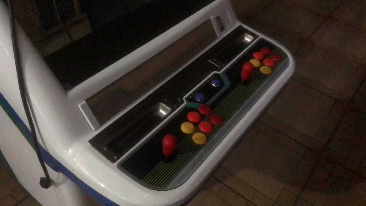

That one looks cool, tho. As I'd use it on a OK baby cabinet, I'd have to cut a hole on the CP to adapt it, right above the 2 start buttons.

givent hat VOOT and F355 had specialized cabs with the VMU port that would maybe make these factory ports specific to Giant Gram?

Externally, the Virtual-on OT VMU port looks like it could very well be the same assembly as used on the Net City as pictured.
I'm absolutely tickled by the idea that I might be able to help with this. Let me pop a VMU dock out later this week and see if it fits in my NNC.

@Ringo that looks exactly like the part on my 5.66 cab, which makes sense. They're the same type of cabinet.
