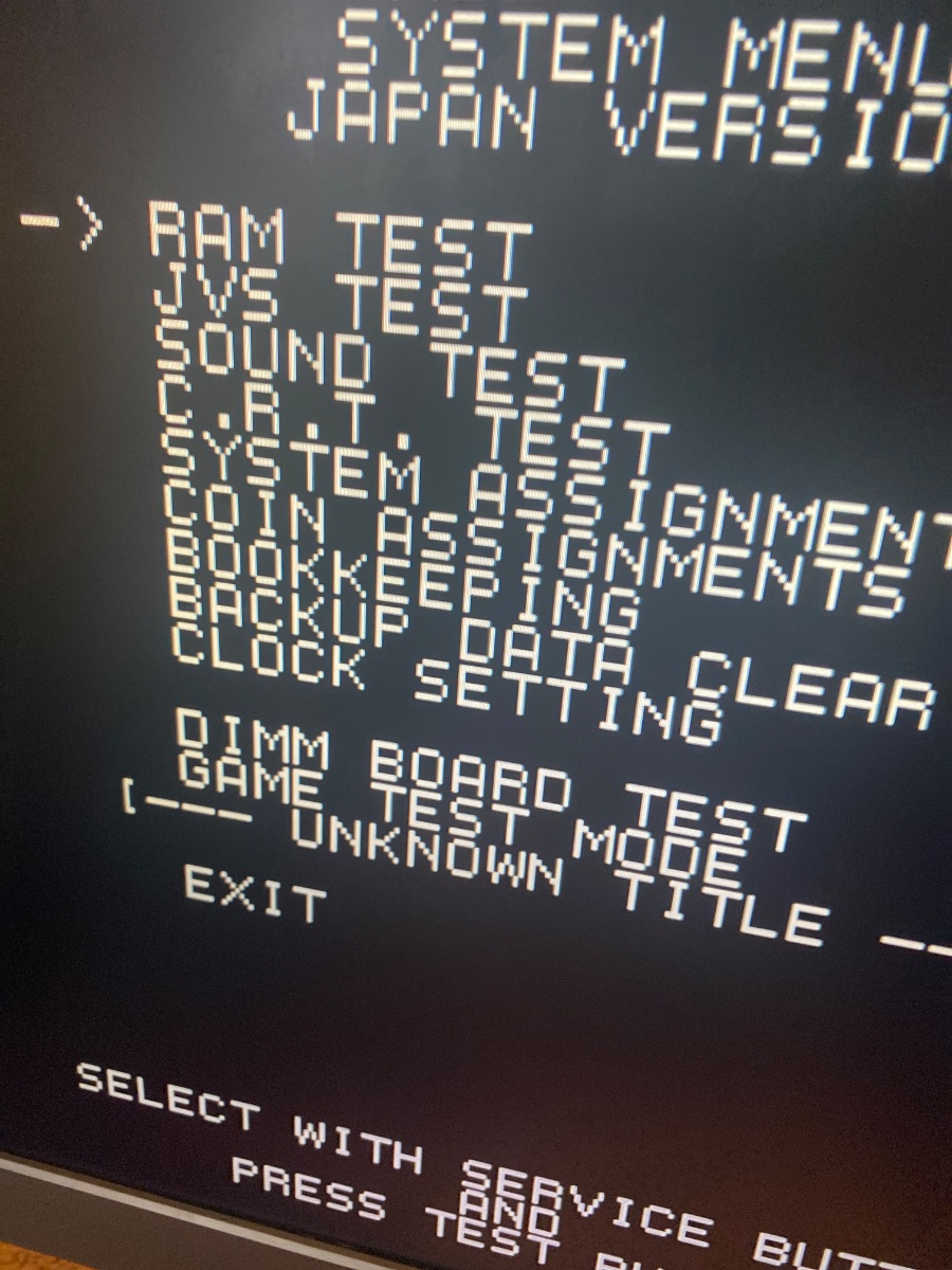

Ontop of that, the green light is showing on here.
