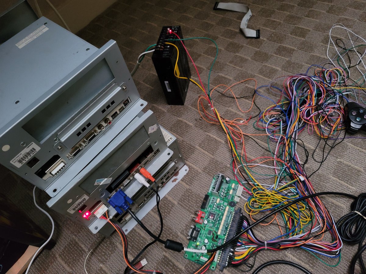

I have 3 possibly damaged 246 PCBs that I can't get to start up.
I'm getting fan spin and lights on the boards, but nothing else happens.
No beeps/pings/error codes I've read people describing, tried every dip switch configuration.
Using a Twisted Quarter power supply through a Jamma board.
A local arcade helped test the PCBs by putting them into a Tekken 5 cab, same problem as above, though we did confirm that my Jamma boards ARE operational.
I've come to the conclusion that maybe the PCBs were damaged in transport from Japan.
I'd like to verify that the drives&keys are actually working before I source replacement 2X6 PCBS.
I was wondering if there's anybody in the vicinity of North NJ, that owns a playable 2X6 PCB, that would be willing to help.
Due to the original damage coming from Japan, and recent increasing postal delays, I'd rather not ship the parts out.

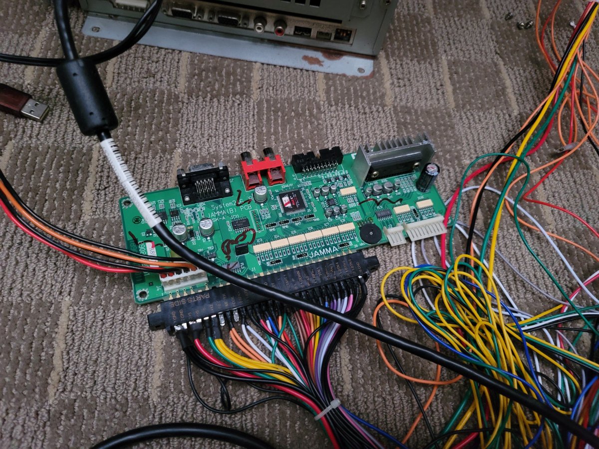

Do these blinking lights mean anything important?
On the 246:
https://cdn.discordapp.com/attachments/751587957269594173/881729824941539338/20210829_223919.mp4
On the Jamma board:
https://cdn.discordapp.com/attachments/751587957269594173/883430264959799366/20210903_151618.mp4
Just figured I'd bring those up in case there IS a problem.
Of course, if I could slap the drives and keys into another board, we'd know for sure what's not working.
I haven’t seen that on my 246 C but I haven’t checked it in a while. I’ll see if mine does that. I know that the red led on the power input of the 246 should be solid. Not sure if any of the 246s have this but on the 256/S256, in the middle of the memory card ports is two leds: one green led and one amber colored led for hard drive based games. It’s basically the hard drive activity light. It’s not lit up when using disc based games as the dvd drive has its own activity light.
Edit: mine also has a second blinking red led, it’s an indicator that the whole system is receiving power.
On the Jamma board:
The green light on the JAMMA pcb should be solid, not blinking. That means that your 5v rail is way to high. Lower it down to 5.0-5.10.
Through testing in the past, I did notice that tweaking the 5v does change the speed of the Jamma blinking. That local arcade's Jamma board in Tekken5 was also blinking, so i thought nothing of it at the time.

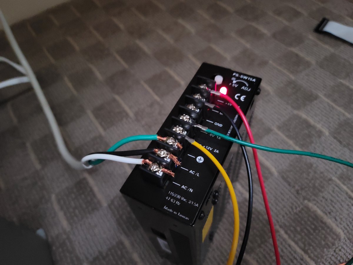

Test all 3 units powered up for 10min, no boot..
Psu
5.04
-4.30
12.06
Cable from jamma board
5
5
12
Hdd
4.32
12
Not exactly what I was expecting when checking numbers. I've read that -V isn't required, but some games do supposedly need it, like Zoids.
Tried kicking the voltage up so the hdd gets 5v (5.44 from psu), and waiting about 5min past powering, still no boot.

i think I found the issue bro: the ribbon cable should connect to the I/O pcb and the system. With out it connected, the games will not boot.
That tiny power supply will also not power the system efficiency. You need a 200w twisted quarter or Happ power pro power supply.
Pretty sure I remember reading that the ribbon cable was for connecting to Jamma controls. I plan on using the PS2 controller connection.
Hmm, if that's the case, which of the 3 they provide would be sufficient?
ALSO, if I could power the PCB directly, as opposed to through a Jamma board, that would be better for me, as I'm not using traditional Jamma controls.
Unless of course if there's some better video signal from the Jamma via a supergun, as opposed to upscaling the VGA signal.

Nope, you still need to have some sort of JVS or JAMMA I/O pcb plugged in. This is not a home console. Not all games are compatible with PlayStation controllers but I’m not sure if this one is one of them.
I can build you a custom 6 pin power harness for the system. You still need a JVS I/O pcb or no game will boot. This power cable is specifically made for 200w 9 pin molex power supplies. This plugs in directly to the system.
