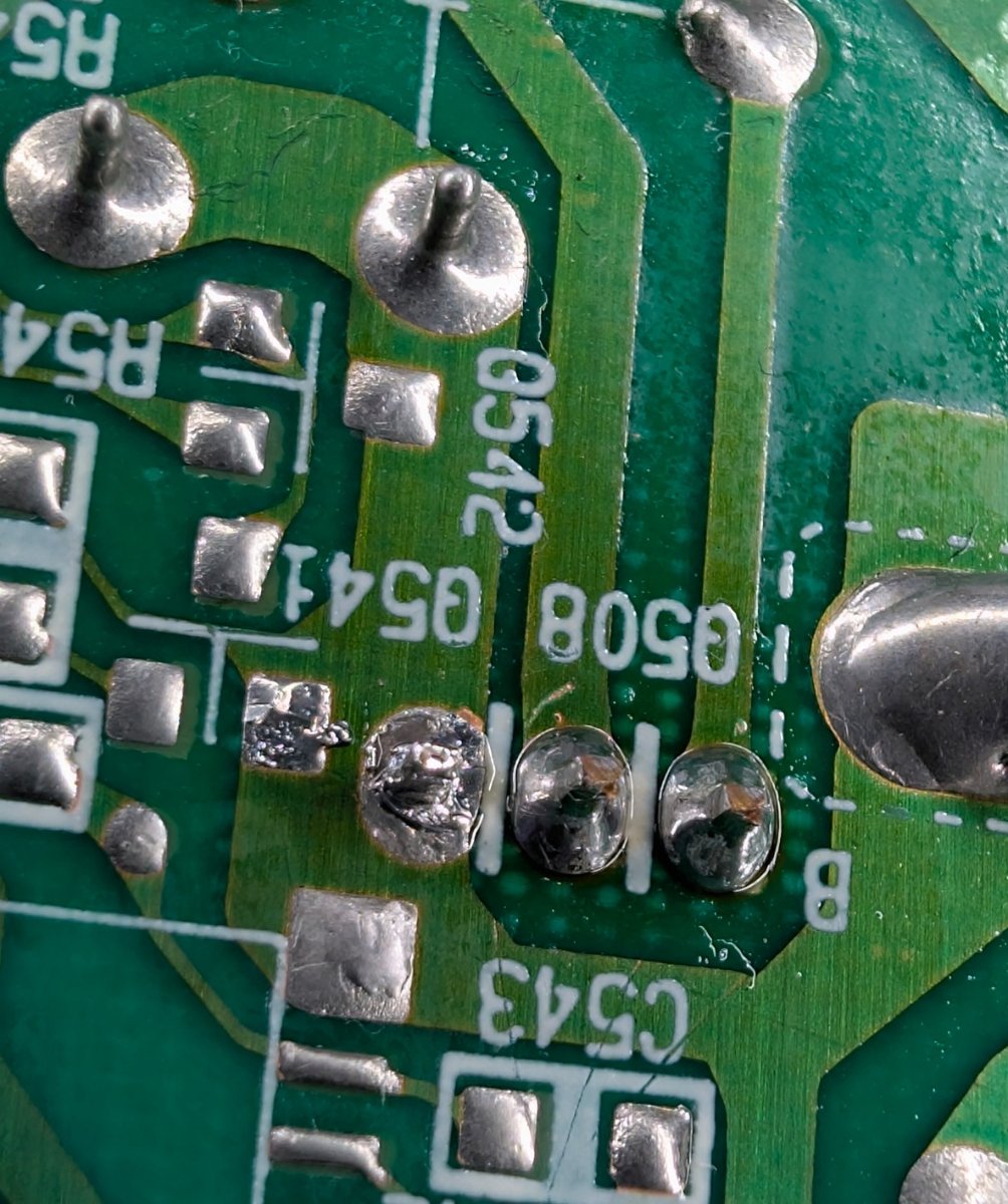

I got a poor joint on the Q508 but no matter what I do I can't get a perfectly clean one (a small section of the solder pad never fills with solder even if I tried to clean it with a fiber glass pen)... would that be a good suspect too?

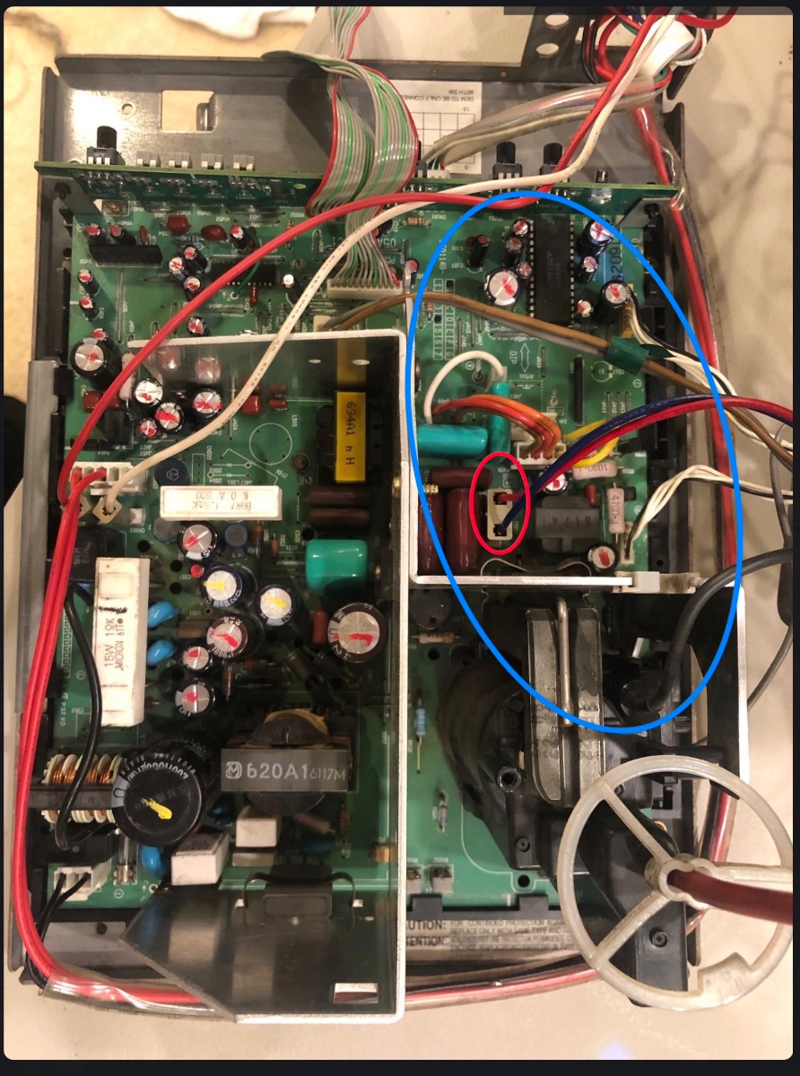

Check for cold solder joints and lifted solderpads around this area marked with a blue circle. Yoke connection for horizontal is circled in red.
Regarding Q508. Could this solderpad be lifted or damaged? Does it move when you press down on the component on the parts side? Do you use flux and leaded solder?

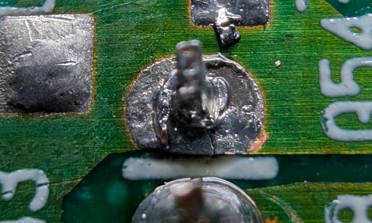

It's hard to tell but it does not move and I use flux and leaded solder and 350°C on a 60W soldering iron. It takes alot of time to melt the solder on that point because the track is huge and it"s a transistor.... no matter my efforts, that small section won't accept solder :( ... I am not too used to soldering yet even if I did a decent job on the rest I guess since the 40 capacitors I soldered let the monitor work almost perfectly... but I messed at some point on a detail and Q508 really looks awful to me... here is 2 pictures. I will reflow HH15 as you advised.
You could try to remove all old solder using lots of flux and some solder wick or whatever desolder tool you have and than apply only fresh solder. Still… I have seen way worse soldering than that. I don’t think Q508 is your problem.
As you advised, I checked the blue circle area for cold solder joints and reflowed the red area and HH15.

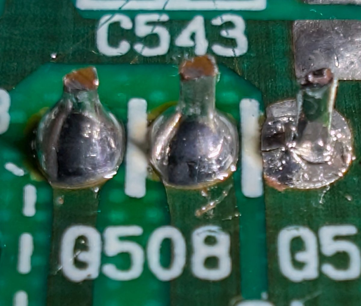

I tried to clean the Q508 pad but it does not look too good right ? I am not sure but it looks like a lifted solder pad, what do you think ? Can it explain why the connection is so poor even if it did not seem that bad ?
If you think the pad is wasted, what is the best option ? Scrap the green resin around to make a solid connection with solder ? Create a jumper with a wire (which AWG btw knowing it is a transistor and the PCB track is huge and connected to the ground and big aluminium radiator) to a nearby point (there are some easy connections possible it seems and not far away)?
Or should I attempt one more time to make a good solder ?
BTW I know the nearby small solder to the left look bad but I planned to fix it later :)

Looks worse now than in the other picture. Try to remove as much of the old solder as you can and hit it with lots of flux and new solder.
So, a quick update on my problem!
I reflowed all the solder joints that looked suspicious. The Q508 looks good now thanks to your help!
