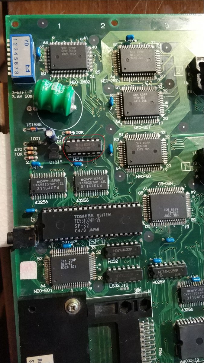

hi again!
a new motherboard has arrived, which is also bad!
I replaced the TC 531024 ROM from it
but unfortunately no change has taken place.
I was a little insecure. which motherboard should I start repairing?
The new motherboard displays a Calendar error on the screen due to the 0V battery, but unfortunately here too, there is a display problem.

on first start as I tried, the image didn't run!
He showed a Calendar error screen.
Calendar error = system cannot read the clock/calendar chip.
Look for damaged traces around the 74HC32 and the battery backup. You probably aren't getting +5v to pin 14 of the calendar chip because of a battery damaged trace.
That would also explain the jumping screen and the third picture with just garbage - you probably have one or more dead traces around the 74HC32 and between it and the Backup RAM. When the enable traces and the R/W signal traces for the Backup RAM get damaged the RAM will output data spuriously to the data bus causing the CPU crash.

@channelmaniac Don't you think the clock divider and/or 24Mhz crystal may be faulty? It would explain the stretched pixel effect you see and would cause a calendar error because of the timing check mismatch.
I've never seen that failure in the hundreds of NG boards I've repaired. Could be a first... but it's easy enough to check with a modern oscilloscope or frequency counter that will show you a count of the frequency. If you have an old-school scope you can take the timing period the horizontal timebase is set to and calculate the frequency manually.

I replaced the 74HC32 ic today, but unfortunately it didn't solve the problem.
And of course I replaced the battery that was completely discharged
Now I'm starting to change the quartz for him.
wow ...
I managed to solve the garbage picture problem !!!
The quartz exchange brought results!

Did you check the traces around/under the HC32 while you were replacing it?
Have you verified +5v on pin 14 of the clock/calendar chip with power on?
I saw it exactly two times, counting this one.
