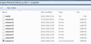

finally gotten to it to install this, tested some random games, but only Progear Halfway to Hell doesn't work.
Writing the game happens in 2 seconds or so, I use the latest @SmokeMonster roll up pack which includes a blank key file.
This is how the folder looks;
Those files are wrong. For instance the program roms should be concatenated as a '.02' file iirc and padded to 4MB.
If the "Halfway to Hell" rom is good on the old pack, just use that and copy the blank 'key' file over to it.
