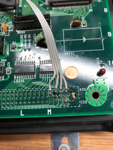

Pinout for board revisions 93646B-3 and 93646B-4
CN2 interface pins:
DATAArduino #2→ CN2 A32
SETUP1Arduino #3→ CN2 A30
CLOCKArduino #11→ CN2 A31
SETUP2Arduino #12→ CN2 A29
I have everything to install the new version on my 4 rev board, but I have a question, this board have a capacitor in the CN Interface, do I have to remove it or do I have to leave it, the photo in the manual doesn´t have that capacitor in this kind of instalation.
Thanks a lot
That's not a cap it is a resistor and it was there to keep the board from corrupting the key during power on/off when it was running using battery
Adding a bit here, since the Multi programs the key every time you power on or change the game, the resistor is now meaningless. But you might want to keep it in case you decide to return the board to battery state and forget that you removed it, you will have trouble. As it is there it doesn't help or disrupt the Multi in any way. So I suggest you let it be (as you've done already).
