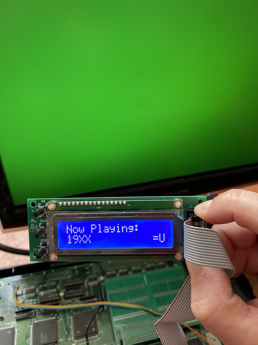

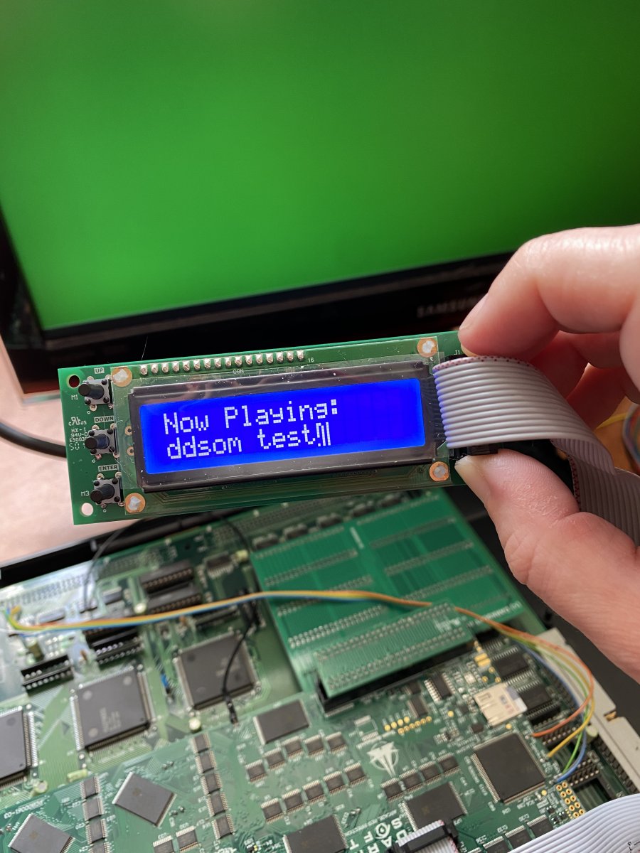

Thanks to djsheep, i reformat my 16Gb sd card with his app. Now i can flash game but I still have :
- green screen
Or some times
- black screen
I tried decrypted game and not
What do you think?

Short EXC5 after installing key writing wires. Reseat everything maybe clean the connectors / pins and make sure everything is firmly connected and there’s nothing damaged.
Key writing cable is already re solder.
I had short exc5 twice. On sd car 2 files have been created (key and now play)
I will unplug everything and clean with iso alcohol.
i deeply hope it will works for me ^^
ps: I’m really sorry if my English s**** ^_^
Your English is not a problem. Just wanna help you get it sorted. Now it’s all semi-working. I suggest you reformat the card and use the latest roll up pack, don’t edit or add anything. Just dump the “games” directory to the root after formatting the SD.
Also, while you’re reseating everything. Check all the pins and sockets are in good order. If you’re still having issues. Post photos of the current setup and also the directory structure of your SD.
