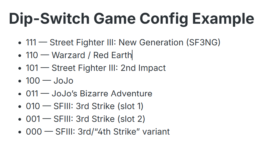

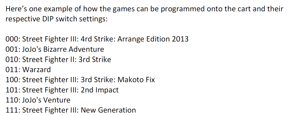

@Darksoft I noted that dip switch selection codes are different on the written guide (shared on the first post) and whats on highscoresaves.com. Wondering which one is correct and if one of these needs to be corrected.
DIP settings in written guide:
DIP settings on highscoresaves.com page:
I do know the manual is wrong.

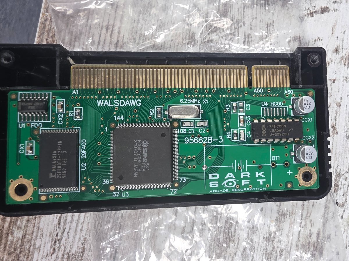

I have an ultrasimm setup, and it keeps freezing on new generation? Reflash?Refresh? It doesnt get passed the region select screen, ive tried every region . Second I press to select it freezes
Which version of the games did you write to the SIMM1 and SIMM2? Custom or SH2? and which cps3 cart do you have? Is it custom or SH2?

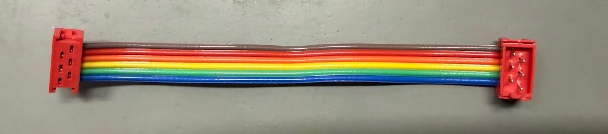

So this whole setup was gifted to me years back, i have the flash tool with it aswell PROMAN 86, but the problem i face is theres a wire that goes from the flasher to each simm, its damaged in my case. The link wires for all the simms on the board is intact and obviously works, Where can i get that ribbon cable again?
Its custom made. Talk to @Mitsurugi-w, maybe he can help make you one.
But the main problem still persists. Your motherboard is defective.
If Mitsu can't help, I can make you one too.
