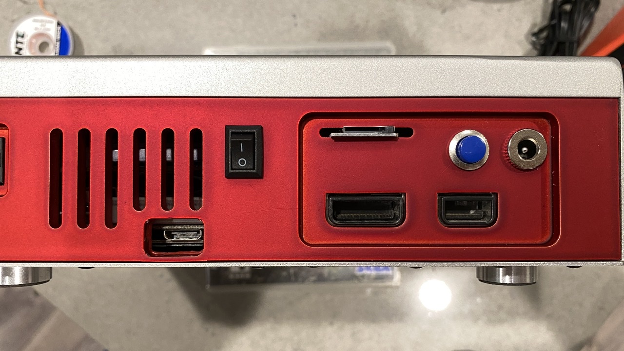

I dont have the MODE hardware now and i couldnt test it. But it looks lik MODE will not fit into my case because of the my power switch. When i have started to this projects, MODE wasnt exist . I havent test it with my PSU

Thanks for answering those questions. It’s tricky eyeballing the MODE publicity images versus your images and trying to work out if anything conflicts. Perhaps I’d buy it and just use it with GDEMU if the MODE doesn’t fit when it arrives. I understand it wasn’t a thing when you designed the case. Maybe a toggle switch could be used in the disc change button hole or enlarge that hole to accept existing power switch If using MODE since that will not be needed in this scenario.

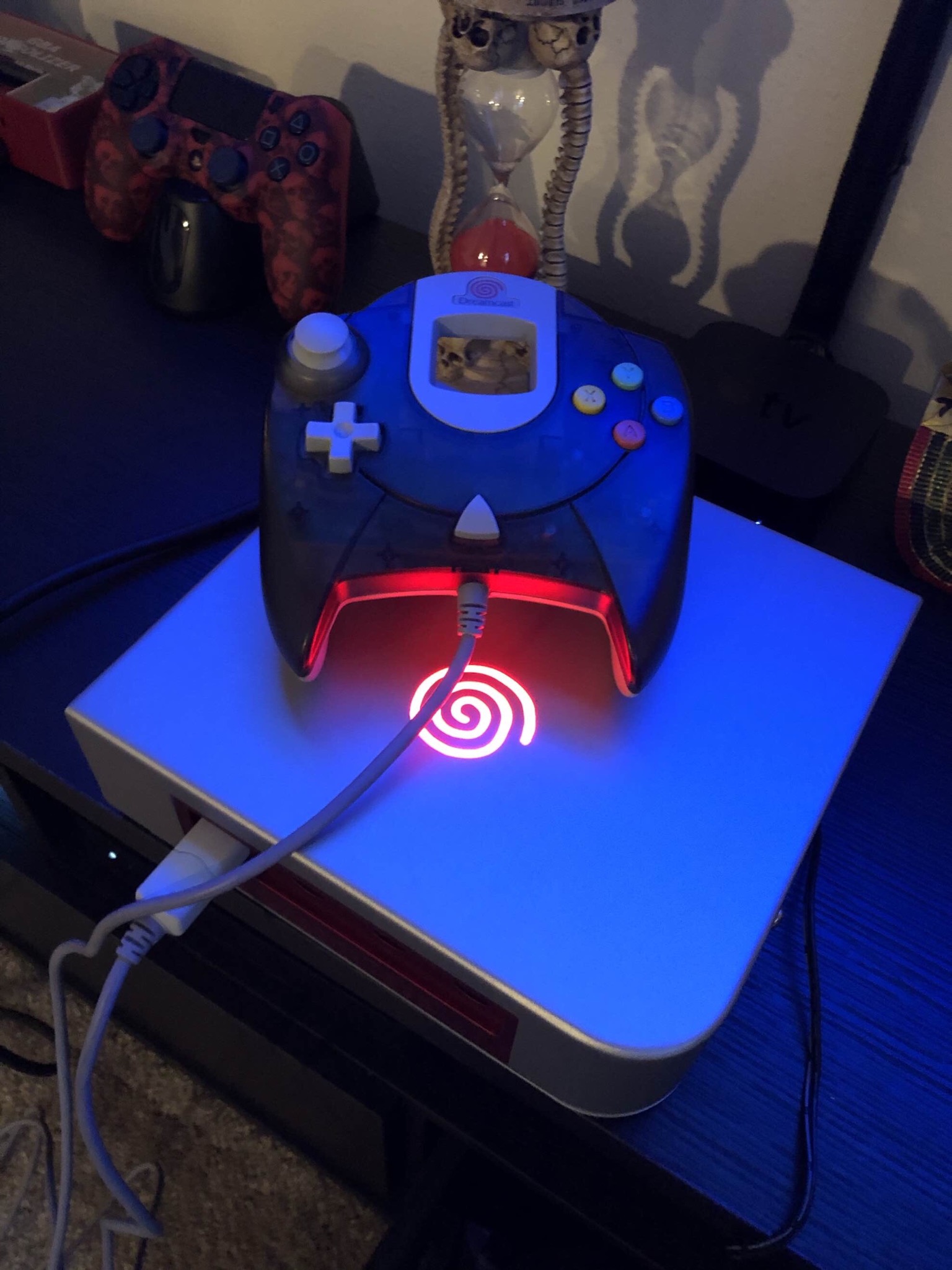

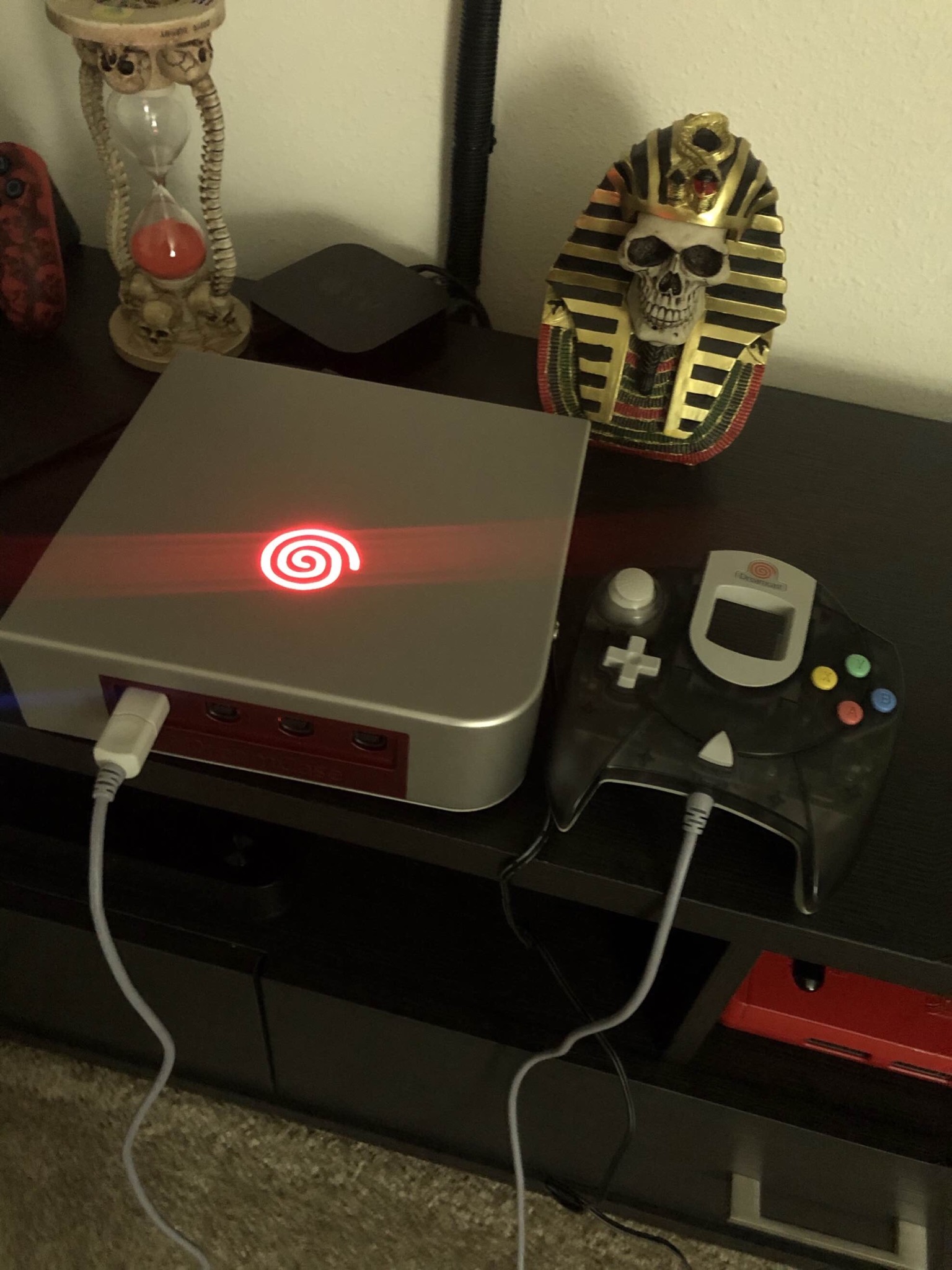

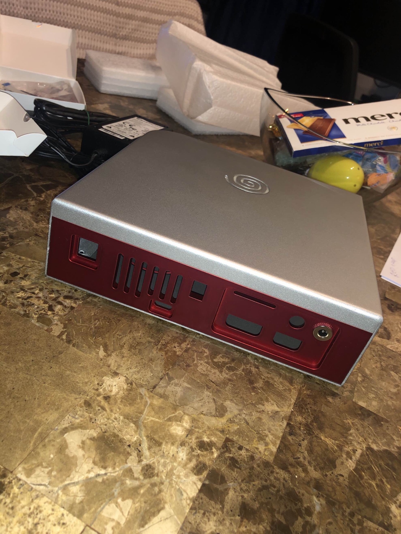

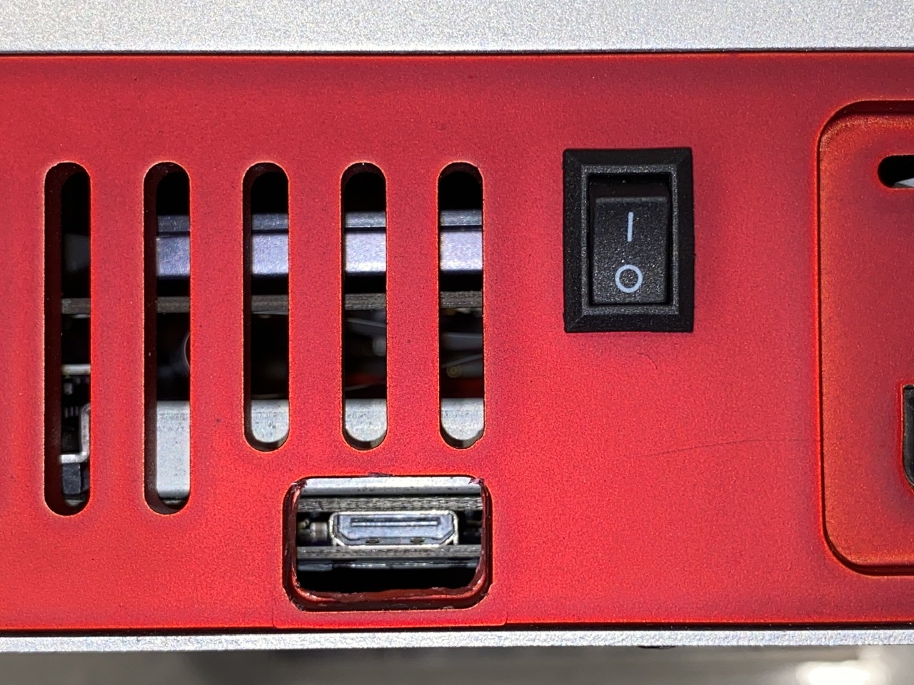

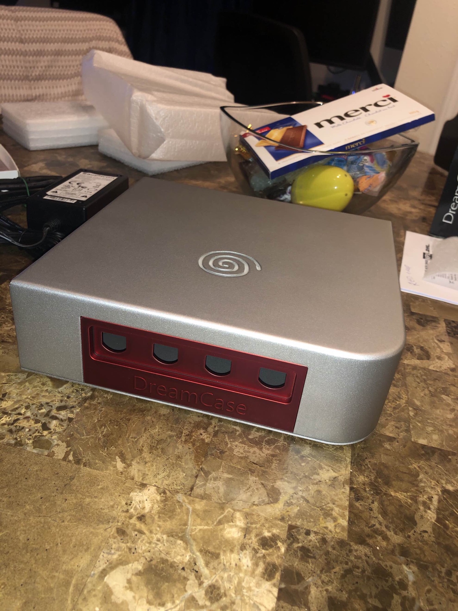

I got mines today!! ^^ <3
Gonna show pictures next week when i put it together.

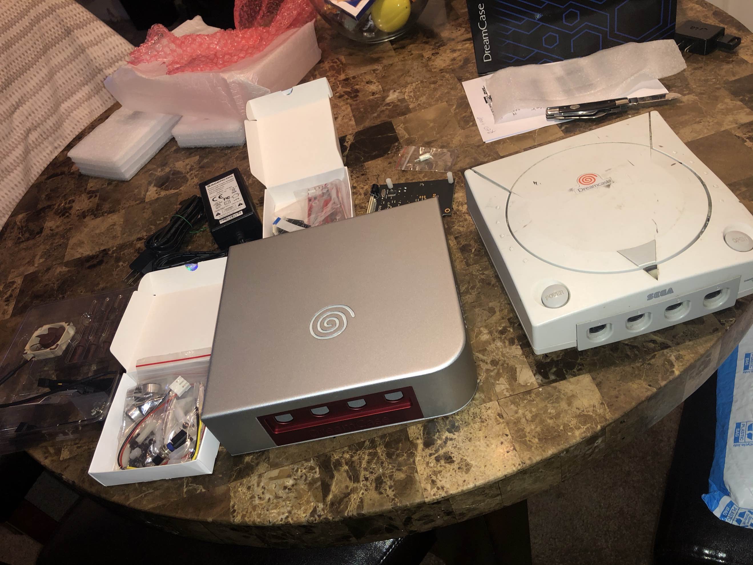

@hursit - great quality on the unit!!! Went together very easily..... tested out 480p via component to CRT - works beautifully. I of course had the wrong 4x10 Noctua fan (got a 12v) so just ordered a 5v one.

How has that monitor not fallen onto your ps2-2-4 yet?
That’s amazing it’s even standing.
Also would like to know why your aluminum Dreamshell looks a lot longer than normal.
Did you get that custom made or is my vision playing tricks on me?
I think it is about the angleview of the camera
