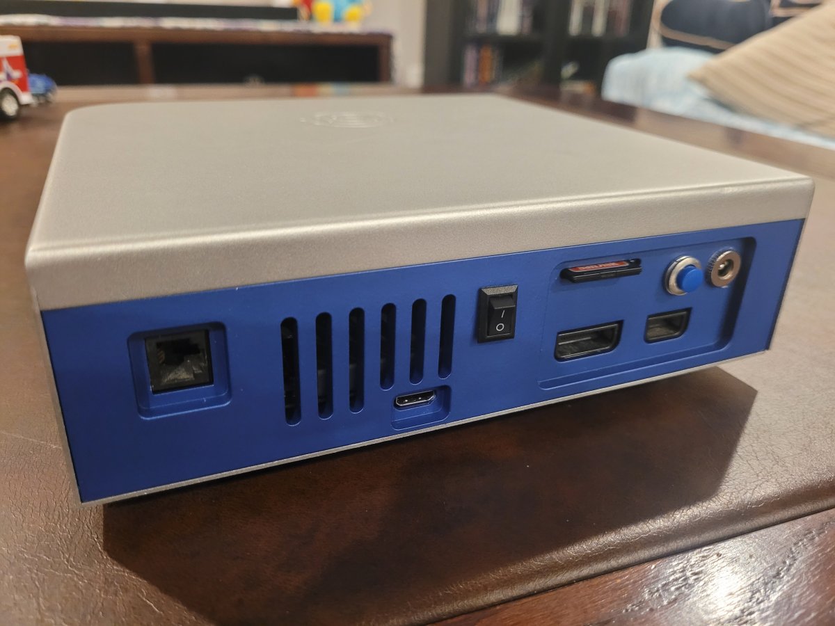

finished mine over the weekend... very solid!
I have a few quick questions -
* does anyone have a link to a comparable power supply that works? The one it came with has an extended adapter to make it US... it sticks out super far.
* any tips on how to get the network adapter lined up better? Everything seems just a tiny bit too high (I'm sure it's something I did wrong, but not sure what).
My network adapter is the same - not *quite* perfect - but i can get the cable in there. The case is designed for the modem and RJ11 port.

Hello people
@Micromort I have designed the Case only for 56k Modem :(
We know the Ethernat Adapter very less produced. Thats why i have made it only for 56k
and i dont understand about of the PSU . You mean my Designed PSU or AC Adapter ?

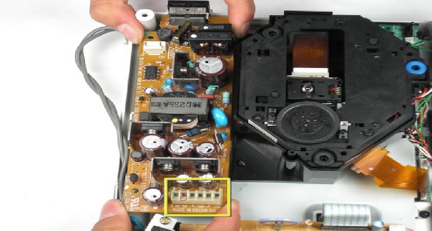

@hursit is there a good place on your power supply to grab 5v? Want to do a small led mod to give it just a faint blue glow from the vents.
HardAzRockz
Jul 25, 2020
68
45
Tucson, az
Red circle. You can probably splice it from the fan's 5v wire or solder underneath the controller port board where the fan pin header is soldered.

hursit
Mar 12, 2016
1,038
2,111
Turkey
There is a empty connector space in my PSU for the 5v my friend
Please pm to me for the details
