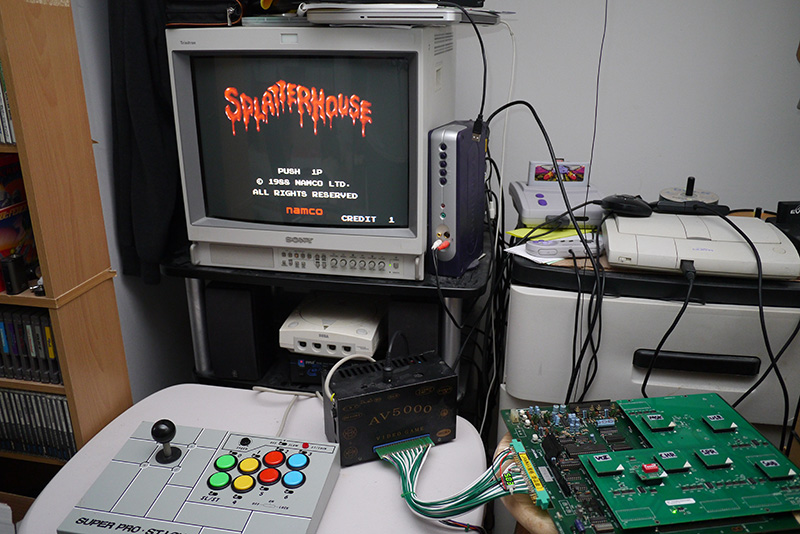

This multi came today, seems to be working normally with a Rompers donor apart from the issues others have mentioned (wrong samples, Yokai and Shadowland not starting due to not having the SEEQ EEPROM). I ordered a SEEQ DQ2816A-250, hopefully that will fix it. Pretty happy with this thing so far!

Yeah, I just ordered the EEPROM, hopefully it will fix it. From that video it looks like the sprites are white, is that normal for everyone?
White sprites are a matter of wisdom.
Replacing the EEP-ROM will improve the black screen problem.
Yeah just checked the thread and others have the same problem, thanks.
