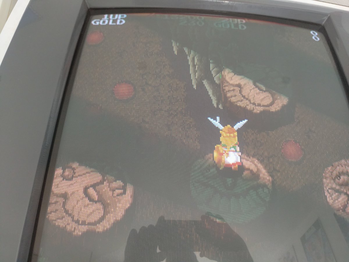

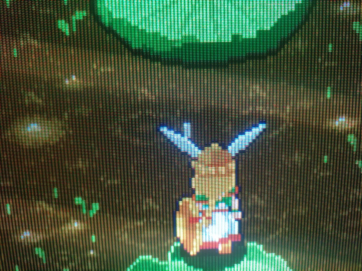

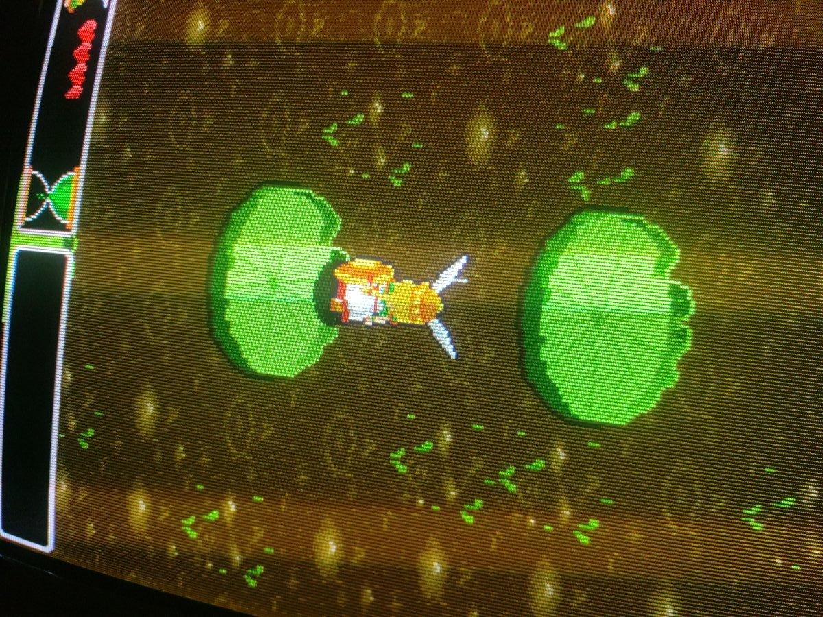

Does anyone have issue with Valkyrie, 1st player sprite issue on top of her left horn (see attached picture)?
Yes I already tell it on this thread on page 18 :
I have a little white Line on the sprite of Valkyrie, on top of the left, a kind of glitch.
More I push action button and more it 's visible.
It appears also on another sprite like Phelios, but it 's not clearly visible on pics.
The problem is solved, the issue come from the video board, Seb from SebReparcade fixed it recently but it was very hard to find the problem...

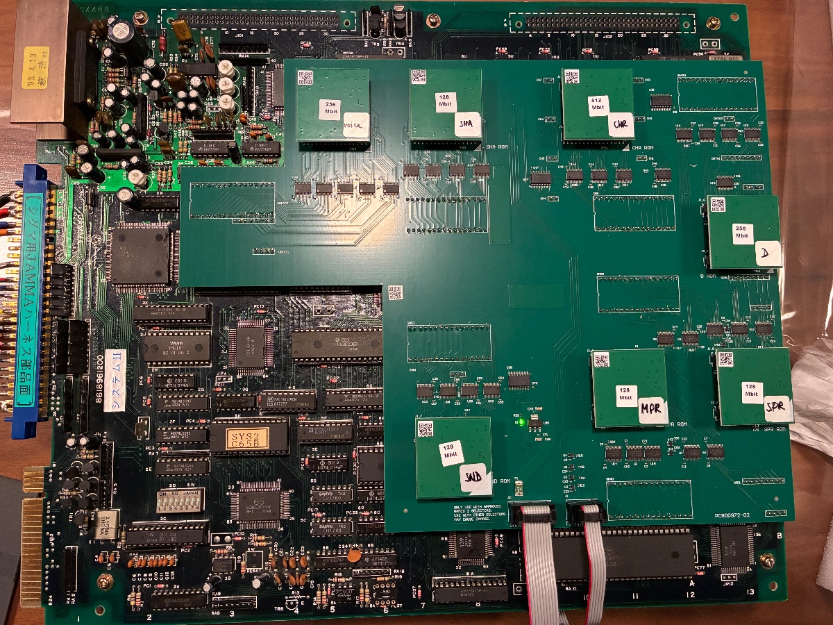

If your RAM is not socketed, be careful and patient when removing it.
The ground plane on this board is a massive bitch and the trivial removal of the 4 chips has been drama and still a WIP for me.
Good luck with you PCB, maybe @xodaraP or someone local can have a look for you.
Do you know exactly from what came the problem ?
No sorry I just know that the issue came from the video board, I need to investigate when I will have it back...

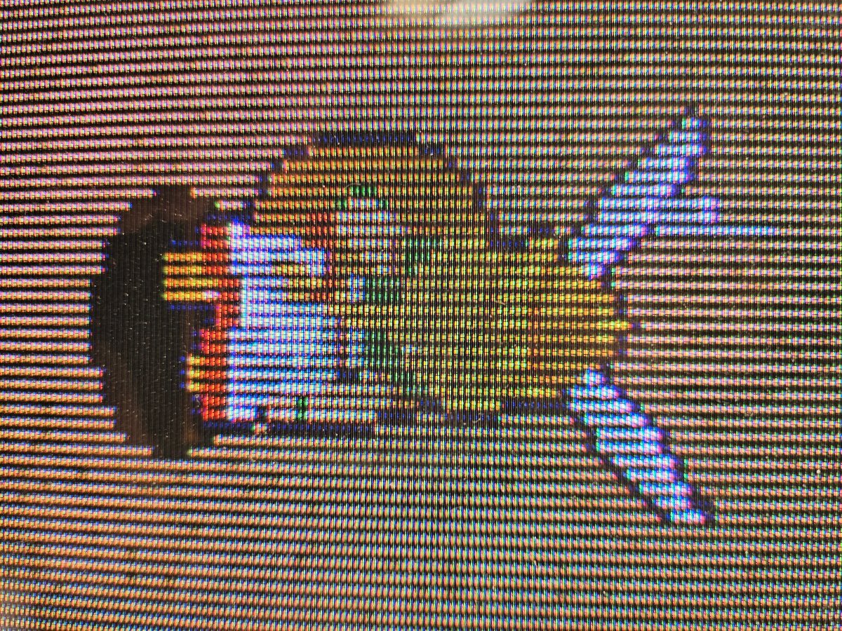

I have also another problem on Valkyrie when I want to use the special power when pressing the A button ( you need a cristal to avtivate it ).
You know when you make Mini Valkyrie around your sprites like options ...
( Please see pics attached)
The mini Valkyrie doesn't appears but this action take me a cristal, so it's like it 's working but no mini Valkyrie around my sprite very wierd.
I have the English translated version.
And the others special powers ( BIG and Tornado) works very fine.
Is there someone who have try Valkyrie english translated version and has the same issue ?
I need to try japanese version to check if this issue is still there ...
I have the same issue with this mini valkyrie special power as well. Mine is English version.

This is a hack. Does it happen with the Japanese version as well?
I have the same problem. Everything has worked fine with the Japanese ROM so far. It really seems to be to the hacked version.
