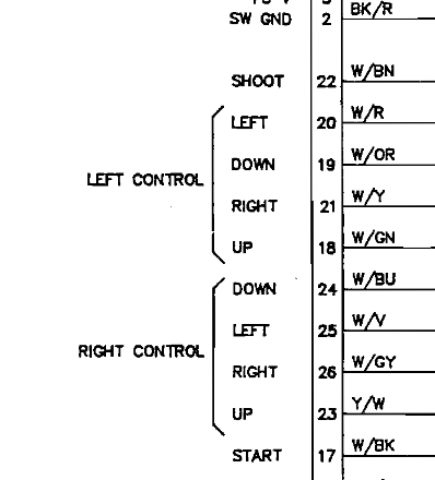

Can assault be played with two normal joysticks & 2 regular buttons?

How to play Assault with a panel of two regular joysticks and buttons ?

the jamma pinout is:
