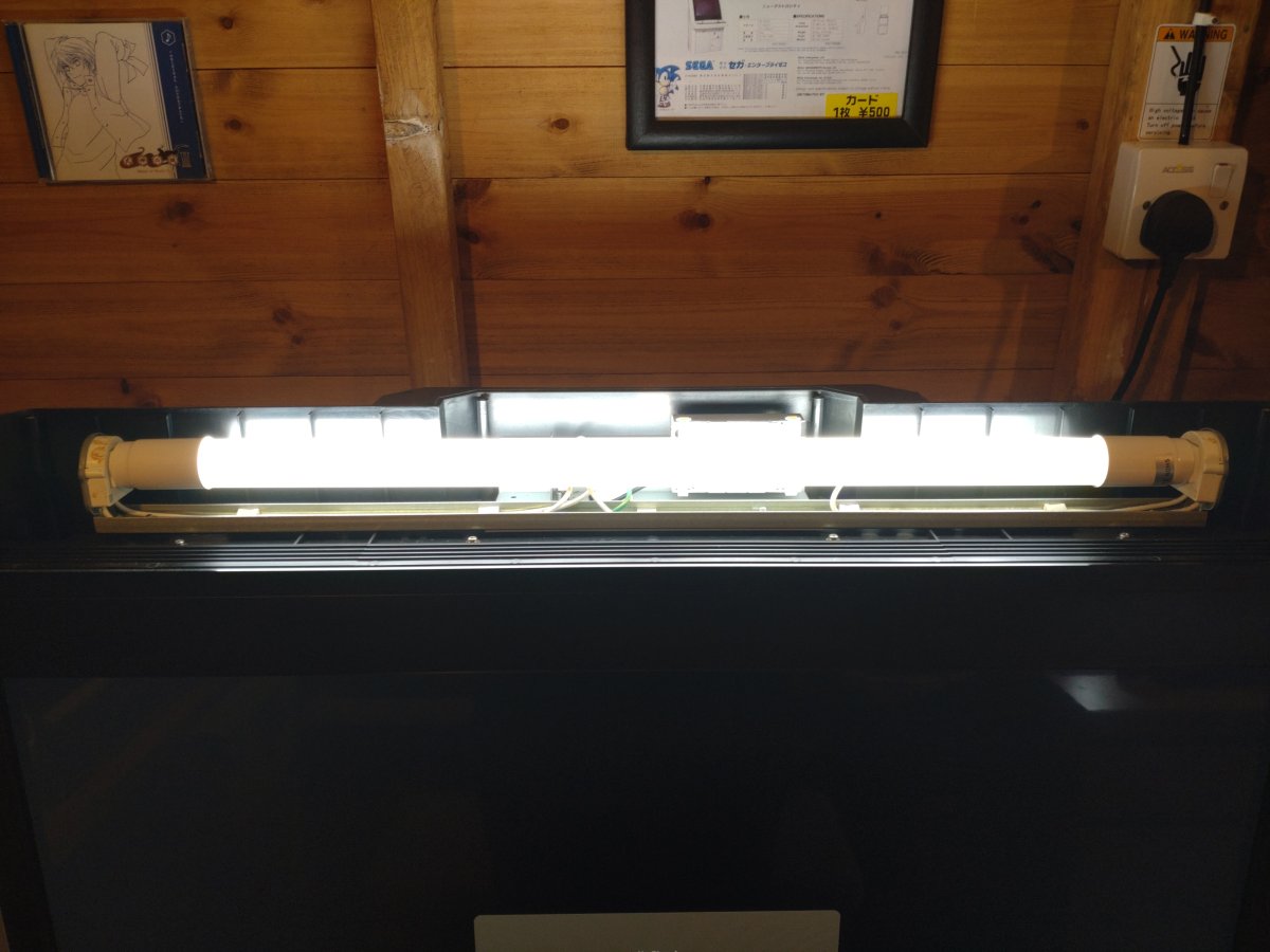

It's a tight fit in the Lindy too must be the same unit.
I've not used it yet though just test fitted it as I will wait for my flo tube to die before using the led replacement.
I think I did try it with the starter in place which caused it to flicker every know & then so I guess you need to remove the starter for it to fully work.

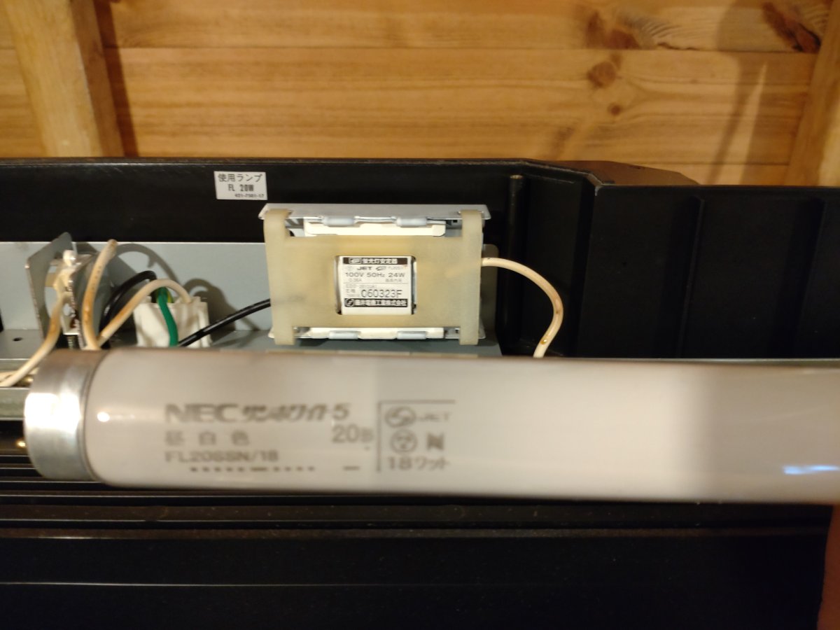

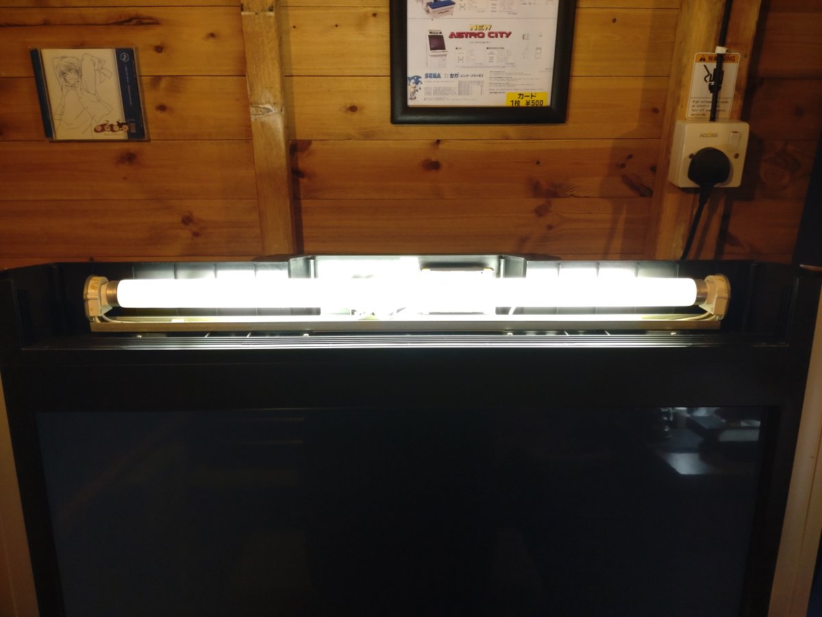

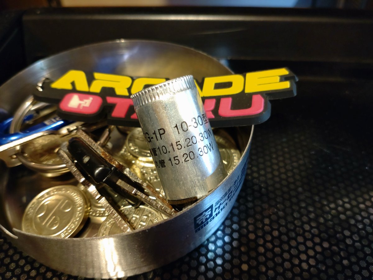

This thread has inspired me to get the led tube in my Lindy as now I know why it was flickering so today I did so the flo tube must of been oem as it has the same mark of "Jet" on it as per the ballast.
Never seen a metal starter before either must be a Japan thing.

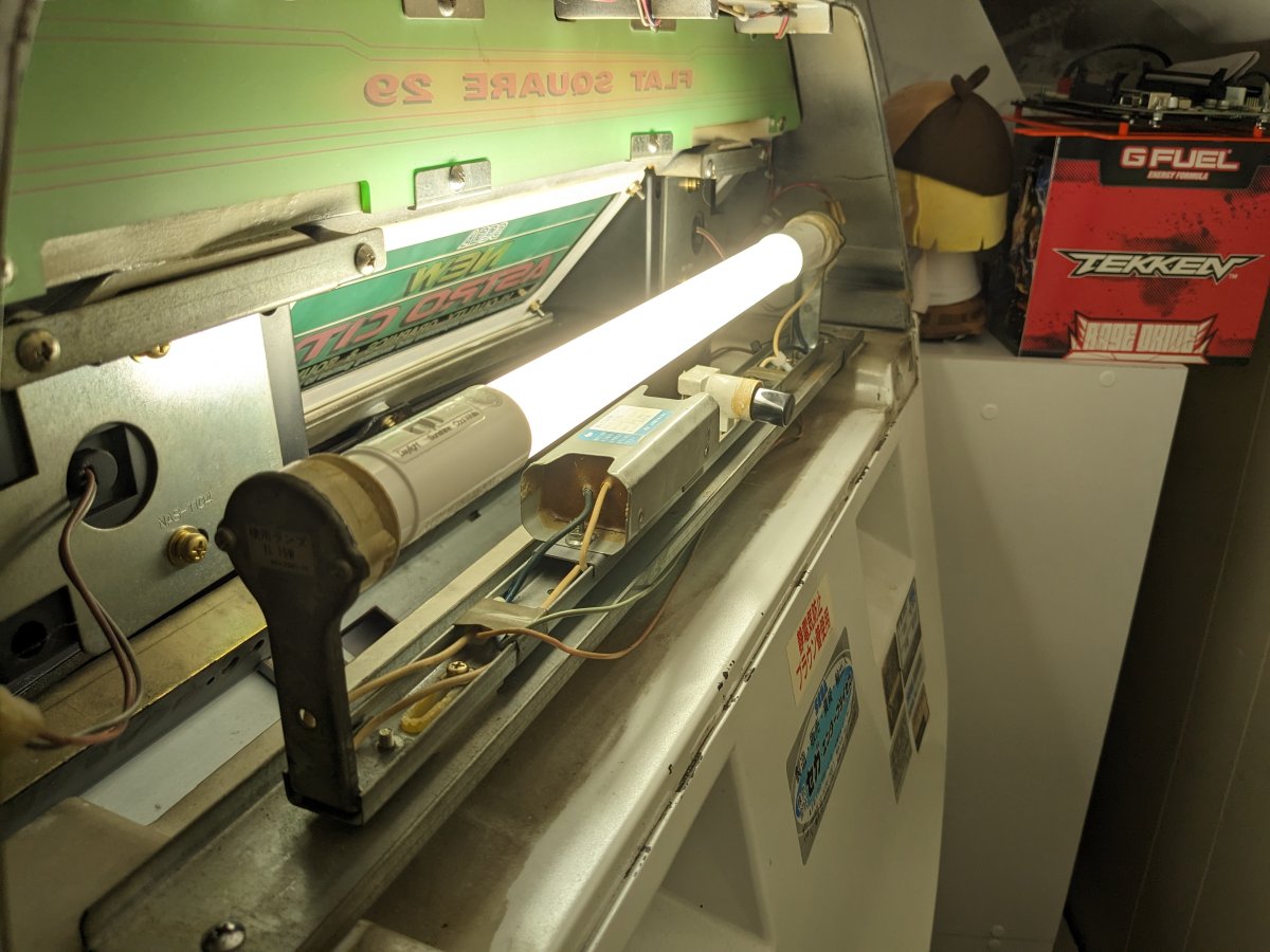

I picked up drop in GE bulbs as that's what they had at my local Lowe's. The 18" worked perfectly in my New Astro with a magnetic ballast (even though it says electronic only). 18" also fit in my Ok Baby (it has a whole replacement fixture with an electronic ballast). I read online that the Blast City is 18" but in mine it was a 24" T12. Luckily I picked up one of those too, though now I'll have to go back for another one for the New Net City. They have selectable color temperature as well.
PXL_20230808_224341897.jpg PXL_20230808_225259775.jpg PXL_20230808_224851248.jpg PXL_20230808_224841798.jpg
PXL_20230808_225632604.jpg PXL_20230808_230352936.jpg PXL_20230808_230330127.jpg PXL_20230808_230308139.jpg
