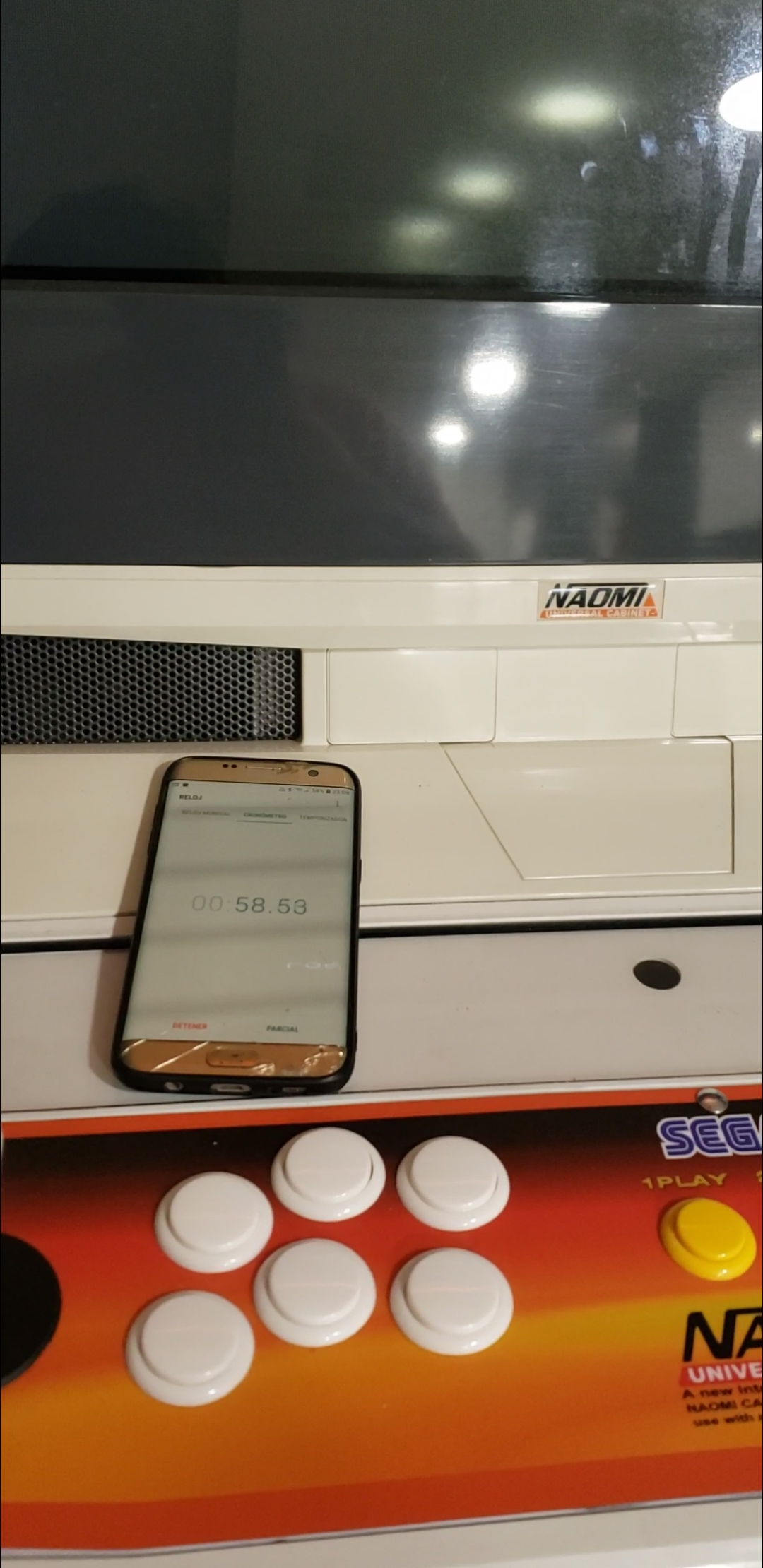

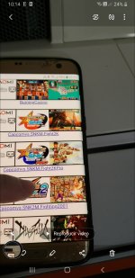

If you want to upload the scripts WiPi uses I can take a look
Hi, I don't know what happened here in this topic.. just wanted to say thanks for this fix, it improves the loading of the game to 1 minute.
I have manually modified the write_web.py and triforcetools.py as mentioned in the initial part of this feed.
I have tested on a Naomi 1 setup, and its awesome..
Thanks
