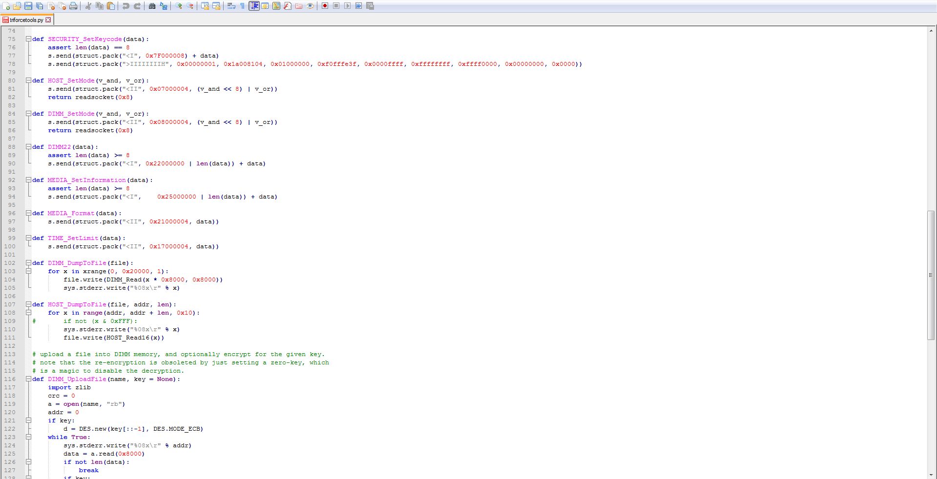

I try many things, let or comment out the line "s.send(struct.pack("<I", 0x7F000008) + data)".
I suppose I copy correctly and still verify the line(s) before/after added it, I have the same tabs/spaces too.
Here is an exemple.

I tested different ways but it doesn't work for me...
I have a Pi 2 with a LCD screen (from the member Squallrs, I bought it on another forum) and I have the same "structure" as opt2not :
def SECURITY_SetKeycode(data):
assert len(data) == 8
I try to comment out/delete/let the line "s.send(struct.pack("<I", 0x7F000008) + data)" before adding this one "s.send(struct.pack(">IIIIIIIIH", 0x00000001, 0x1a008104, 0x01000000, 0xf0fffe3f, 0x0000ffff, 0xffffffff, 0xffff0000, 0x00000000, 0x0000))" but nothing happens, the LCD screen doesn't light up, so I can't do anything.
Any idea?
Thx!
PS : for the Pi from Squallrs, no need to have a Zero-key, everything comes from python (that's what the creator said to me)
@rtw The code does work without a security pic, as I've never had one and it works for me. That was why I was slightly concerned with commenting that set security line out though, and reccomend it's just left in place.
@Amos I can see there is something wrong with your tabs / spaces. In your editor on the left there are lines drawn from the start to the end of the function. On the set security key code function, there are lines drawn from the start of the function to the last 2 lines in the function. This to me looks like you've tabbed / spaced them incorrectly. Play around with it until you can get it to draw only a line from the start of the function, to the end like the rest of the functions have.
You're right, it works! Thx :) (it was logical and I missed it...)

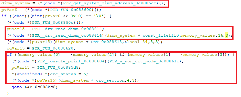

I know, holy thread necro and all that, but I've been apparently wasting my time reverse-engineering the 3.17 firmware since there was no (to my ability to find) public information on any of this stuff. That's over here: https://www.arcade-projects.com/threads/netboot-naomi-with-eeprom-presets.18977/page-2
I am replying since I can explain basically every part of that command, so hopefully for the curious I can demystify why it does what it does and what's actually going on. Okay, so, the bytes are as such:
Code:

Okay cool, so this is how that packet works. But why that particular address? What makes it so special. For that, lets go to 3.17 firmware reverse engineering. In the bootup state machine we find this:
I've renamed a lot of stuff from disassembly garbage names to make the code more clear. The top circled bit looks up the base dimm address. The second chunk of code calls the vxWorks DIMM read driver function with the address base + 0xfffefff0 (simply 0xfffefff0 from the send to dimm/receive from dimm packet's perspective). Remember how I said that was mirrored. That's the same address as 0x3ffefff0. Okay cool. It reads 16 bytes into the "memory values" buffer which is set currently to 4 32-bit values. Then, the critical bit of code compares the first 32-bit value to the bitwise inverse of the 3rd, and the 2nd 32-bit value to the bitwise inverse of the 4th. If they match, then it prints "non crc mode" to the debug console serial and sets the system CRC status to 5. Otherwise it goes on to CRC the data that is in the DIMM.
Side node, the CRC status is retrievable using a "read from dimm" command to another system memory location "0xfffeffe0". You can read it with the "read from dimm" command 0x05. It has the following values: 0 or 1 - we have not finished checking CRC. The system will be displaying "NOW CHECKING" on the screen. 2 - CRC is good, game should boot, 3 - CRC is bad, don't boot, 4 - Your DIMM memory has something wrong with it, 5 - CRC checking is disabled, we will boot without checking.
