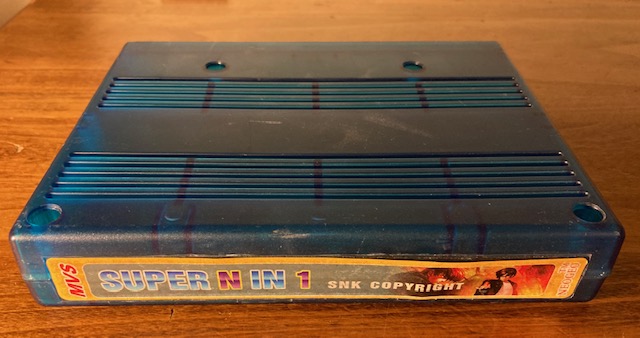

I prefer to ship Priority for reliability, speed and tracking, so expect roughly $9 on an individual board and $15 on shipping both boards in one box. If you take both, I'll include a Super N in 1 (120 in 1) Neo Geo multicart that was included in the sale of the first board (tested on my supergun and working). To make life easy, I'm limiting shipping to within the continental US.

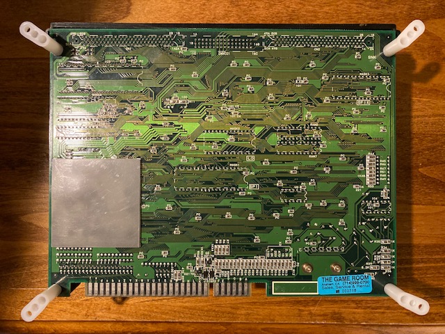

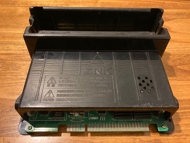

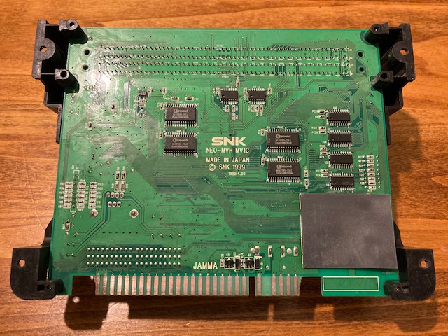

Here are some quick and dirty photos of the units:

MV1FZ - Wouldn't boot with or without a cartridge inserted. Flexing the board revealed that it does boot, but only when pressure is applied to the LSPC2-A2. Reflowed LSPC2-A2 now it boots to BIOS and boots cartridges. Next problem was no audio just buzzing and static. Cleaned and adjusted volume pot, audio is back, but the pot still has a deadzone even after cleaning with DeOxit. I'm going to swap the pot later this evening and with that, this board should be 100%
MV1C - Main fuse was blown. Checked for shorts on the 5v rail. No problems found so I replaced the fuse and tested. It fired right up and boots to BIOS and cartridges. The Jamma edge is cracked on both sides, which makes it possible to insert it into a JAMMA harness with 5v shorted to GND, which is probably how the fuse was blown originally. This board is probably a good candidate for consolization due to this problem, otherwise great care needs to be taken when plugging this board in.
