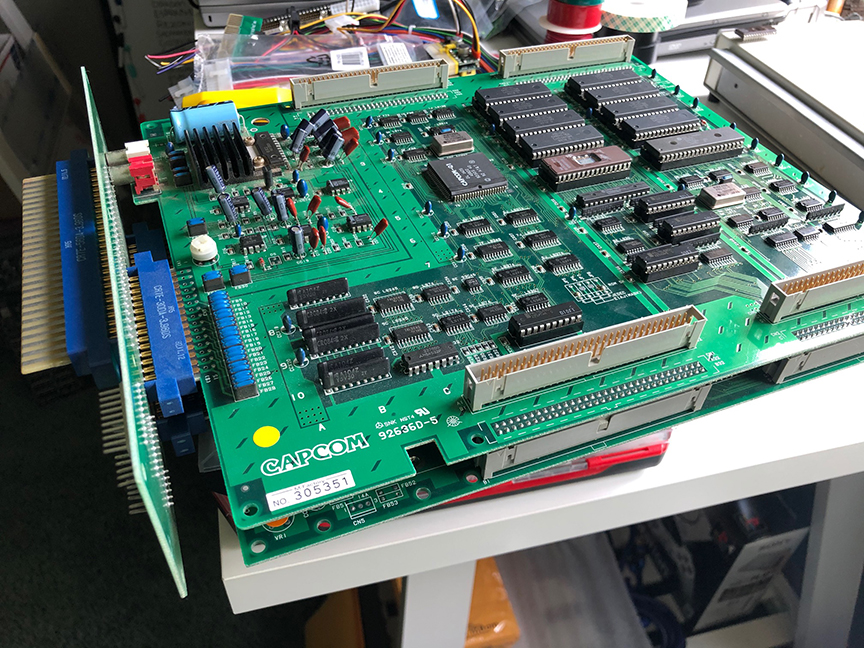

I have had this back in the day when I was buying Punishers and the rest for $25-50. Not sure what ever happened to the rom board, but can anything be done with this?
You can convert any CPS1.0 4MB MASK-ROM TYPE B-board (SF2:CE/TE) to be used in a CPS1.5 stack.
Use the version of the ROMs decrypted/patched for keyless B21 C-board operation.
Thats a Captain Commando conversion, also build on 4MB Mask type with B21 C-board.
If you pick up one of the battery backed CPS1 B&C boards like Capcom World 2, or Varth, etc. You can use ArcadeHacker's Kabuki and C-Board revive tools along with some new ROMs to make that any Q-Sound game you'd like.

So it HAS to be a B-21 B/C board game? I think I tried plugging in a CPS1 conversion made from a World Warrior with a B-17 and the game worked, but I didn't have audio. Is that because it has to be a B-21 w/ a battery? When you say use "Arcadehackers kabuki", do you mean the kabuki chip that is on CPS1.5 boards? I have a pile of those unless your talking something different.
No.
CPS1.5 games use Q-Sound audio, CPS1 games have ADPCM audio, If you play a Q-Sound game on a CPS1 you get no audio, if you play a CPS1 game on a CPS1.5 board you get no audio.
B-21 is essentially a graphics chip, it has nothing to do with why you had no audio. Rather your "converted" game was designed for ADPCM audio and you're trying to run it on a Q-Sound board set.
Kabuki Z80 chips lose their programming when the battery dies or the chip is removed from the PCB just like CPS2. And just like with CPS2 Arcade Hacker made a tool to "revive" them once that happens. Similarly battery-backed C-Board lose their programming when the battery dies, and just like CPS2 Arcade Hacker made a tool to revive those too.
This is relevant because... just like CPS2... different games have different different programming depending on the game, so if you want to swap to another game you need to swap that programming, if you want to use the original encrypted code.
None of this is useful for the multi, but it is useful if you want to use those parts to put together a Q-Sound game.
