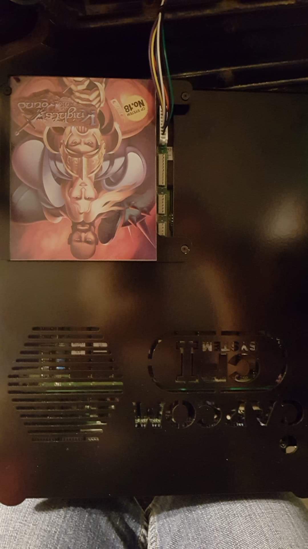

That is the version to buy, and I'll show you why with one single image.
The size of the access hole in @Escarioth 's case will likely be an issue for the fixed/solid version.
The wire/header version will plug right in and extend outside the case.
Hmm. I could make the big square hole a bit bigger if needed.

I bough one from jnx years ago.... I could simply do i check right away :)
Edit: oh, it was a midway to cps1 with wires. So i cant test it. Sorry :( but no problem so far, the new version will have the hole just bit bigger for easier removing
Look I intentionally withheld that information from you when I was advising about the holes for the C-board.
For the simple reason I don't want the hole any bigger than it currently is, and not only that...
But I want the kick connector closer to where the JAMMA edge will be.
If you use that fixed/solid version of the adapter, its too far away from the JAMMA edge and that is a problem for HAS/Jammafier/Kick Harness Special Edition JAMMA Extender.
You would need a special, very long corded version of the 6-pin kick connector and that defeats the entire point of using the fixed adapter...
Also no one sells such a thing currently, so you are on your own to crimp it.
Please don't support it, go ahead with the design as-is... It's a rabbit hole that is going to open up more issues (I've already considered them trust) if you fall down it.

Thats ok @jassin000
I wanted to check, but in the end it would be better like it is right now. Dont worry i was just curious to see.
Anyway, if its really bothersome you can always unscrew the plate when needed
