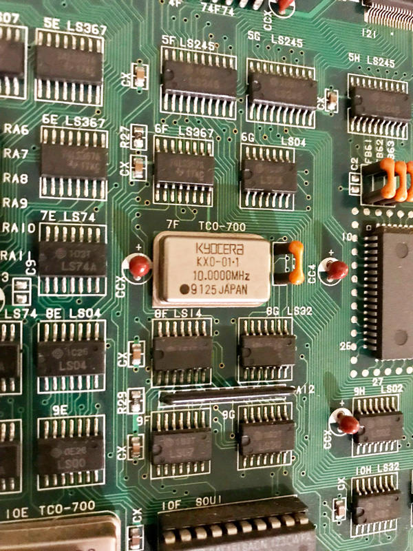

The C board hasn't yet been confirmed. The only thing confirmed at this stage is that you need an A board running 12mhz. Can be any A board but if 10mhz it needs the crystal swapped.
How do you identify that your board is running a 12mhz??
all cps1 games will run on 10mhz or 12mhz. 12mhz improves performance slighlty on same games amd was the standard for sf2ce, sf2hf, pang 3 (and i think one other game?). It is the safe bet for all games. If theres something to it, i'm interested to know more.
To determine what oscillator your board has, the easiest way is to look at it. It is around the middle of the A board and is clearly labeled. It is a metal rectangular component and will say 10 mhz or 12 mhz right on it

Also worth noting is that a simple crystal transplant will convert your 10mhz to a 12mhz (dash) board.
It's a really simple process with just 4 points to desolder/solder. The crystals are extremely cheap too. There's no need to be particularly concerned with what CPS-1 "A" board you have. Obviously just try to get a nice clean one that functions fine.

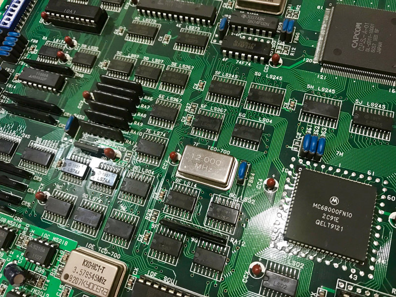

Upgrading a 10MHz PCB to 12MHz
According to Apocalypse even if you do have a 10MHz board it can be upgraded to a 12MHz by replacing the crystal: Interest Check: Darksoft CPS1 Multi - Unofficial
Most games should work on either board, there will just be more slow-downs on the 10MHz variants.
This image shows where this crystal is located.
I'm having difficulty reading what the chip says in that picture. Does anyone know which part you would need to buy to make a 12MHz cystal upgrade? Thanks in advance.
I did this upgrade a couple years ago for myself and a few other forum members:
http://the-artcade.blogspot.com/2018/06/cps1-dash-kick-harness-upgrade.html
This is the one I bought for the upgrade:
https://www.ebay.com/itm/12MHz-Xtal...e=STRK:MEBIDX:IT&_trksid=p2057872.m2749.l2649
@mthngn Those images you posted are actually from my blog. The 12mhz crystal shown in those pictures is not the original CPS1 crystal. That is the upgraded one I linked in my previous post.
For determining if your board has a 12mhz crystal, you can either look at it directly on your board by removing the B-board attached... or there may be a "DASH" sticker attached near the JAMMA edge on your board. That also indicates it's a 12mhz version.
