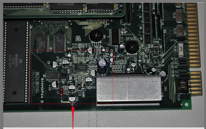

Can anyone supply a real close-up pic of the section I have boxed in red? I have a trace from a chip that was suspect, but if I can get a good close up to see the tracks I can make sure I am good.
