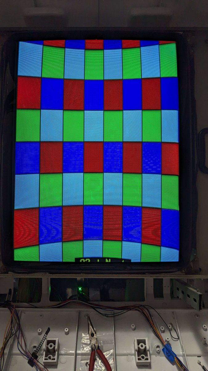

  • Horizontal Width Pot - barely shrinks picture, still goes over the edges
  • Pincushion Pot - doesn't seem to have any effect on picture
  • Image - some curving on the sides which i could not adjust out

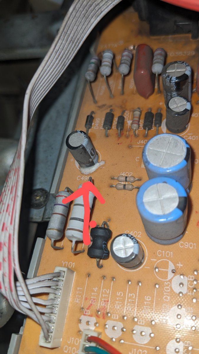

This morning, I reoriented the monitor from vertical back to horizontal. Plugged it back in, and turned on the cab. "BBBBZZZZTTT" some brief light came from the back of the cab and when I poked my head in to look I see a capacitor dispensing some tasty foam:
Should I just order a new board and give it a shot? Something like this: AliExpress CRT Chassis

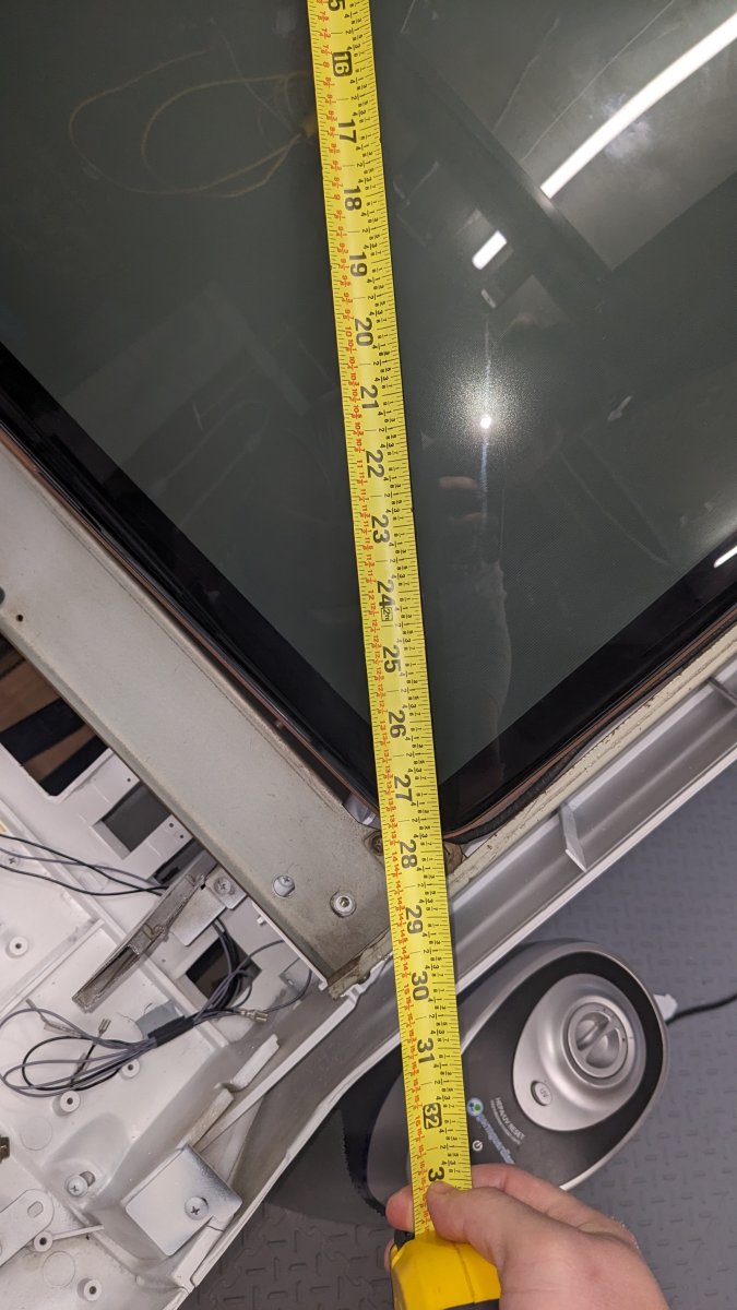

I could also use help determining size to order, is this a 27? 29 inch? Sticker on the side of the cab says it does 28" or 29"

Take a pic of the tube sticker on the back of the CRT. Should have a manufacturer listed (i.e., toshiba, hitachi, etc.) and list a model for the tube (i.e., A68xxxx or A66xxxx). That should confirm your size.
I saw on your other thread that this is a A68 tube. That means you have a 27"/29" monitor. As for your horizontal size issue. There is are two jumpers next to the width coil that corresponds to one being "narrow" and the other being "wide". Try swapping the plug to the vacant header and see if that decreases your size.

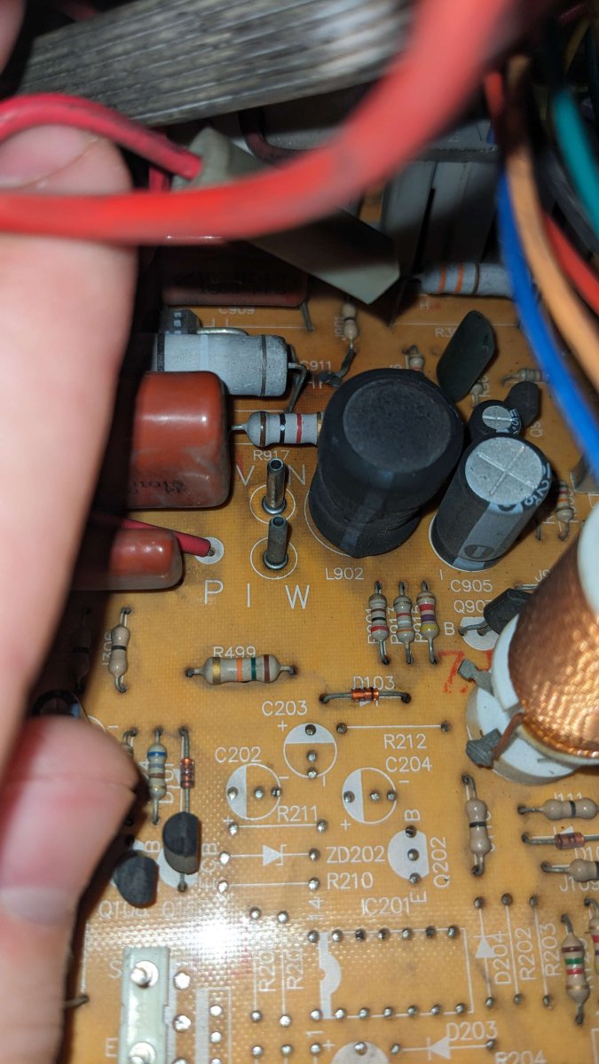

Sidenote does that big cap look funny at L902? Tried swabbing the top with alcohol its just permanantly black.

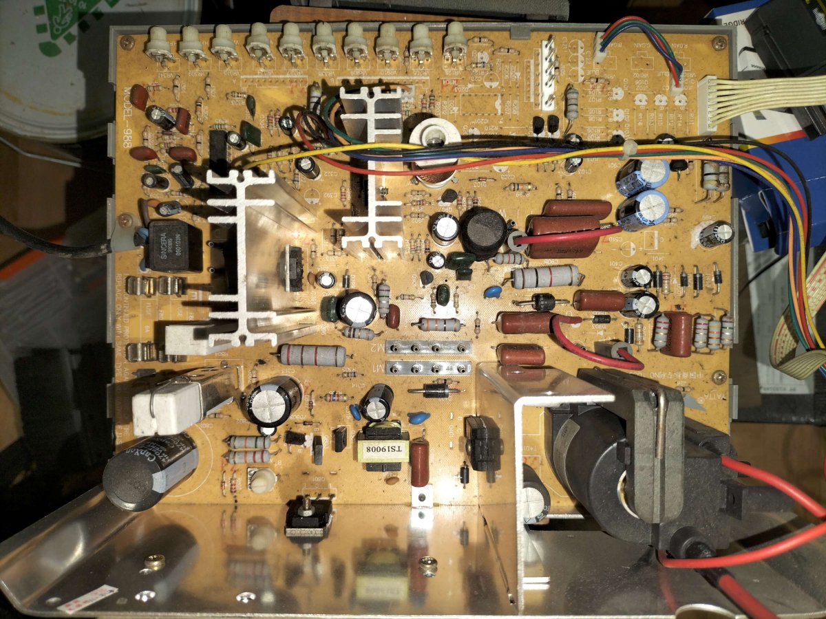

I actually grabbed this pic from a different OK Baby thread, but its the exact same board.

So the capacitor came in for the horizontal pot and I wanted to share some pics of the board for some opinions:

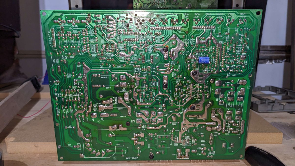

  • Bottom of chassis:

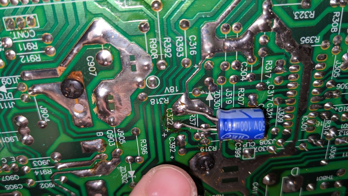

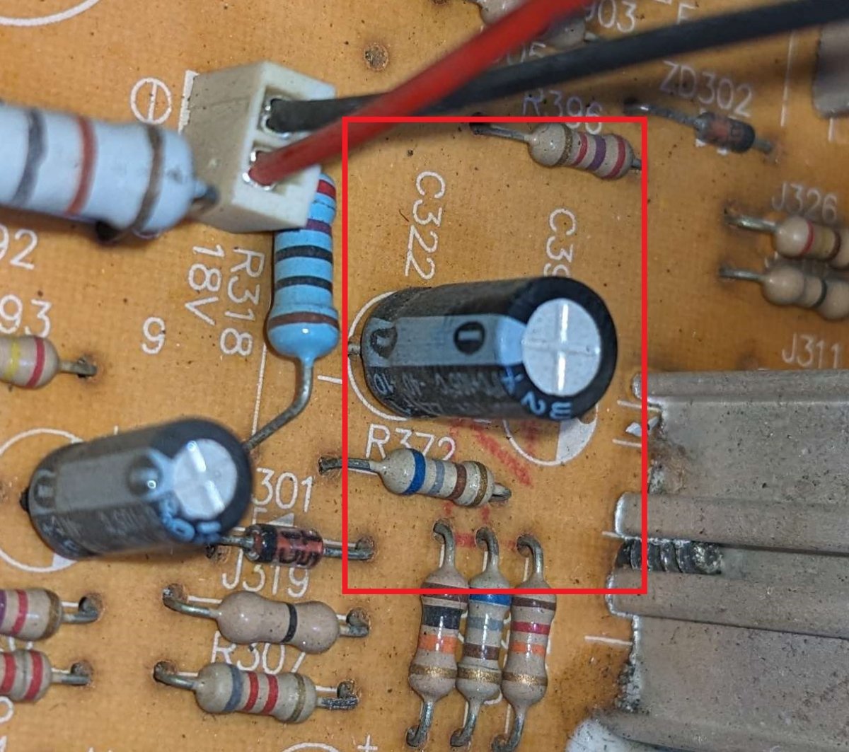

  • This jumped out at me, should that blue capacitor be here on the bottom side??? (100uF v50)
  • Topside to that blue one, at C322 is this capacitor: (220uF v16)

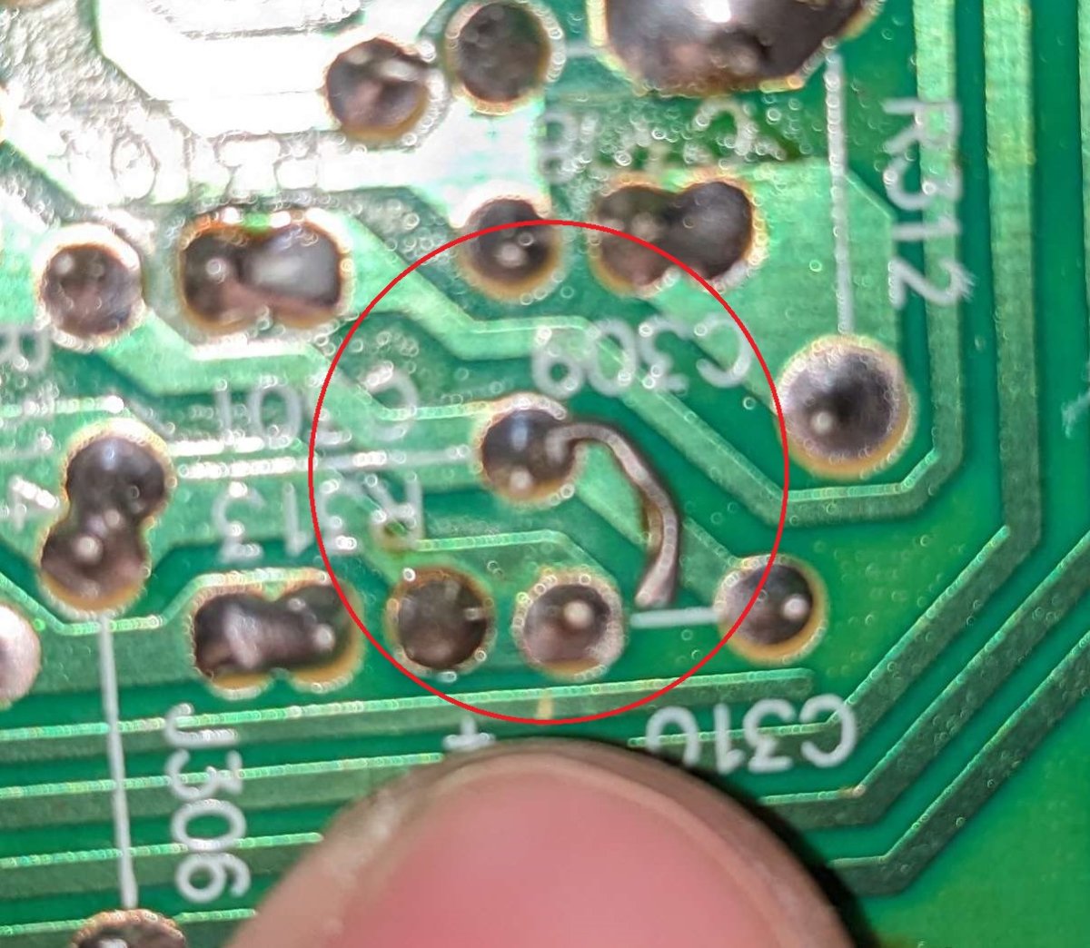

  • Also noticed this, should I trim it off or just leave it?

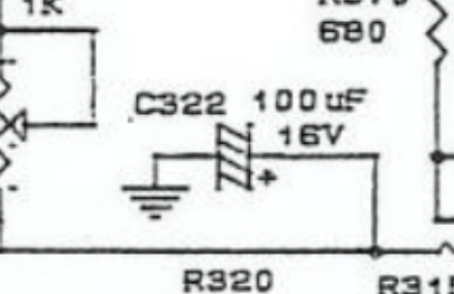

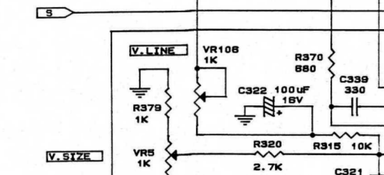

So that first link I reviewed 4 times, don't see a C322, this site here doesn't list a C322 for that model: http://macros-arcade.com/monitor-capacitor-kit-listings/
The 825HR & 826HR have C322 as 100uF 16v :
Neither match the out of box capacitor, but 16v is consistent between the Wei ya and the stock capacitor. So that leaves me with a 220 or 100uf v16 as the correct choice.

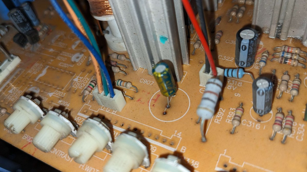

Decided to go ahead with the one cap here (C907) for the horizontal width and pincushion:
Horizontal width, positioning and pincushion all work now! Picture is much better.
I should probably go ahead and get that other mystery cap off the bottom and replace the C322 cap. I'm going to look at some comparable chassis and see what I can find that has a similar capacitor list and order a kit.
Consider this one solved everyone! Thank you so much for the help!

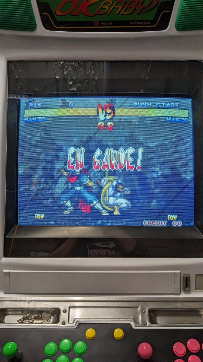

(flyback was up to high on screen dial when I took pic, but you get the idea)

P.S. I did order a isolation transformer to add to the power supply setup and I will remove the mystery capacitor from the solder side of the chassis in the future when I replace multiple caps.
