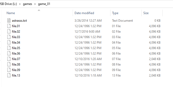

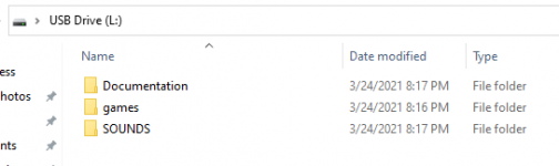

I have cleaned the contacts on the cart and on the board. I formatted the SD card with FAT32 in Windows 10 - full format. The file structure is exactly as downloaded from this forum.

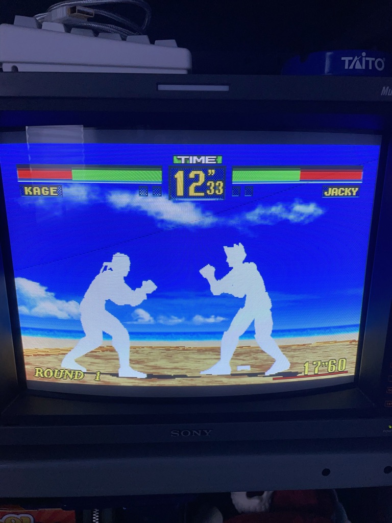

Has anyone else experienced this before? Virtua Fighter was working perfectly for me before. Darksoft STV cartridge, I've formatted it and re-loaded the rollup pack on SD card, same results. All other games work as expected, so its only affecting Virtua Fighter and only the character models.
I need help with this please.

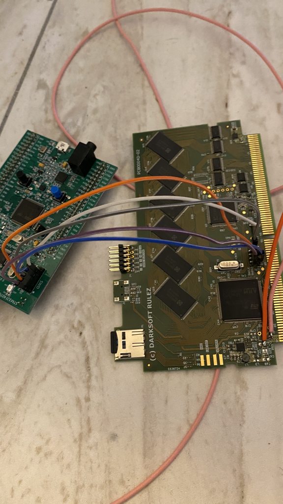

Trying to update a first revision ST-V multicart.
I'm trying to flash it using the STM32F4DISCOVERY hardware, but i always get error.
I use the same pinout found in the CPS2 multi instructions, but i always get connection error.
STV PIN 1 --> SWD PIN 4
STV PIN 2 --> SWD PIN 1
STV PIN 3 --> SWD PIN 2
STV PIN 8 --> SWD PIN3
STV RESET --> SWD PIN 5
Of course i power the stv cart with 5v, then i attach the STM32 via usb to my laptop, the STM32 starts to blink but if i try to connect always get error.

No that pinout is not correct. Check the PDF in this post: https://www.arcade-projects.com/thr...microsd-support-and-autoreset-please-try.808/
You need only 3 pins.:
DISCOVERY SWD Connector | Cartrige debug connector
DISCOVERY SWD Connector Pin 2 - Cartrige debug connector Pin 2 (SWCLK)
DISCOVERY SWD Connector Pin 3 - Cartrige debug connector Pin 8 (GND)
DISCOVERY SWD Connector Pin 4 - Cartrige debug connector Pin 1 (SWDIO)
No that pinout is not correct. Check here: https://www.arcade-projects.com/thr...microsd-support-and-autoreset-please-try.808/
2 - SWCLK ( 2 )
3 - GND ( 8 )
4 - SWDIO ( 1 )
It won't work that way too.
That's the first thing i tried, to follow the STV procedure, then i read into this post and this other NEW FIRMWARE!!!!! WITH AUTO-BOOT IMPROVED MICROSD SUPPORT AND AUTORESET. PLEASE TRY | Arcade-Projects Forums (arcade-projects.com) to discover that you need to use the CPS2 guide to program it, so i did.
Thanks.
I see that the orange pin was connected on pin 4 of the STV instead of 3.
Now i manage to have it connected.
I also program it (i think rightly) (i use the bin inside this one http://www.mediafire.com/download/e56qgvt7j77o7f5/STV_Ultimo_Firmware_con_Autoreset_yAutoboot.rar)

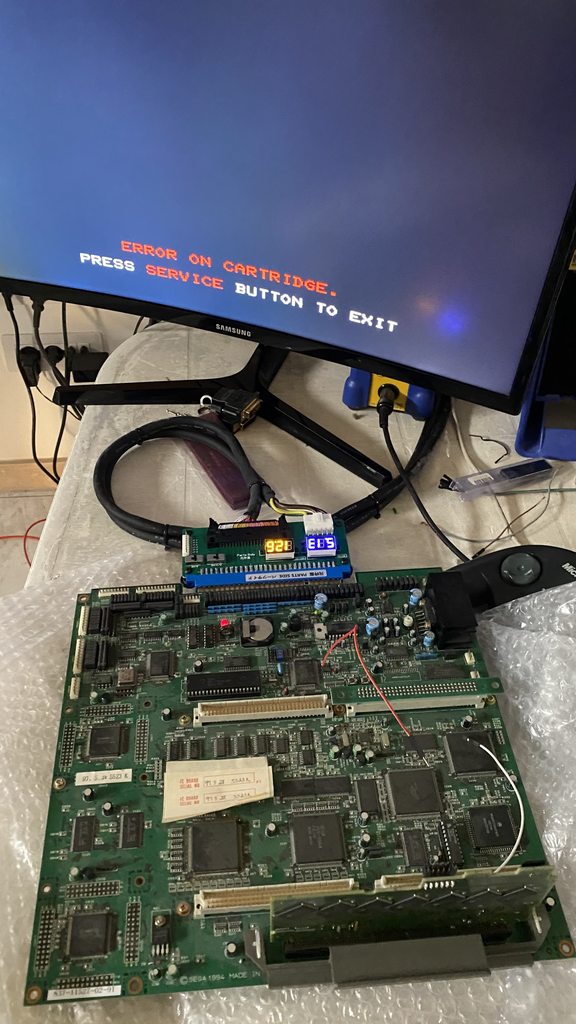

Now i'm trying to have it connected to the stv but i always got cartridge error.
I double checked my connections and all seems to be ok.
Maybe i need to put something related to the cartride bios inside the microsd too?
Cartridge Error can be if no game is loaded in the flashes or if you have the game put into a different configuration in the service menu.

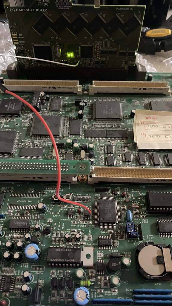

I was using the lcd selector, now i also tried with only the reset wire and the jumpers, only.
But when i put the reset wire from the stv into the multicart, i only get no signal from my OSSC (this only happens with reset wire connected).
I only have both leds on but nothing more happen....also if i shutdown and restart the stv manually after 1 minute for example, i got cartridge error (this if the reset wire is not connected, otherwise i have blank screen only).

Here is when i power the stv.
View: https://youtu.be/CT4EEB0c7u8
Could be possible that the flash with the STM has gone incorrectly?
When i power it up after the flash (with the flash.img inside the microsd card) it flashed for some time and then only give me two blinks...so accordingly to the guide, it should be correct i think.
Any hints?
I would say that it's a problem with the motherboard or a bad contact between cart and mobo.
That is normal. When a new game is written, the system is put in RESET to avoid any interference, reset loops, etc.
OK
Yes, that's normal. You have to wait until only one LED is lit, as explained in the instructions. Are you familiar with the load process of the cart?
