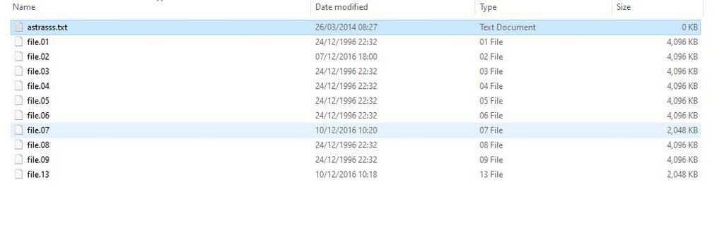

Here is my sd file structure
Here is inside the game_01 folder

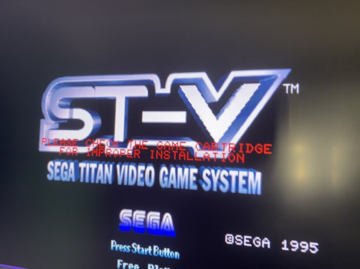

I tried to play it this passed weekend, and I was getting a Cartridge Installation Error, and wasn't able to boot up anything. It would get to the spinning STV logo screen and continue to tell me the cart is installed incorrectly.
I made sure my Game Assignments were set correctly, in this case I was trying to load up VF Remix which is a 2p game, so I put it on the 2p setting.
No change.

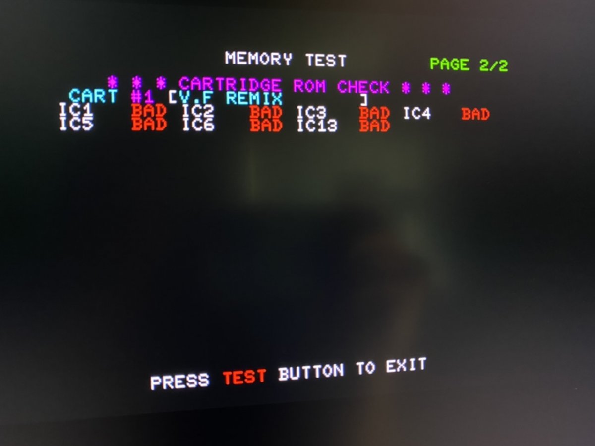

Then I thought maybe it's the motherboard, so I tried actual carts in it, 3 of them to be exact. All worked fine. I ALSO tried to put the Multi cart into spare STV mobo that I know works, and got the same Installation Error message and screen. So I know the cart is the issue.
Next I've tried multiple microSD cards, reformatting them multiple times. That changed something, now the cart doesn't give me an Installation Error, but now it goes to the System Checking screen briefly, then to a black screen and stays like that.
My bios is v1.11 and my Multicart is at v3.0C.
When doing a Ram Test the motherboard checks out all good, but the cart gives me Failed tests across the board.
It looks to me that this multicart is faulty, but from what? It just spontaneously decided to stop working after sitting on the shelf? Maybe I wasn’t giving it too much attention and it felt jealous of the other boards. 😂

How long are both lights on? Can you show a picture of how your sd card is set up?

If by powercycle you mean that I change the jumpers with the power off, then turn on to allow it a chance to flash the memory and then turn off and on again, then yes. Is what ive described correct?
