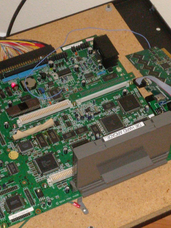

I'm having an issue with my multicart. It's showing game names (when it wants to) and sometimes loads them to white screens. See attached images. Anything I can try out? I don't have sound set up yet. IMG_20180622_190344.jpg
Here's some tidbits:
I just dropped the rollup pack games onto a FAT32 memory stick and put that in. The reset button, wiring, etc all seems to work and sometimes brings up the correct game (if it loads; otherwise just "ERROR ON CARTRIDGE") when its selected. The ONLY game that has worked and loaded so far is VF Remix, and that's sparingly. It's the only game with the white screen. OTherwise it'll go through the first black screen and never load the game (from how it appears).

@Darksoft I believe so, I switched back to Die Hard Arcade and it's booting up.
edit: take a look at this video and let me know if it helps at all diagnose the problem:
@Mitsurugi-w what do you think?
Die hard is one of the games that may work well with a bad board so I'm not sure.
OK - I sent you a PM Mitsu.
Now I'm only getting "Error on Cartridge". I got Cotton 2 to work last night for a long time no issues. Had sound and all, I have a video of that but I don't think it'd really help (doesn't show the board or anything). Once I tried to switch games, it went right back to the error screen. I switched out the save battery this morning since it looked eroded but it didn't do anything.
Sometimes when the error appears on screen, both lights will be on on the multicart. I reformatted & tested another SD card. Got the same result.
If both lights are on then a game is loading and it will give you a cartridge error until the game is loaded and the pcb is reset.
Everything's good now - the SD card was my issue. Games are loading and booting up no issues!! Thank you guys.
