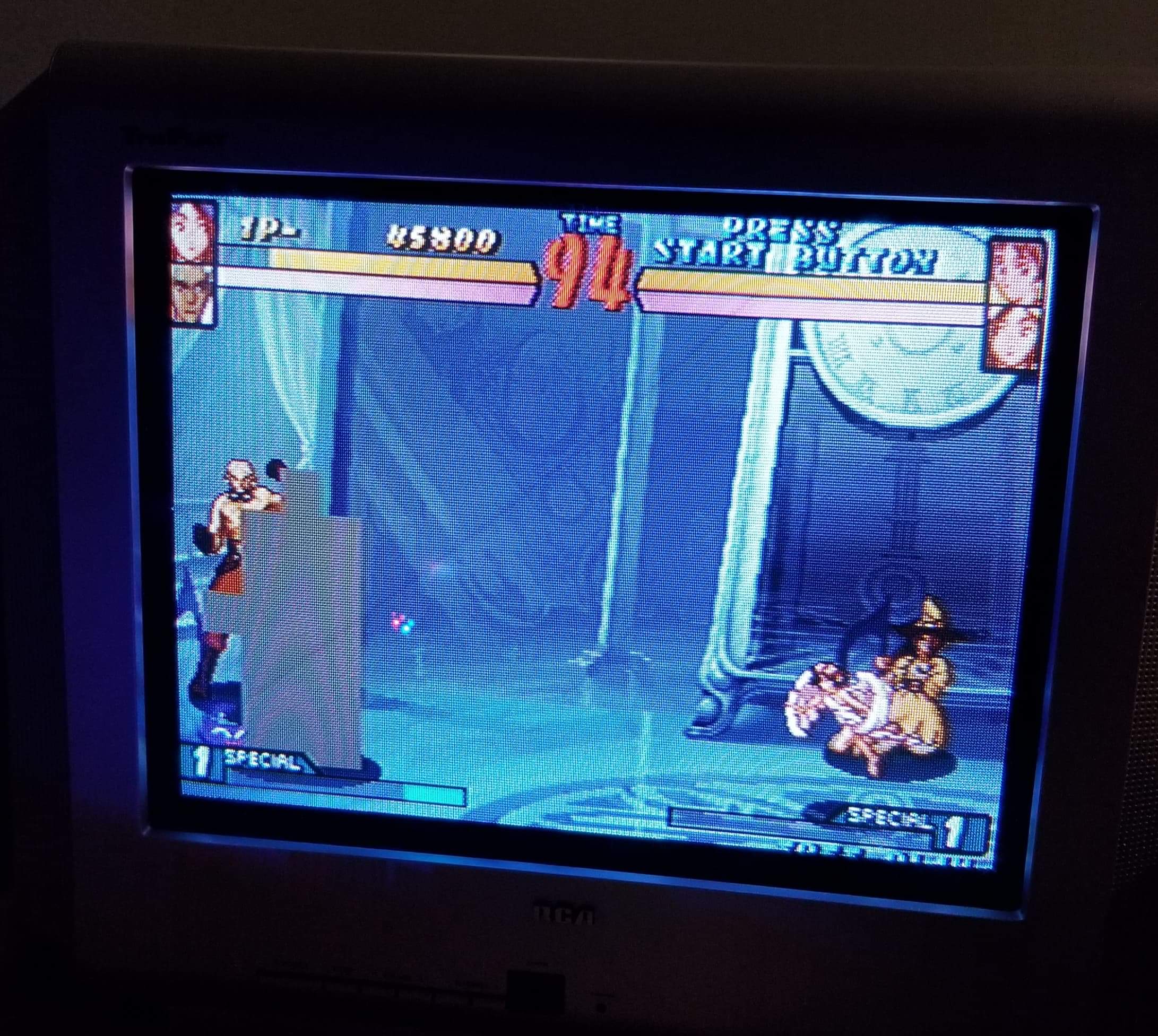

Any idea why sprites from this are missing?
Astra Super Stars does the same thing and all my memory checks read good. Could this be the same issue? I pressed down on all of my chips and nothing happened really.
This seems like you didn't wait for the flashing process to finish. Check the leds whenever you flash a new game :)
