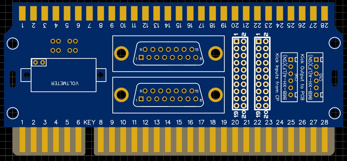

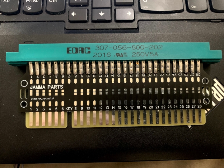

Sure. That device would just be a redesigned JAMMA Adapter that Frank already has laid out the groundwork for:
Now all that is needed is to modify the fingerboard, tapping the button signal paths to add two 2x10 headers & two DB15 connectors. So then you can the ability to connect whatever external controls you want to use while playing on an actual cab. Fighting game players are particular with their controls. Some are gamepad-only guys. Some have their own spit shined custom fight sticks. Some are hitbox guys. Some like US Happ controls that MAS sticks afford. I have a group of friends that are serious players. Tired of hearing those excuses for why they don't like to play on cabs. I'll tell them to bring over whatever controllers they like and let's get it on. No more excuses.
Here ya go, an early mock-up. I've thrown out the idea of using the fighting board footprint as it makes the adapter too big. But here it is. An inexpensive simple way to allow for external controls to be used in an arcade cab. No need for any hackery/wire slicing/tapping under the CP. Kick inputs for US JAMMA cabs that only have buttons pins for 1-3. Buttons 4 & 5 to the edge connector, while also outputting buttons 4-5-6 to a kick harness.
Between this and the using decoders (this project or undamned's), you pretty much cover all the standard ways fight game controls are wired up today. Now when dudes lose, they can't complain about the cab's sticks. And, you can take this anywhere the need arises.
Those footprints are too close together, the traces wont fit in between. It'll have to be even bigger :P
