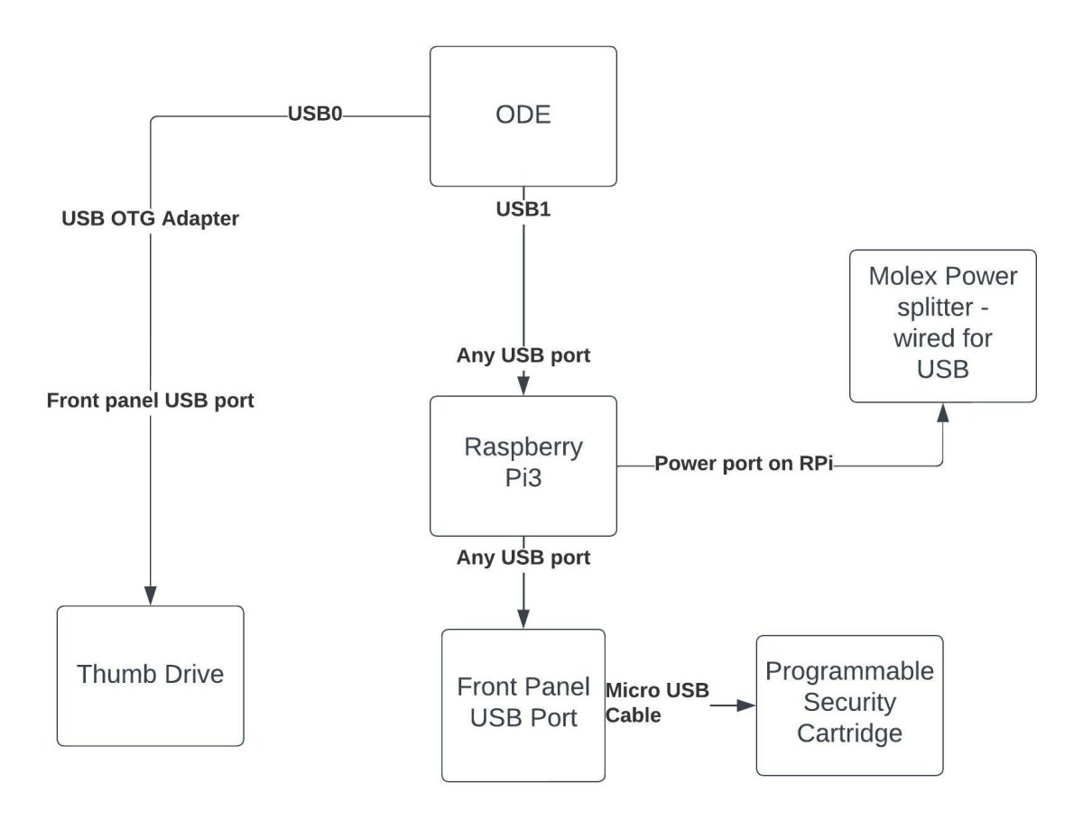

Here is a quick visual of where things plug in.
(fixed an error on 8/14 - this is the corrected version).

Thanks Matt- this is very helpful. Anyone know when the ODE will be available again? I've got everything ready to go apart from that :-)

I also realized I messed up on the picture - the usb thumbdrive plugs right into the front panel - no cable required - I will fix.
looking at your diagram , doesn't the Pi3 program the dongle , and the ODE has the thumb drive connected to it ?
i was wondering only as i am having issues with mine , it happily programs the dongle , but the games dont seem to load for me, or i can just have one game on thumb drive and it may load , but has issues if multiple games are on it
