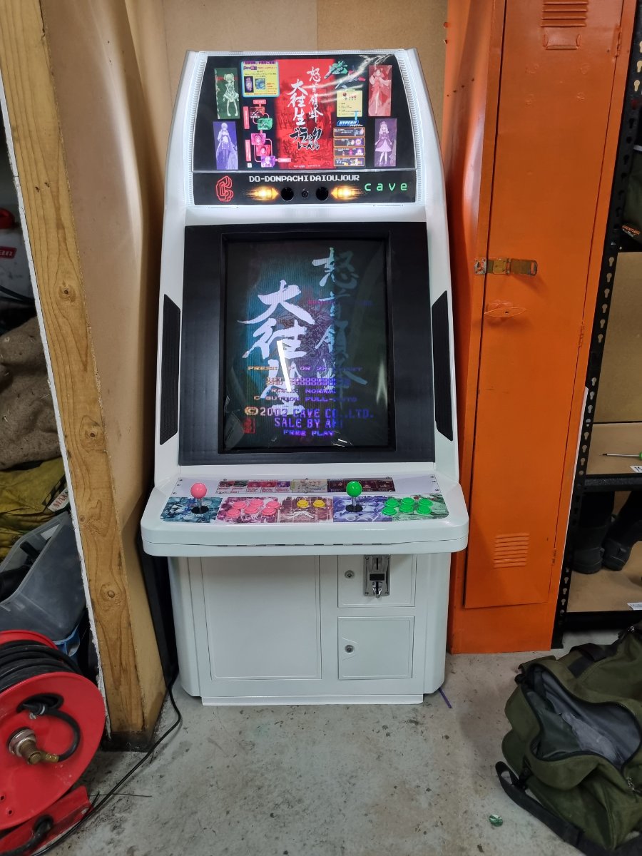

On another note, while tou have the shell off, would you be able to measure the distance between the original battery terminal pins and take a picture of the area for me? I'll try to get a battery blaster type replacement modelled up. My only PGM is in the Chandy at work.
