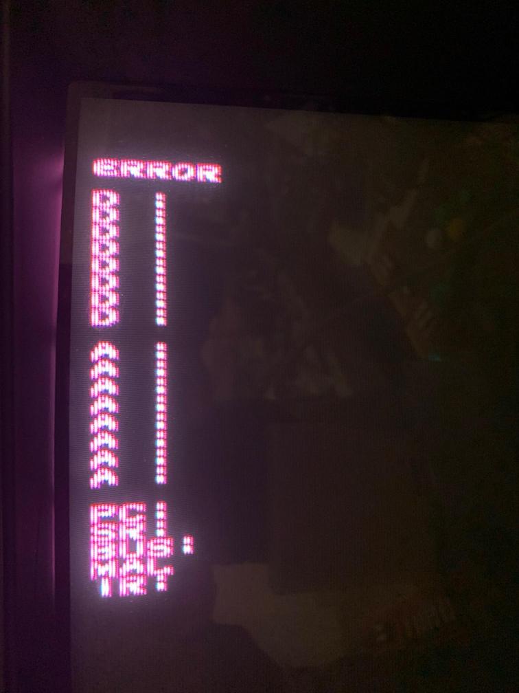

Hey guys!
I'm having a little problem with DDP3:
When booting with the "Version A - old" option, the game hangs with an error right after the legal screen. When I immediately throw in some coins and mash the start button, I can play the game though.
"Version B - new" strangely works absolutely fine.
I've tried ddp3_p1_dual and ddp3_p1_dual_qb and even built a completely new set of carts... No difference.
Has anyone else encountered this problem?
It’s a known bug? I can play this cart without issue. How do I reproduce it?
It's been awhile since I had the dual rom on but it was random. Sometime I get it sometime not. Even try clearing the nvram only way for me to get pass it was to coin up. Could be a mobo revision thing or bad eprom. I myself have not look further into it
