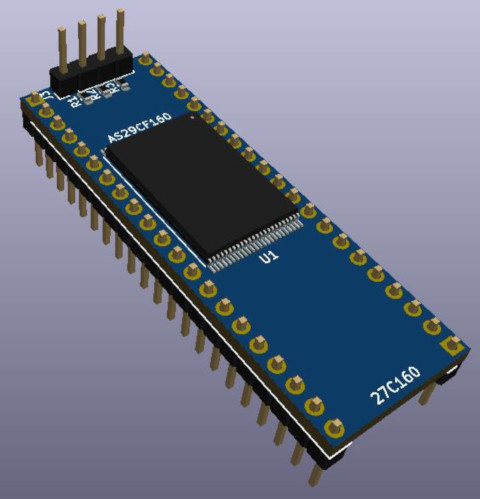

I had a little dig, and the biggest off-the-shelf 5V-compatible memory part I can find is AS29CF160B-55TIN. This would be enough for the program code (only half of the 27c322 is used), though would need an adapter, and I don't know if common programmers can write them...
I guess something like this would be possible:
Though I have no good plan how to program them... two of the AS29CF160 could be used in 8 bit mode to replace a 27C322, though routing this will be tight. Maybe I'll get a few made when I make my next order, or is anyone already making something similar?
why not install 2 of them on that PCB?
IIRC they made something like that for Neo Geo since it has 32Mbit 8-bit MaskROMs
alternatively you could use a 3.3V chip there and integrate a regulator and level shifters into the PCB as well.
EDIT here:
https://oshpark.com/shared_projects/2b7muPMc
https://oshpark.com/shared_projects/ep5d2RrF
I thought about that, but the 3.3V chips are only available as surface mount, which make programming and soldering more difficult for the average user. Though I don't mind if anyone develops a surface mount/3.3V version, all PCBs I sold contain all required information to replicate them.
It could look similar to the Lydz board, just with level shifters like the NGDevTeam NeoGeo carts.
